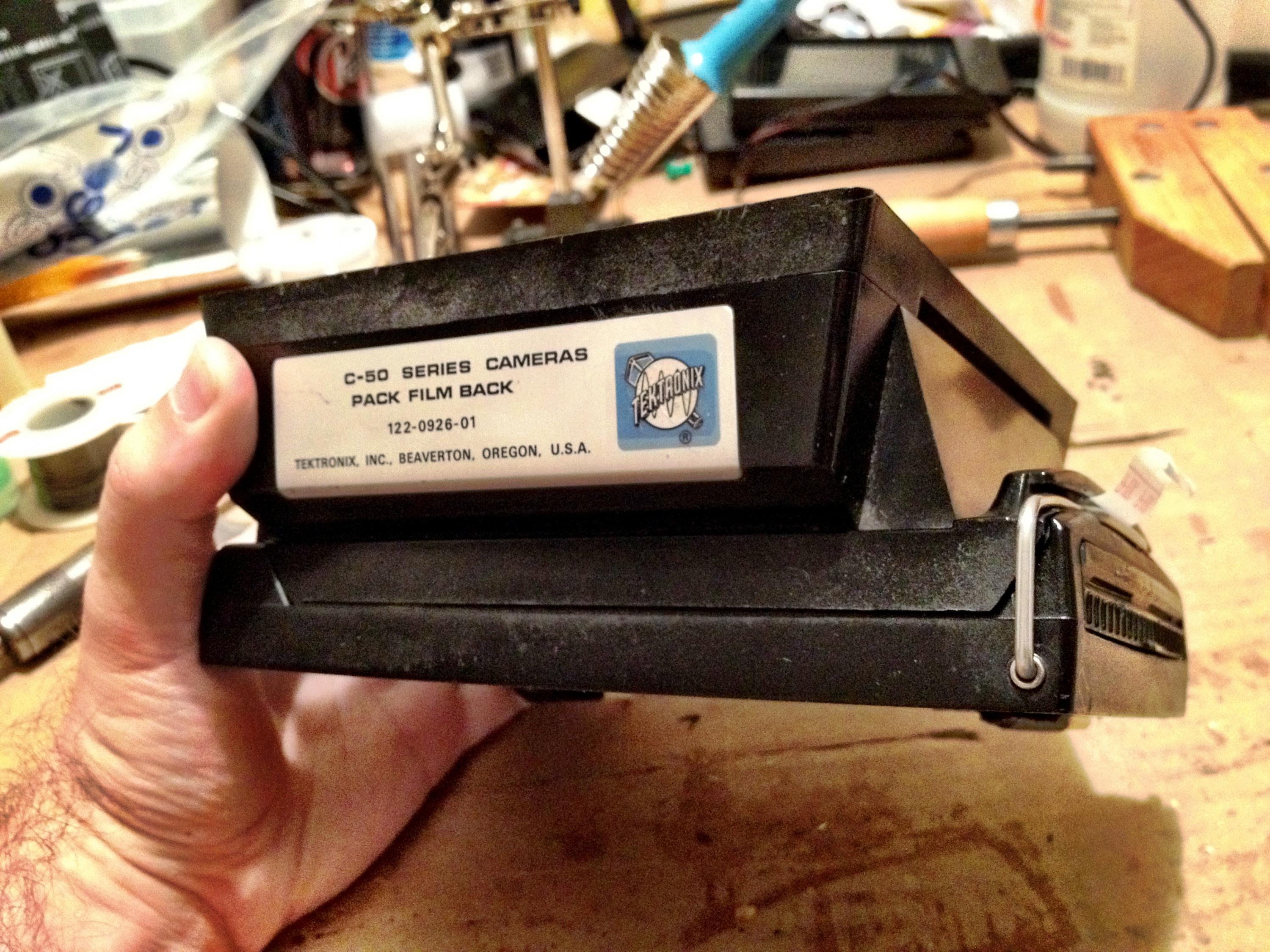

So I bought this thing off of eBay for something like $25 plus $20 shipping.
(Pack film back removed and covered over with my "shutter".)

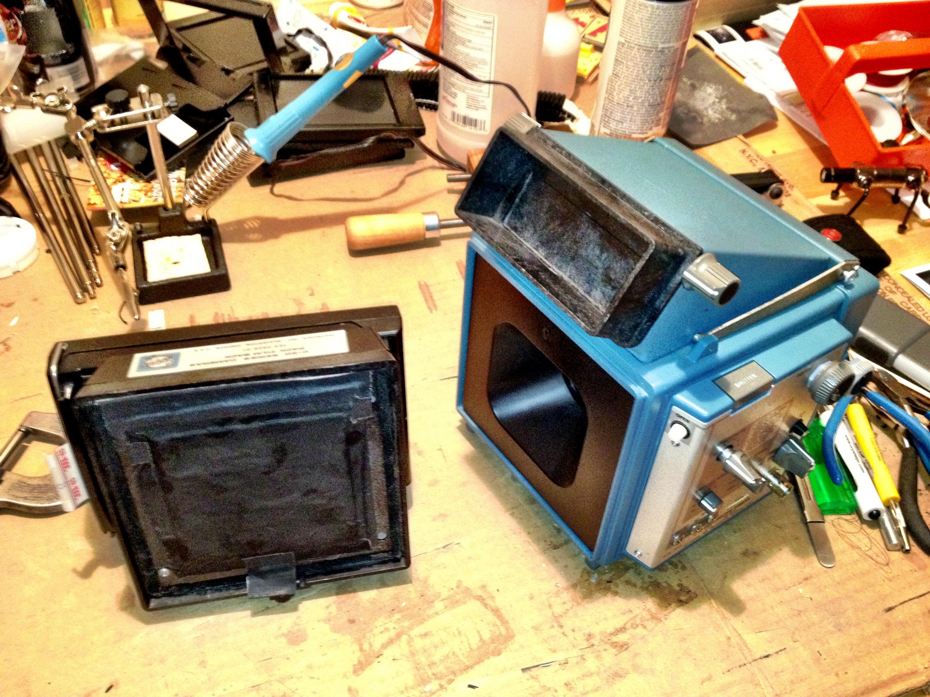

This is a cutting edge Tektronix C-53 oscilloscope camera used to make hard copies of whatever's on an old purely analog oscilloscope's screen. Damn bro, high tech! (These days I'm assuming oscilliscopes are digital and can just print whole signal traces on any sort of printer, but for some reason I think some people are still using the old ones and that my explain why Fuji is still making FP-3000B film. ISO 3000 or higher ISO film is what's really needed for these, and who cares about color.)
The main thing I wanted here was the pack film back which almost justifies the whole cost of the thing. I'm not sure what I'm going to do with the rest of the camera just yet (it only focuses to the end of the frame though it has an f/1.9-f/16 aperture, nice optical elements, fully manual controls, and "macro" focus none of which you'll find on a regular consumer land camera) but I think I can come up with something. I also got a Polaroid 335 (cheaper, plastic) camera from my neighbor for $20 so I might end up using that as a pinhole though it is a little more of a pain to modify.
Anyway, tektronix c-53 pack film back:

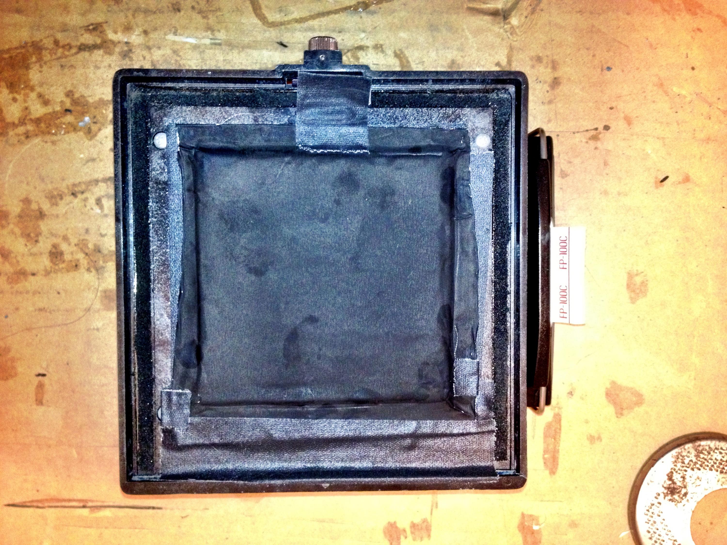

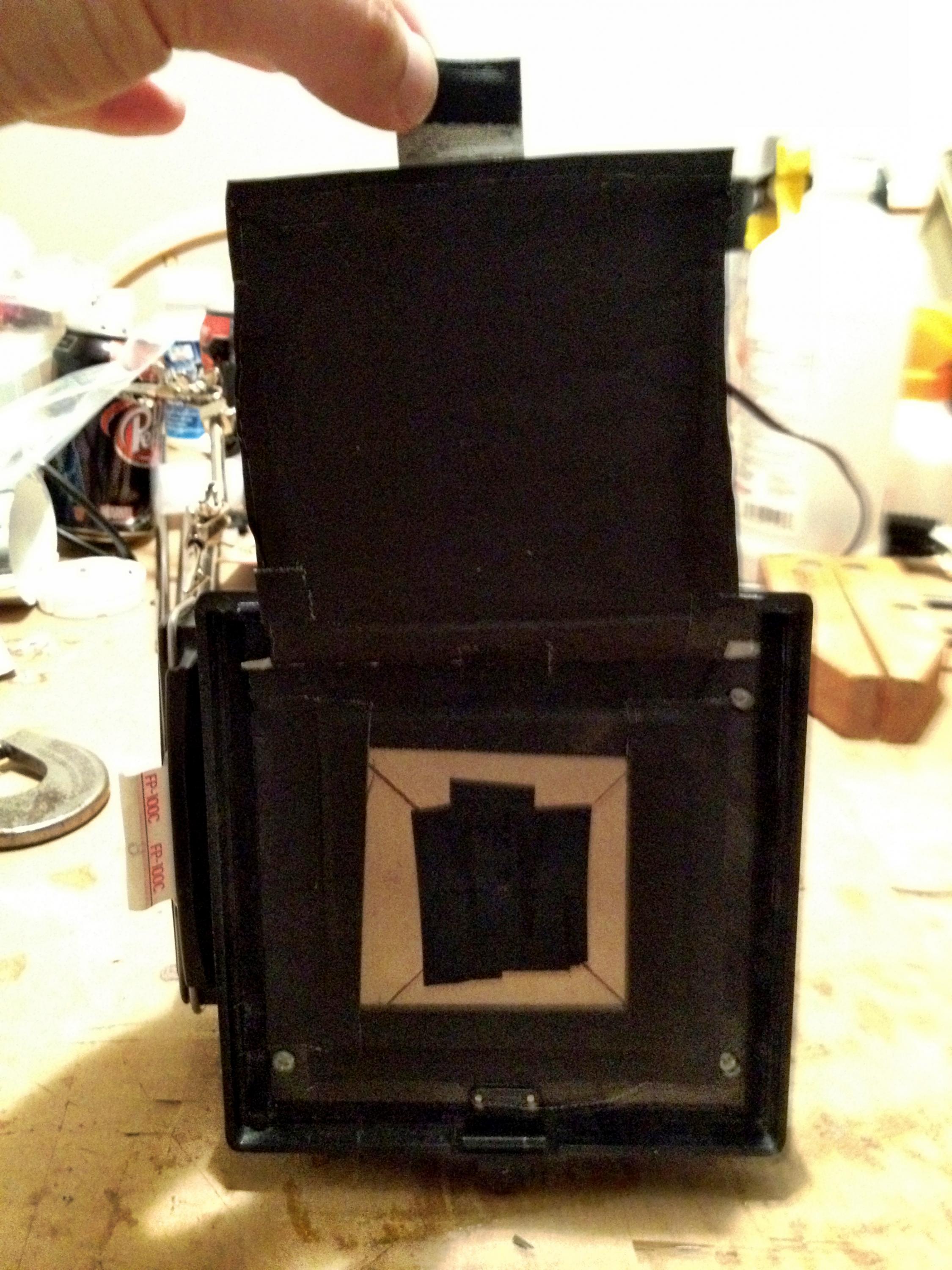

That's the normally open side that attaches to the camera, but I cut out an 8x8cm square of cardboard, spray painted one side black, punched a hole in it, made a pinhole in soda can side aluminum, taped it down to the cardboard, and taped the whole cardboard assembly over the window in the back. Then I took a square of Roscoe Cinefoil (black coated foil used for light modulation and such) and taped it over the thing to use as a shutter. Luckily there are these little bevel things that help act as a light trap, or I might have made it smaller. Really I could probably make it smaller anyway or otherwise come up with something better, but this is OK for now.
Shutter open:
I'd take the thing apart and take macro shots of the pinhole etc but I have some film in it right now and I'm too lazy to remove and bag the pack in a dark area.
Only problem with it as it is now is that without some sort of "extension tube" for the pinhole, the focal length is only like 40mm:
That means vignetting, but also a lower f-number (based on the mr. pinhole wizard) that makes it a little more convenient to play with. Luckily I can remove that plastic frame inside the front of it (enlarging the 8x8cm square) which means I should be able to later elongate it as much as I want. The pinhole I made is kind of crappy anyway and I'm going to replace that regardless. (I used something like the sewing needle and pin vice method but I filed down a wire, or tried to, and used an x-acto knife handle as a pin vice. Even sanding off burrs it's still pretty bad, though I think I actually came respectably close to 0.25-0.3mm.)

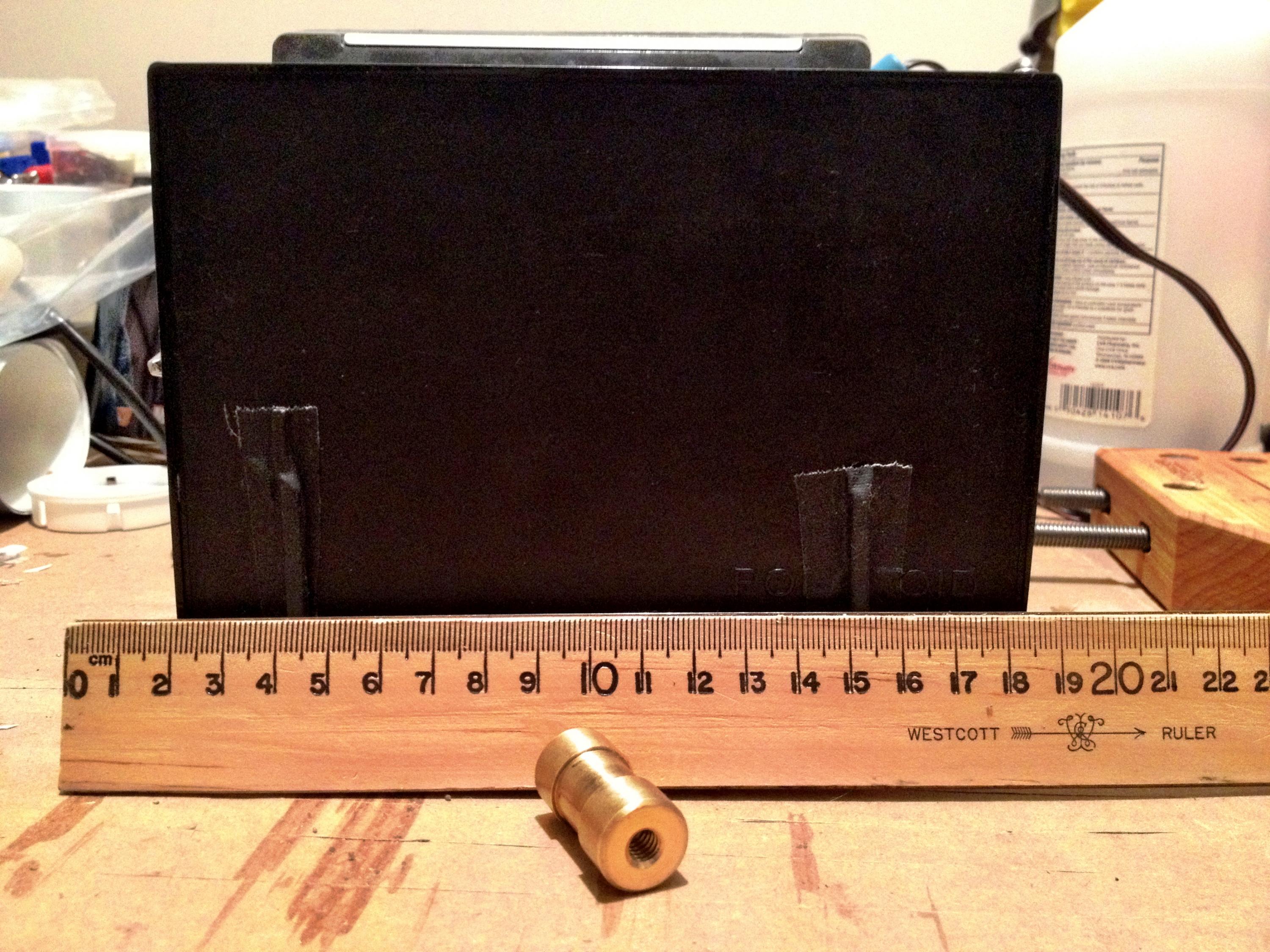

I'm going to take that brass light stand stud that I never use, drill a hole in the bottom of the film back, and bolt it to the bottom. That'll give me a standard 1/4-20 tripod hole and reasonable stability if I use some large washers.

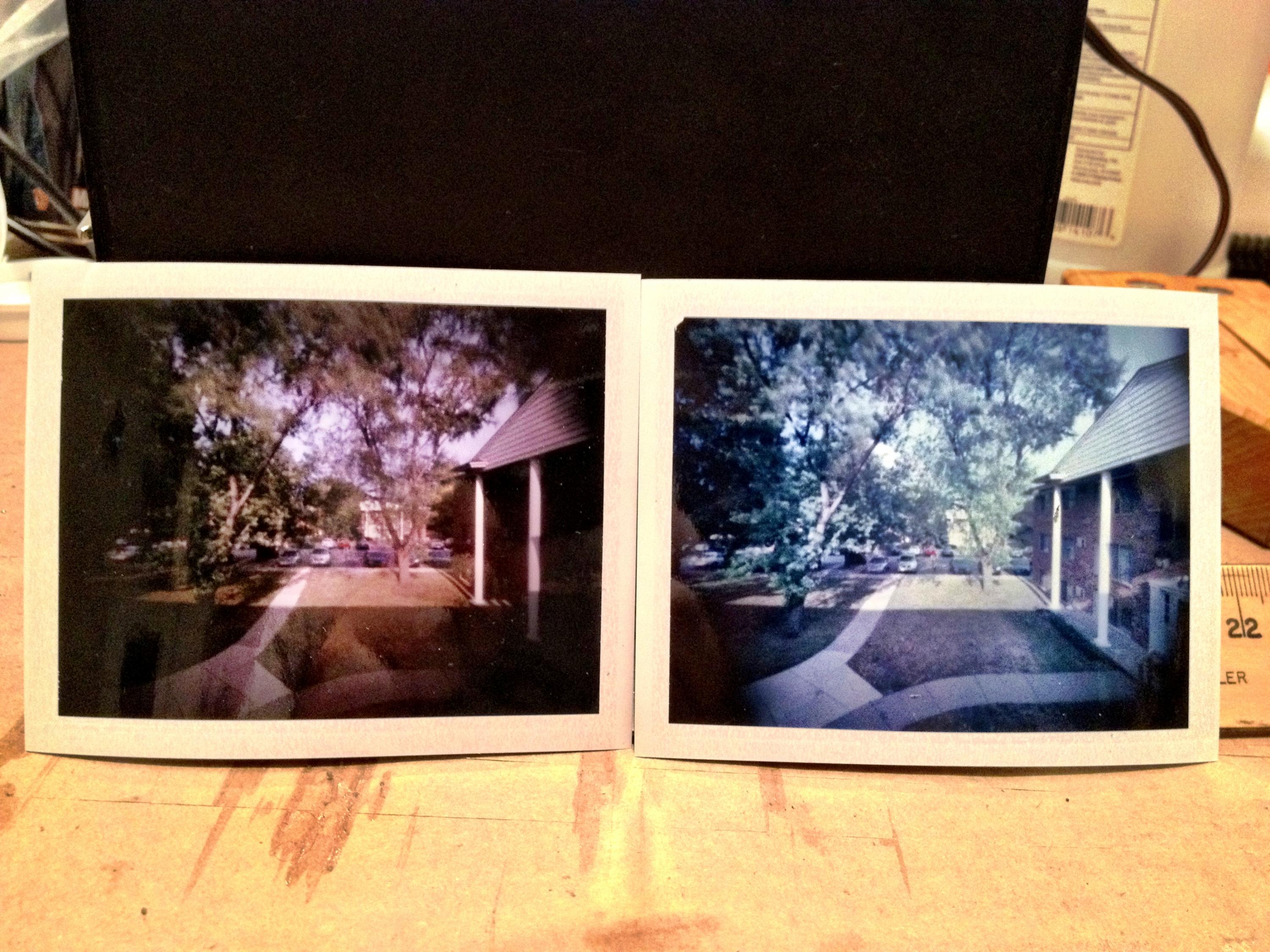

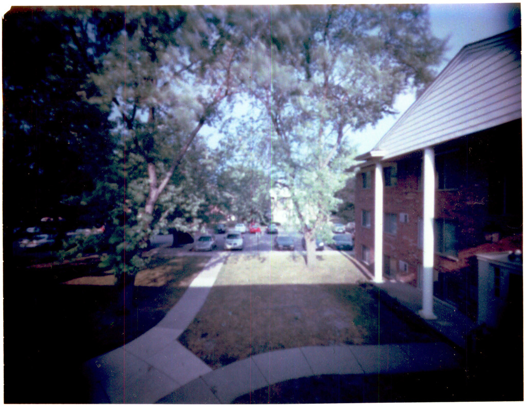

Out of 6 test shots taken from my balcony, these were my best photos. (6-8 seconds in bright daylight).
Due to the reciprocity failure issue, I'm supposed to use a +7.5Y and +12.5R filter for color correction, but all I have right now are +15Y and +30R Roscoe Calcolor filters that are made to go over lights, not use as shoot throughs. The photo on the left is with my overdone filtration, and the one on the right is unfiltered showing the cyan cast that you're supposed to be correcting for. I think I had to add something like at least +2 stops due to the reciprocity failure. (This instant stuff has a pretty high contrast tone curve, and that makes the reciprocity issues worse on the extremes.)
The dark lower area in each photo is due to a shadow on the ground (sun is behind the camera blocked by the building that it's looking out of) which gets exaggerated by the range and tone curve of the film. (it stupidly took me about 3-4 shots before I realized that it was a shadow and not something blocking the exposure somehow.)
So not too bad, but I kind of doubt that even the latest tech pack film is going to work that great for pinhole style long exposures like this. At least I can use it to test out newly drilled pinholes and still create 3.25 x 4.25" or larger images on 4x5 sheet film taped into an empty pack film cartridge. Maybe I can even find some way to use old pack film cartridges as darkslide-capable film holders.

Here's one of the photos after scanning (in my document scanner, which wasn't made for photos, thus the streaks and artifacts) and improving the color balance in Photoshop. (Not terribly proud of it but I figured that I should at least upload a photo that was scanned rather than taken with a camera with glare/reflections.)
Something like a 6-8sec exposure at f/150 or so.Pinhole1.jpg
I think it is very nice, maybe the pinhole you are going to make may give slightly sharper results.
