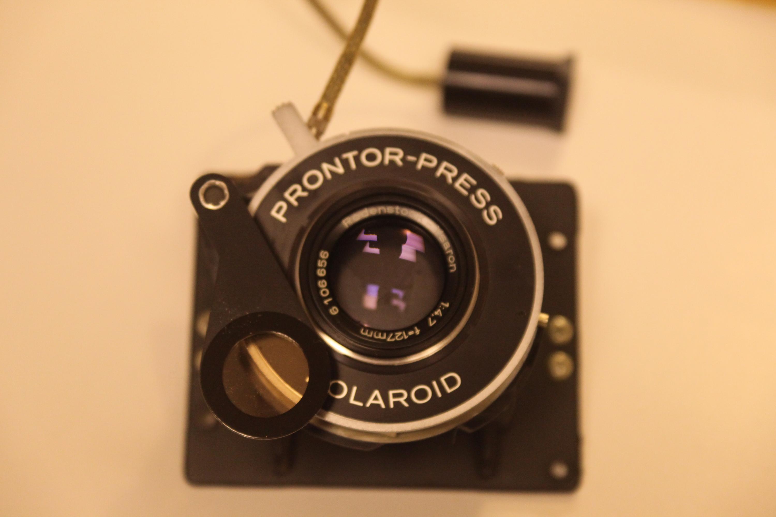

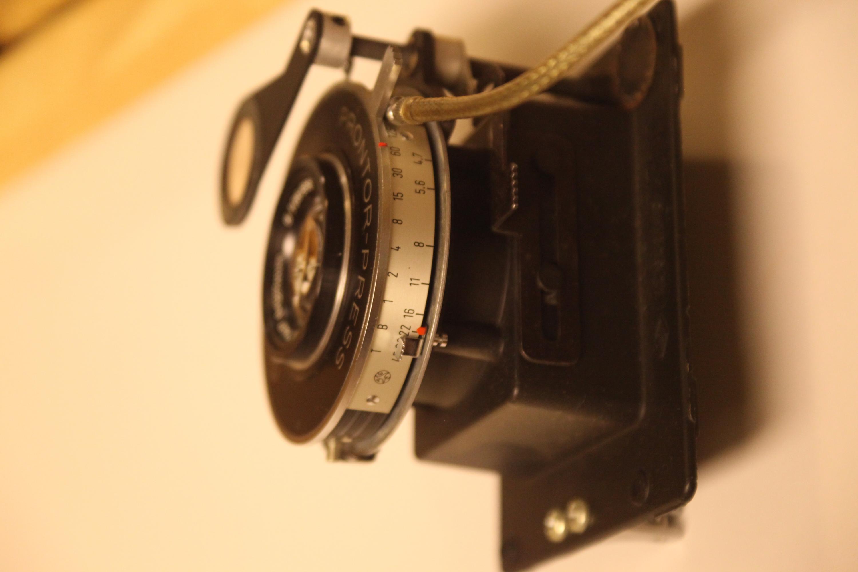

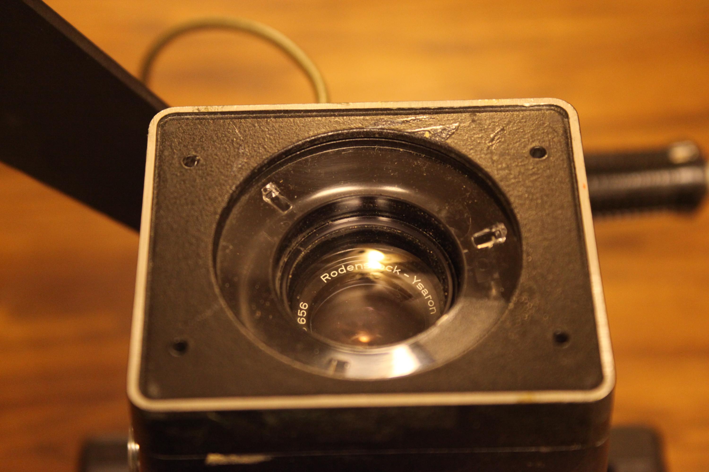

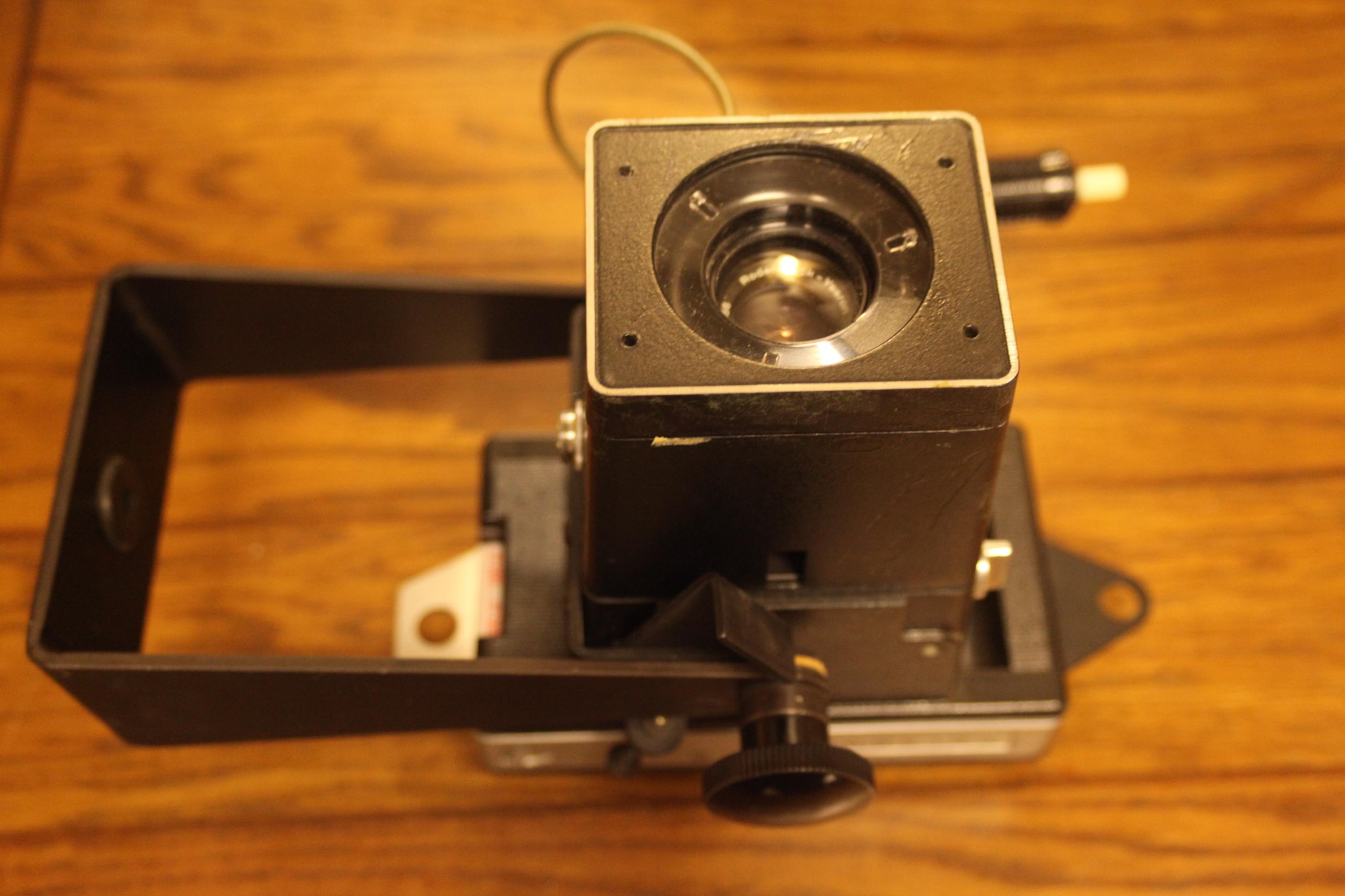

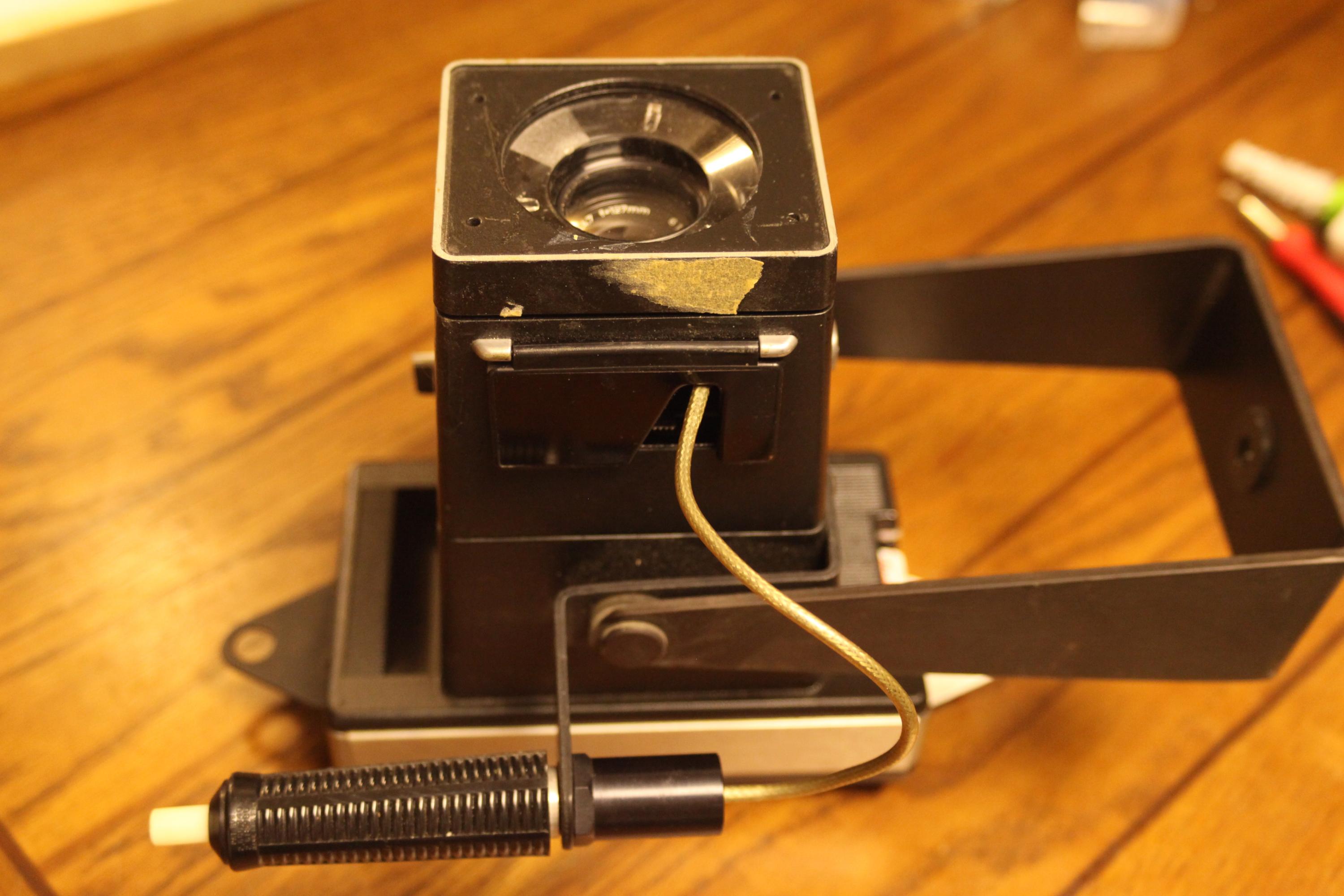

Sorry it has taken me so long to upload pictures but I forgot my card reader at work on Friday.
I took some Quick pictures and it seems that the focus is about 5 feet. Does that seem right? I thought it should be around 5 Inches.
One other thing I found is the shutter speed is way way off.
Lens:
The Lens is a Rodenstock Ysaron 127mm 1:4.7
The number on the left had side of the 1st picture is 6106656
I'm assuming (probably shouldn't do that) that the piece that rotates in front of the lens is a color correction filter. Yes No Maybe?
Where the ring flash should be is empty. It's hard to see.
Camera:
