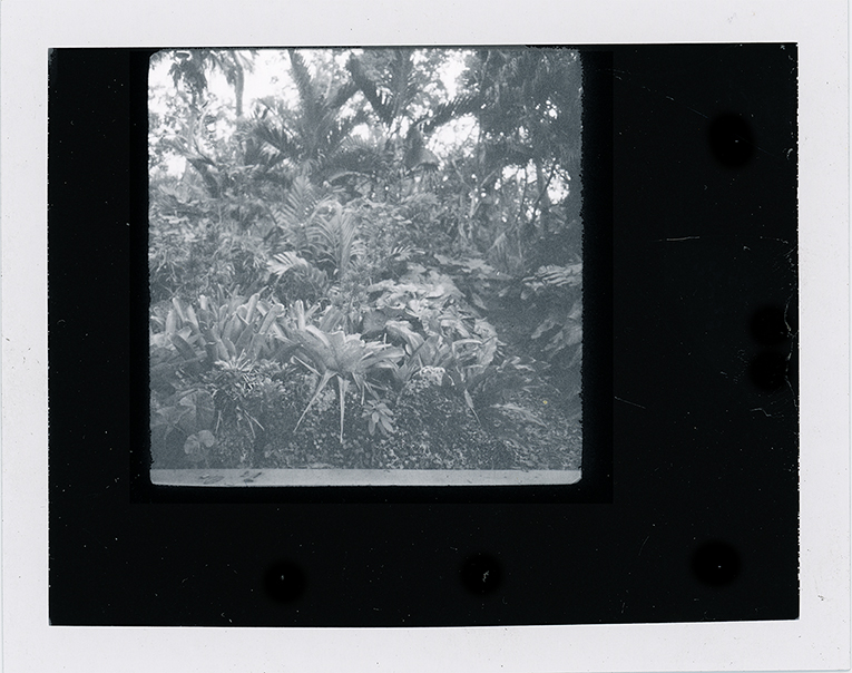

I found my old Hasselblad Polaroid back in the refrigerator and it had film in it (probably why it was in there) I didn't know which film or how old. Just for fun I decided to take a photo. I guessed 400 ISO and let it develop for 3 minutes. It lacks contrast so maybe developing longer would have helped. The light was not contrasty and the plants were mostly midtone but the bottom strip of wood deck showing is very close in tonality. I was surprised I got anything to begin with. The film is quite old though. There are a few frames left to try under different light conditions and maybe 4 or 5 minutes developing time. Here is the picture straight scan.
