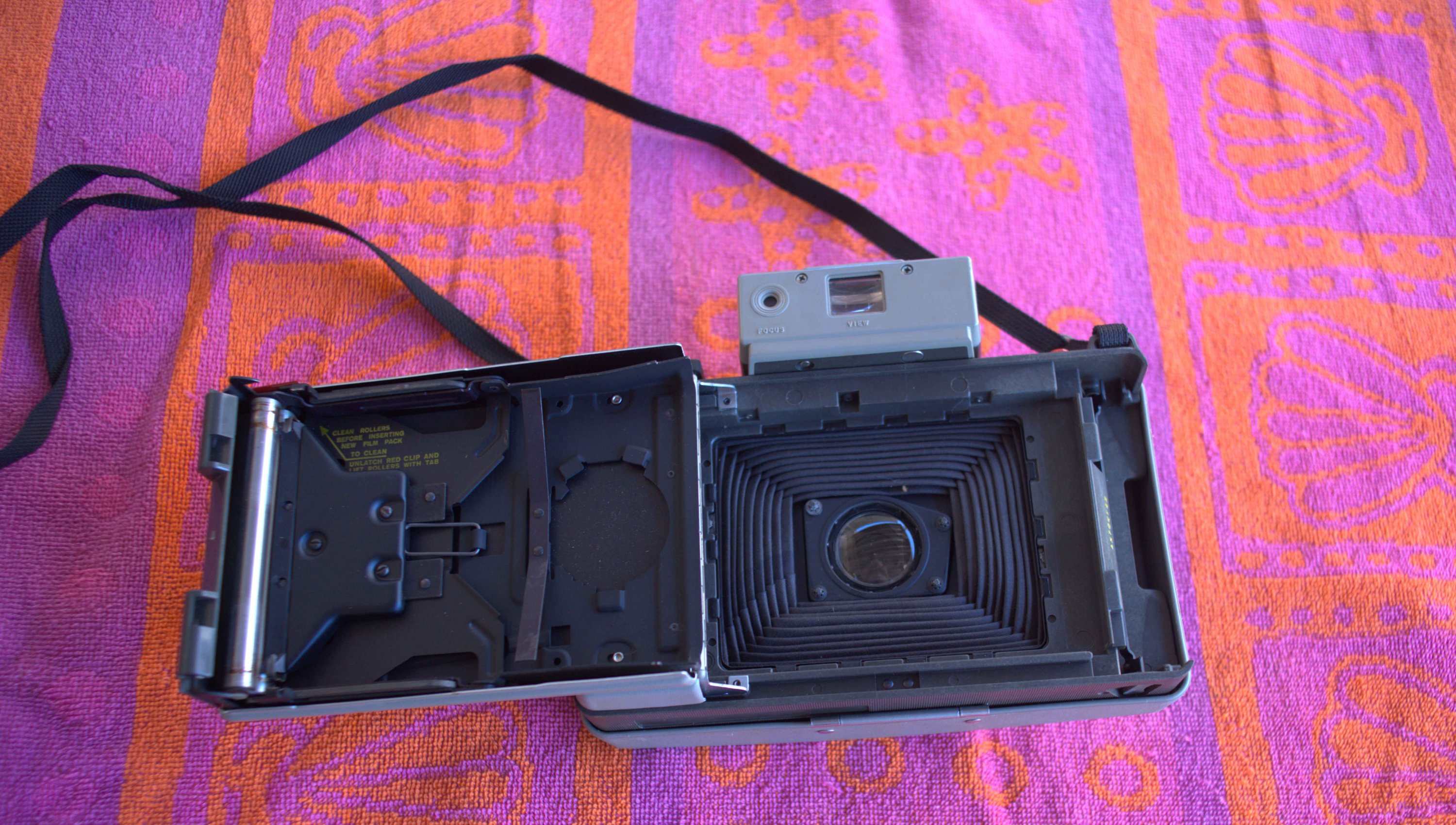

Here is a image of the Polaroid with the back open. The current back is held on by 2 small screws, other than making a light baffle, will need to have a machine shop make an adaptor plate with a cut out for 6X9. Polaroid used very durable plastic, the tow small screws hold the current back in place, thinking 4 screws will hold an adaptor plate in place without issue. Biggest concern is the machine shop costs, small job but will be cheap.
Small jobs are never cheap, because machine shops don't want them.
They don't want them because of setup time -- even with CNC, someone has to model the part, generate the tool path, and then check the tool path before risking cutters and materials (a high speed carbide cutter alone might cost more than your whole project).
Setup time is half the workload for a run of a hundred small parts -- it's virtually all of a one-off. Sure, there are a few shops that do one-off stuff, but they don't work cheap; they have to pay their own overhead, machine time, wages, and maintenance costs.
If you can do the 3D modeling yourself for the part you need, there are alternatives -- there are businesses all over that do bespoke 3D printing, as well as metal 3D printing (for better strength and opacity), casting (from 3D printed investments), etc. And a couple that do one-off CNC machining from your model -- but then the mistakes are yours; if your model has a problem, you'll find out after you've paid for the part and it's in your hands, and then have to pay again for a corrected one.
