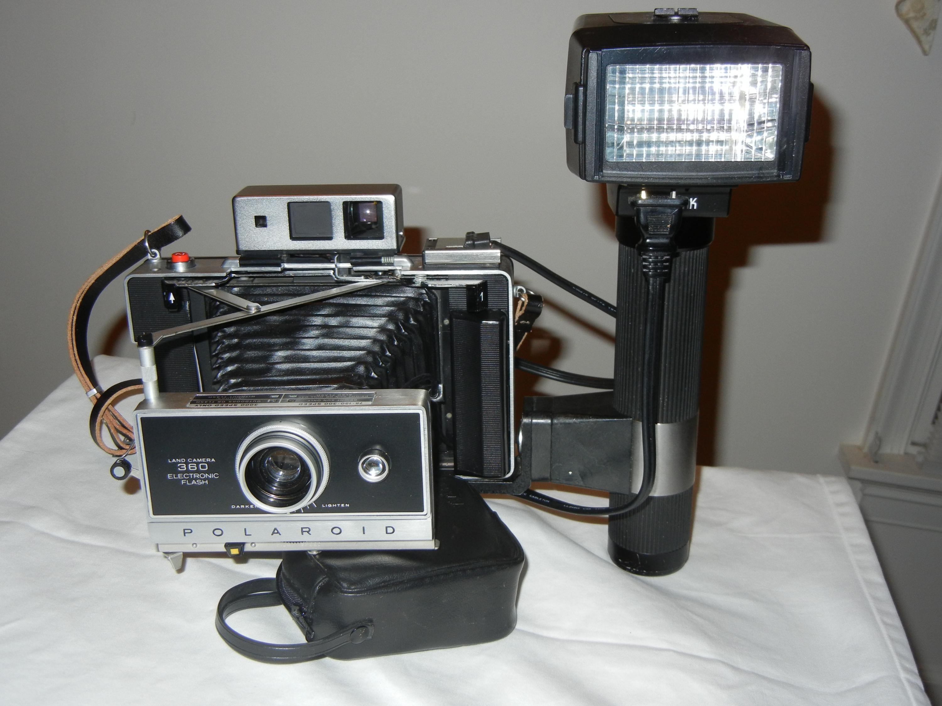

I just received my Polaroid 360 with flash and charger. I was able to find replacement batteries for the camera, but I need to do something about the flash.
Would you simply replace the rechargeable battery in the flash with a new one? Or modify it with an external AA battery box or something?

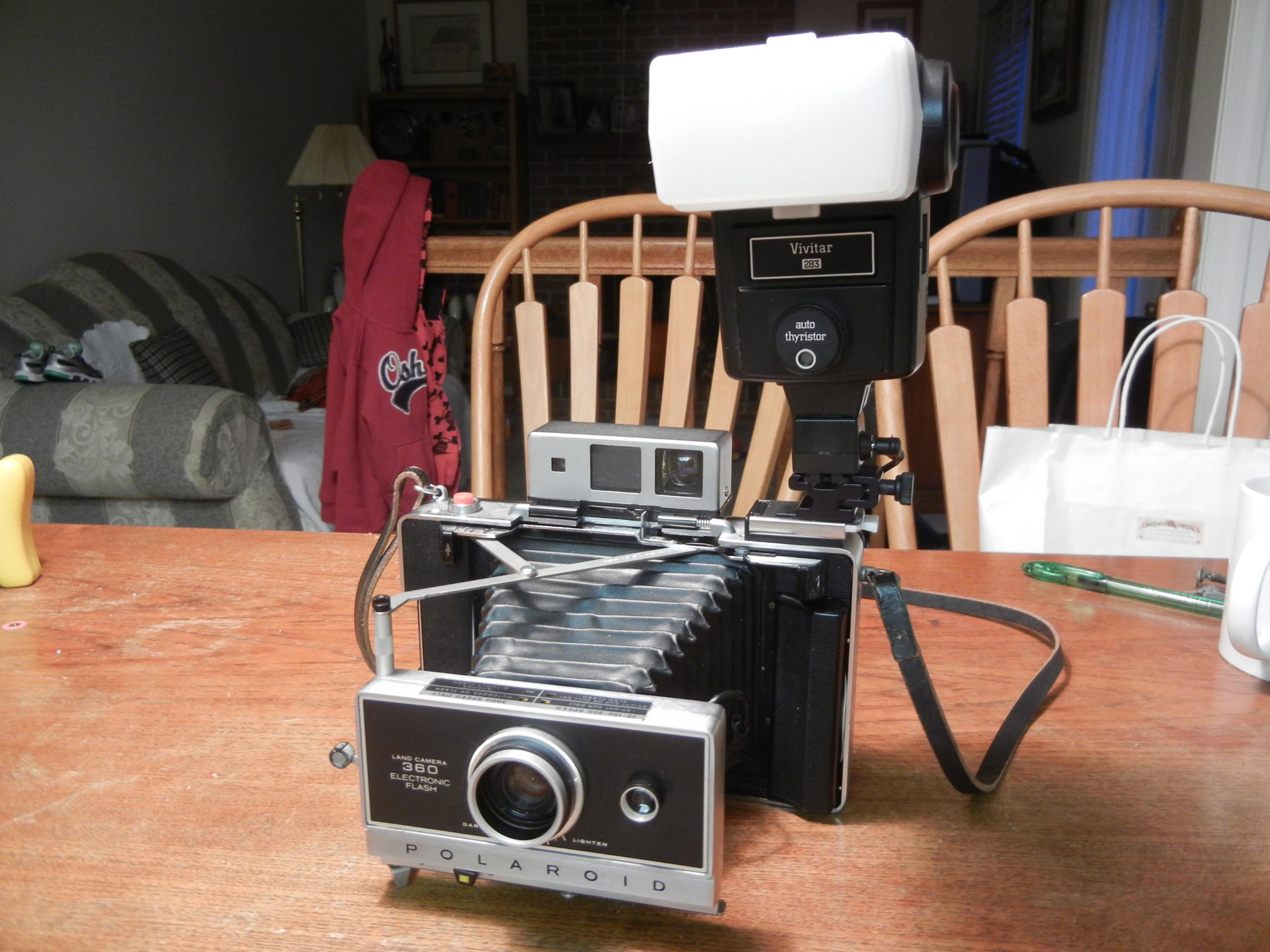

there must have been conversions by polaroid camera repair. I bought one from the son of an american professional photographer which has the special adapter converted to a hot shoe. I was told that the conversion had been made by polaroid. in any case: obviously it's possible and with an electronic controlled flash it works fine. I'm not much into electronics but perhaps there is somebody who could do it for us. I would appreciate it, as I have more of these cameras and only one original flash working.

It isn't that hard, and there are indeed many options. The one from The Film Photography Project/Podcast is an excellent one. More on my blog at arthurpolaroid.wordpress.com

It isn't overwhelmingly difficult to adapt a sync cord to the Polaroid 360 flash connector, or to add a PC port or hot shoe. The Polaroid 365 flash is modestly powered, if you want more light you need a better flash.
