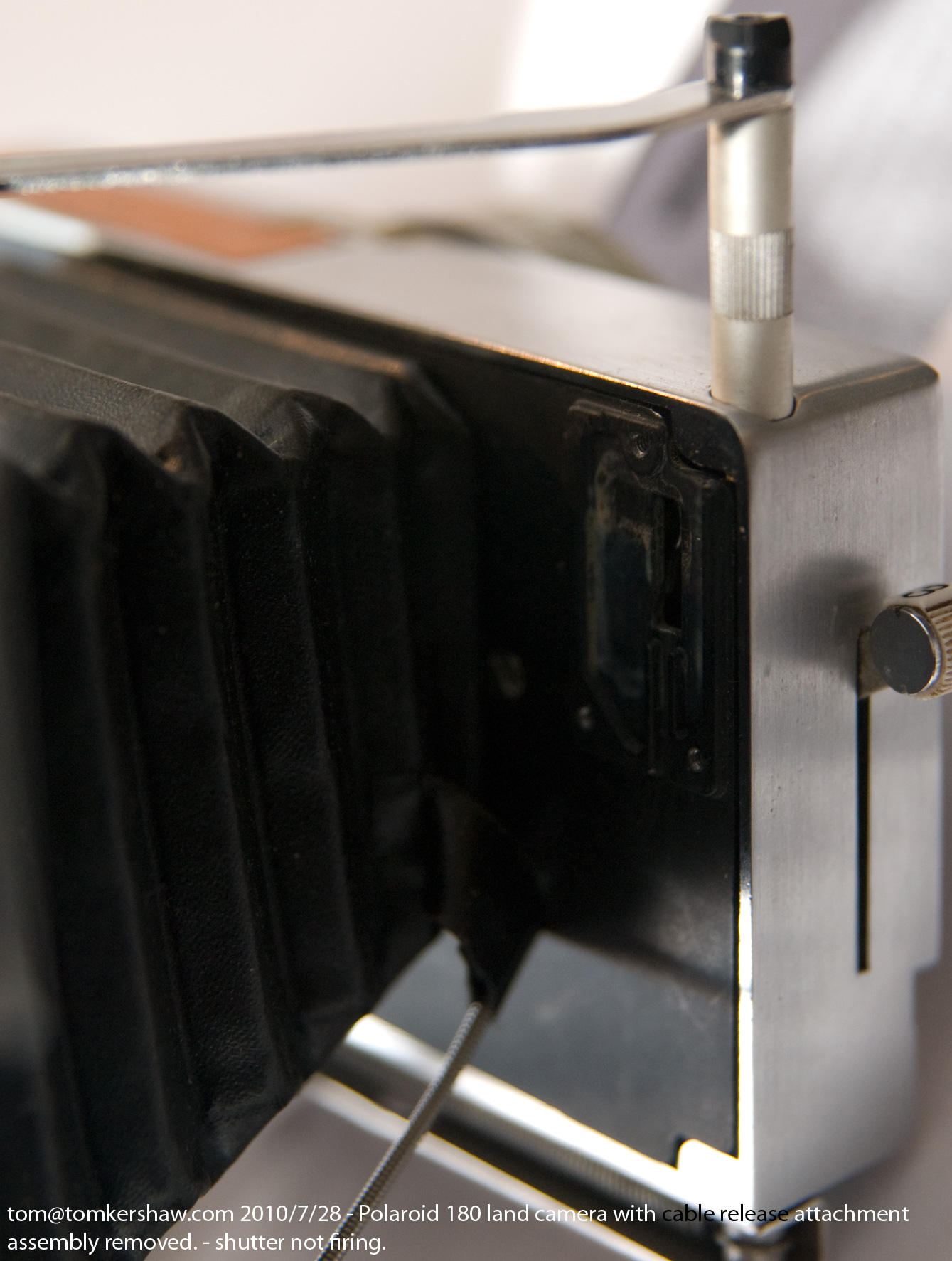

I'm thinking about trying out a Polaroid 180 camera I have sitting around. However after cocking the shutter the red release button does not fire the shutter; does the shutter only fire with film in place? - I assume the Fuji 100C medium format product is compatible?

the 180 has a manual shutter indeed. there is no battery and no meter. try to change the speed to B and back and look what happens. sometimes this may help. the shutter may stick after some years.

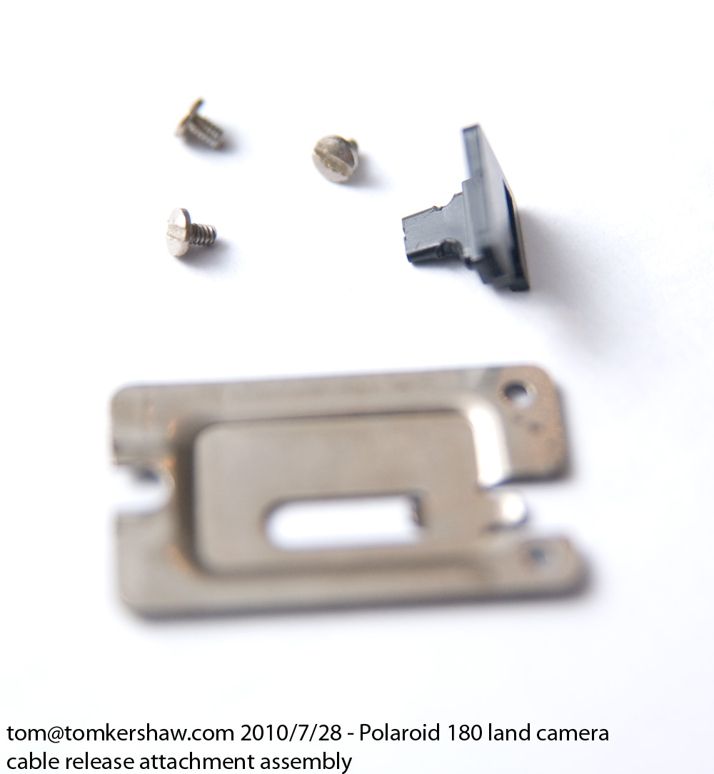

Here are a couple of photos:
It looks as though if I want to get this camera working I'll have to send it off for repair or find some DIY instructions.
