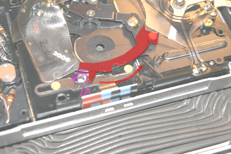

Hello everyone. Just today I was able to get an Automatic 100 but, to my dismay, the scene selector appears to be jammed. Everything else works fine, I'm able to change speeds with the wheel properly. I can move over the knob a bit, but then it won't budge. I've never had this kind of problem with my 220 or 215. Before I have to open the shutter/lens housing, has anyone else had a similar problem?

I was able to fix the problem myself by taking off the board cover and seeing that the lever rotating the different apertures had gone to the wrong side. It was just a matter of putting the lever (red) back along with it's tension wire (pink). I hope someone else can use this information when encountering a similar problem.
