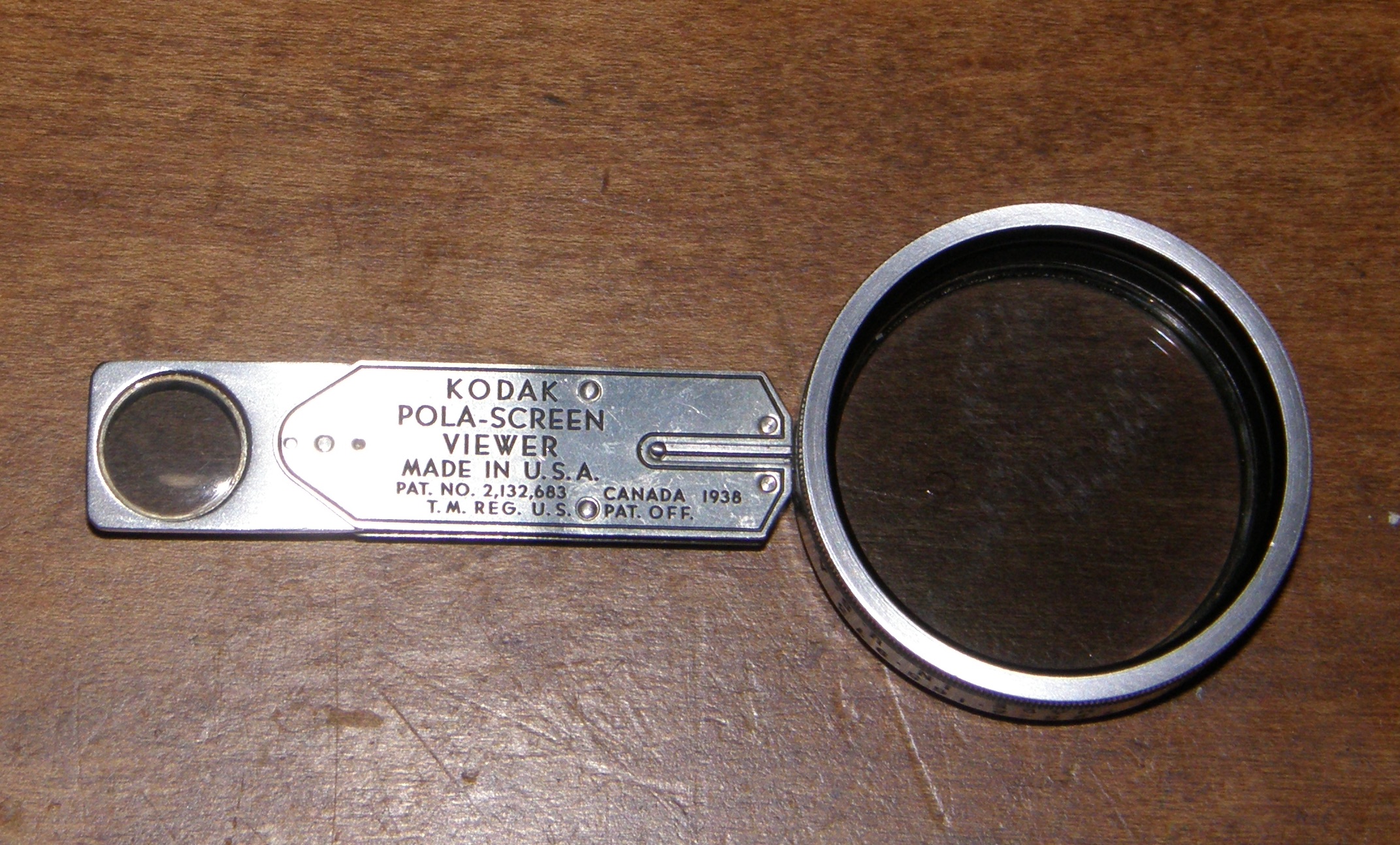

Back in the day, Kodak had you covered-- a circular polarizer with detachable viewing polarizer-- the TLR of filters! (ETA- big honking thumbprint since cleaned off!)
