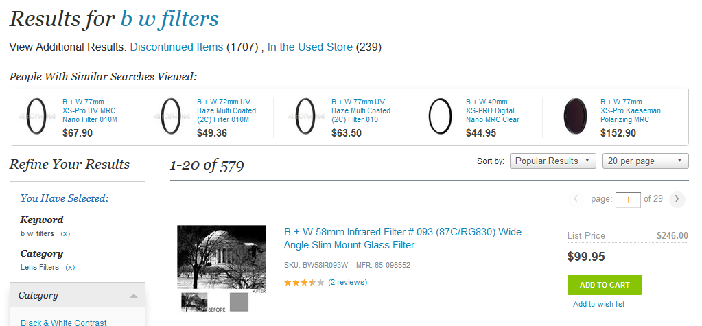

Thanks, I noticed the Heliopan. However, in the specs it states it is not multi-coated. :sad:
Yes, I think (not sure where I read this and it may be wrong) that multi-coating tech came around the 80s (relatively new) compared to linear polarizer, maybe manufactures decided to multi-coat the new circular polarizer only. I did quick search and it looks like B+W was the only major one to offer linear and multi-coated. The B&H page that I sent in previous post doesn't have any linear and multi-coated at the same time
