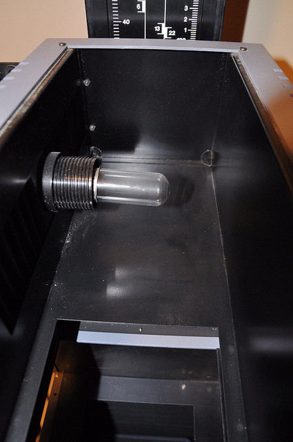

The following is from the Durst Varipoint (point source) enlarger manual:
3.3 Black-and-white enlarging with the Varipoint 1200
Check for evenness of illumination
*Switch on enlarger lamp
For unit version equipped with OPTO-TIM press "Light" key
*Open LENS diaphragm fully
Lamp centering:
If there are shadows on the baseboard, center the lamp as follows:
*Turn knobs 103 and 105 until projection is free of shadows.
*Turn lamp and adjust horizontally (103 = horizontal adjustment, 105 = vertical adjustment)
NOTE: do not stop down the lens!
Here is a picture of a Durst Varipoint bulb:
