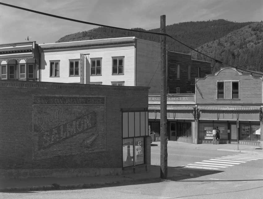

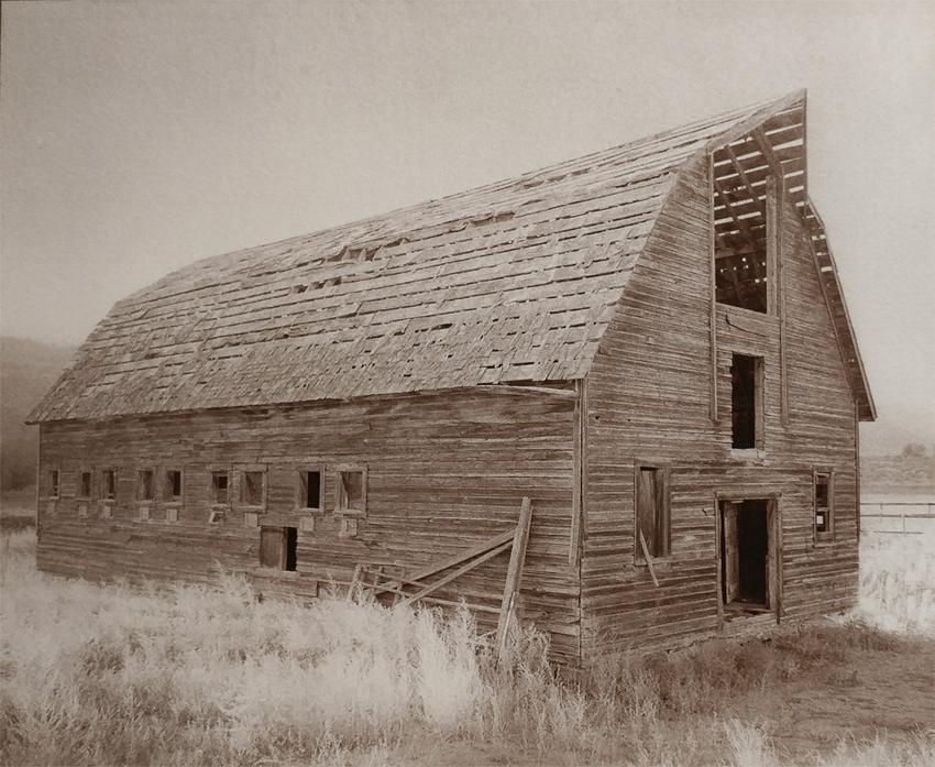

I haven't silver printed since I got into Alt. processes back in 2009 😁 but.... Here is a kallitype print of an old barn from a semi-stand HP5 8x10 negative, and a negative scan of the town of Greenwood, which was on TMY 8x10, semi-stand. Both Pyrocat-HD 1+1+240
