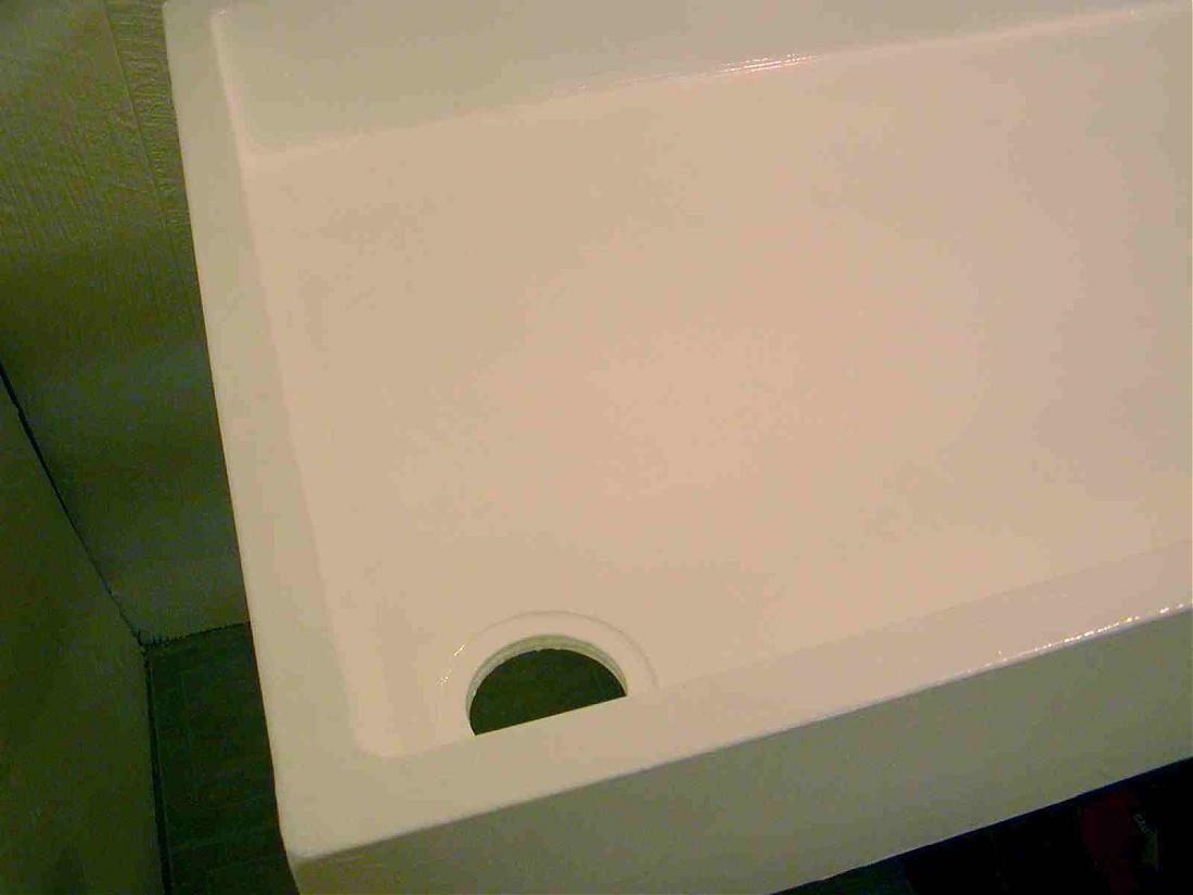

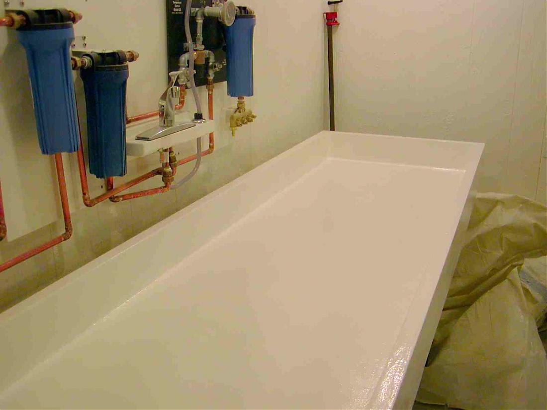

My plywood sink (actually I used 2x6's for the sides and ends, makes it easy to lean on late at night, and 3/4 for the bottom, size 10' x 32") has two splices in it (didn't want to buy 10' ply). I used cove material to round the inside edges. Did all the gluing with exterior Tite-Bond (regular carpenter's glue) and then coated the whole thing with System three epoxy (do not use the polyester, it will stink up the whole house, and is explosive I think) forget how many coats, used about a 2/3 gallon. It's two years old now, except for stains, it looks like new, and at this point I don't think it could ever leak. I am happy with it. Note the inside corner detail in the photo.
