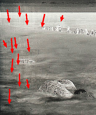

I decided to try some Plus-X 120 film and my first impression is horrible...
I developed a roll for testing in the same tank as two rolls of Tri-X 400 120. The two rolls of Tri-X came out perfect, as they always do, and the Plus-X came out like the attachment shows. What the heck happened here?
Film: Kodak 125PX, 120 roll
Dev: Pyrocat-MC 1+1+100 (13 minutes, agitate full 1st min, then twice every 3 mins, 70*F)
Stop: Water
Fix: Ilford Hypam 1+4 (fresh)
Wash and dry with PhotoFlo
What's going on? Can we single out flm problem here?
Thanks for your insight.
- Thomas

Whew! I could imagine several things, but most likely seems to me to be pressure marks judging only from appearance. When or where that might have happened, who knows? I'm only guessing.
I use the same film, developer combination and time, but mine don't look anything like that. Could it just be a defective roll? Of all the troubleshooting I've had to do in the past and books I've read, I haven't seen anything like that. It looks like streaks of something maybe on the left hand side. Try again maybe and see if it persists?
Is the roll uniform with all the frames showing the same issues? I'm not sure of the cause but I saw a streaking similar what's on the left side your image, though much less pronounced on a roll of acros I recently processed in pyrocat at the same dilution. I saw it running lengthwise, and only on one frame. My only theory (and I'm not sure it's a good one), is that some crystals that have formed around the mouth of the B solution got into the developer.

Yes, something wrong with that particular roll of film, or something went wrong with processing that particular roll. I don't think that Pyrocat is to blaim either. I remember seeing similar artifacts, but it was a long time ago and I don't remember neither the cause nor the cure.

Yes, same camera, but different film backs? I once had a white scratch issue with a Bronica back. Turns out it was an ever-so-small rough spot on one of the rollers. A piece of ultra fine sandpaper fixed the problem.
Plus-X is a great film and while it *COULD* happen, a defect in the film is not likely. I've been shooting Kodak film for 30 years and haven't seen one yet. The QC at EK is great.

Is it possible the roll of Plus-X got sent through a CT scanner or something (e.g. on checked baggage)? Those are weird marks.
Thomas;
Pressure marks are generally dark on the negative and therefore light on the positive image. These appear dark. It therefore was something that reduced development in the developer. Can't say otherwise.
PE

This makes me wonder: 1) How old is the PX/ exp date?
2) Where did you buy it? Could it be gray mkt and sat on a dock in the heat of the equator for 7 years?
Try a roll of a different 100 +- speed film (FP-4, TMax, Acros etc.) in the same dev and see what that does.

It is safe to assume, until proven otherwise, that Kodak makes film perfectly. Also, that Plus X is beyond reproach. I'll stick my neck out and say that say that PyroCat is friendly stuff, and that it is unlikely in the extreme that two rolls would be unaffected by any latent developer malevolence while the third was struck.

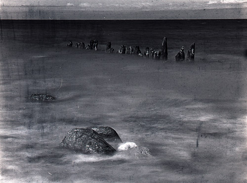

I inverted the sample to look at the 'negative', and sharpened it.
It seems the marks are generally in the direction of film travel through the camera, but are curving slightly.
Is the film abraided ? Are there drying marks on the film ?
What color socks were you wearing ?

Curious. Well, before investing a lot of time in understanding what may have been spurious, why not do another test with fresh developer. Maybe just snip some film off another roll and see what results.

Fresh date, 09/2010. Bought at the local store, National Camera Exchange in Edina, Minnesota. I bought two pro-packs, and I'm going to run a roll through another camera today and develop it alongside a roll from the camera that had the problem roll through it. See what happens.
I did develop a roll of FP4+, also fresh date, bought from the same place, and it came out brilliant!

this would represent the first time I've ever had such a problem with a Kodak roll of film, indeed, that's why I'm so curious about what might have gone wrong.
Film is not abraided, upon closer inspection, it looks just like when a surface gets static electricity charges and collects dust irregularly. Then it's as if that dust was embedded in the emulsion. That's how I best can describe it.
There are a few drying marks on the film, but they don't correspond to the patterns that show up. I could even see them when the film was wet.
Socks - black, my friend. I always wear black socks when I photograph. Perhaps time for a change? :wink:

your developer suggestions doesn't make sense, since the two other rolls in the same batch came out perfect - shot through the same camera, back, lens, system, everything on the same day even. There must be something either with that roll of film, or the combination of Plus-X and Pyrocat that just doesn't work.
By developing a roll in Xtol later today I'll eliminate one of those problems.

Looks a lot to me like the film was wiped with something not quite clean before it was fully dry.
Gary;
Good thought, but how about this... It was wiped with something not quite clean before it was developed.
That would retard development. I can't see how wiping it after development would decrease the film density, but, it would decrease film density if you wiped it before processing.
