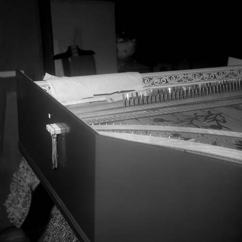

Here's a neg scan from the Xtol negatives. I think I will use Plus-X when I can, it looks absolutely fantastic! Love it.
- Thomas
Now, that looks more like what I would have expected from Plus-X. Years ago I shot a lot on Plus-X and loved it. It wasn't making sense to me that you had bad results.

I think that this frame was touching something during development (possibly the wall of the tank or the film).
Personally I have never had problems with Kodak products in general.
I'm pretty confident now that the problem was due to contamination. It was the first batch of negs I processed after returning home from Photostock, and I must have forgotten to clean out the 2 liter graduate (which I know I've used to mix both developer and fixer in the past and I cannot remember what I mixed last. Time to buy one more). The Plus-X negs were thinner than the Tri-X negs, and those are slightly (but thankfully not problematically) affected as well. Printing some of the negs in the darkroom revealed more than the naked eye could see on the negs. Luckily I print lith where it isn't that critical that the negs are 100% perfect.
Thanks to everybody for chiming in, and sorry for wasting your time!

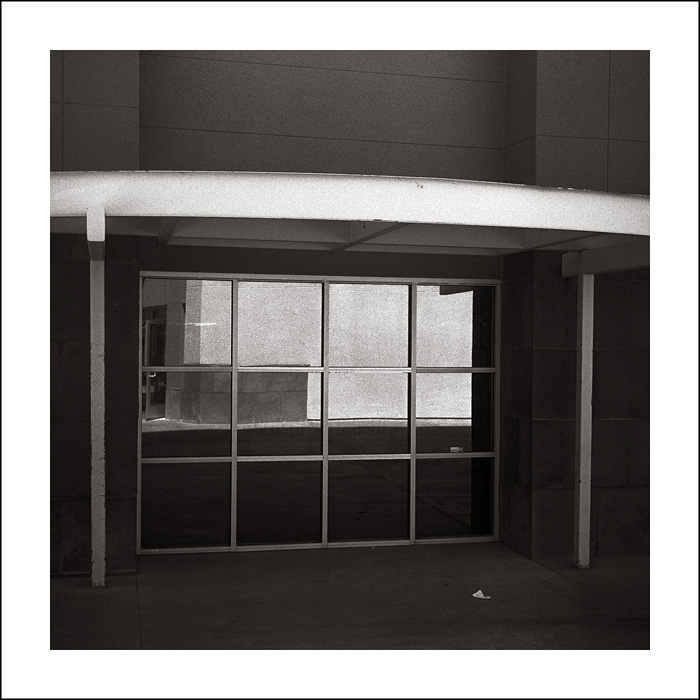

Tried Rodinal!
I had a bottle of Rodinal sitting around, collecting dust. So I thought I should try it with my mis-fortunate rolls of Plus-X.
These are shot with an Agfa Commander folding camera. No light meter, so I went on judging visually what the shutter times should be. Based on that I thought that stand or extreme minimal agitation was called for. So I developed 1+100 at 70*F for half an hour with agitation first minute and once at 15 minutes. It worked very well! I'm a bit smitten, I have to confess.
No distilled water, good old tap stuff...
Shot in Las Vegas, at the World Market Outlet. Cool place. Wonderful light for this kind of shot.
Thanks for all you help. I think I found my solution!
