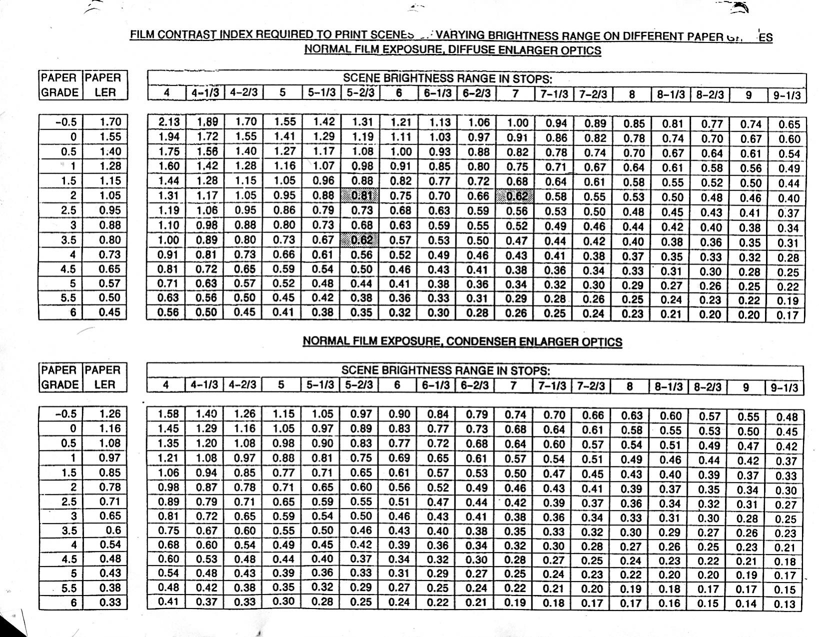

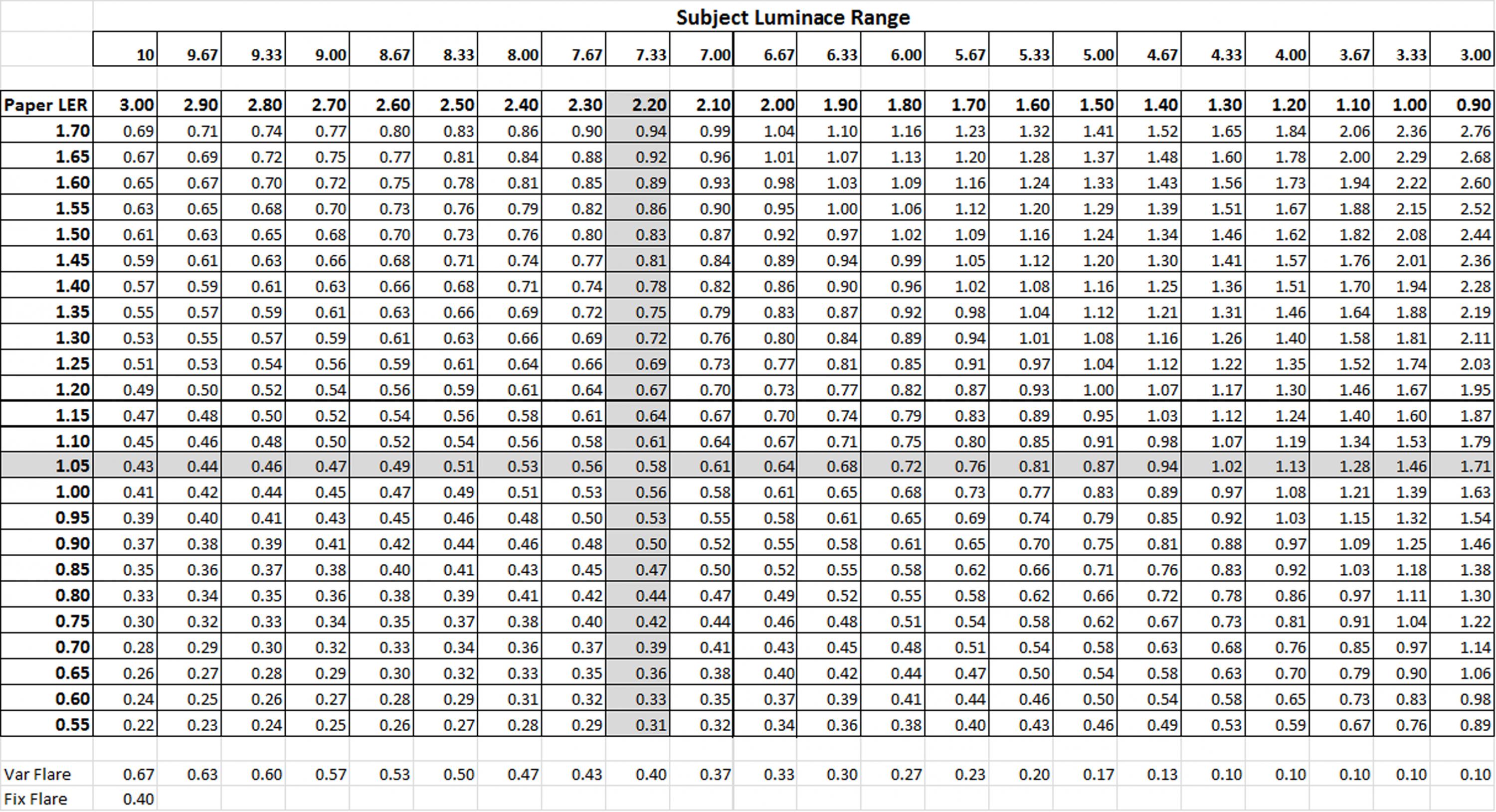

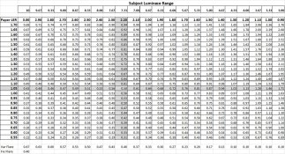

Here are two developmental charts. One using a fixed flare value (Kodak) and the other is one I call the practical flare model.

p.s. I use the charts Stephen Benskin just posted.
In the practical flare model, you can find N+4
3 stops subject would be N+4, the far-right column. Grade 3 would be 0.88 on the LER row (say 0.90), the far right contrast figure for that row is 1.46
For me, 48 minutes in D-76 straight gives me 1.2 - so I still cannot reach what is really needed for the shot.
