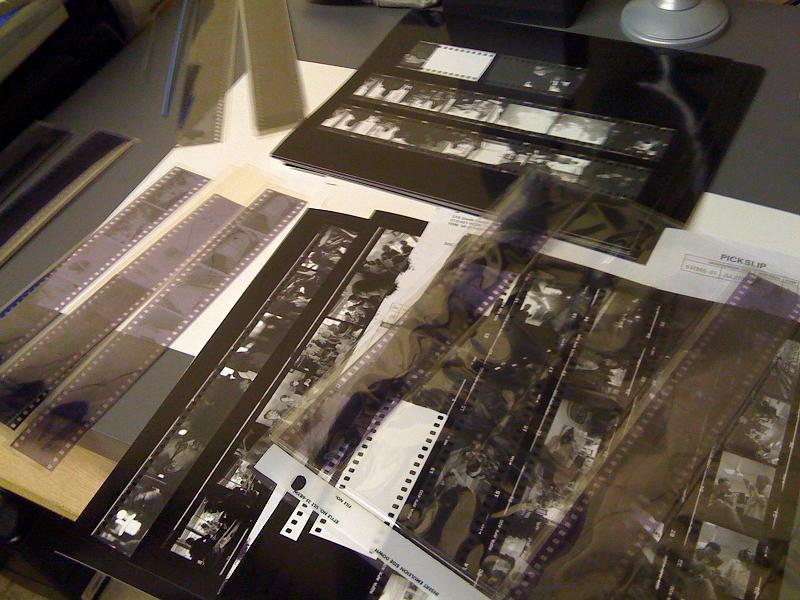

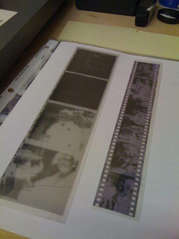

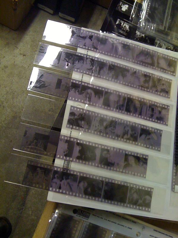

This is during some "organization":
attachment.php
attachment.php
attachment.php
