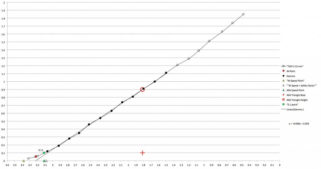

I wrote my own spreadsheet to do the calculations. There are various levels of this. For example you can easily plot the data and get the equation to your curve. Solving for to find X when Y= 0.1 from your quadratic equation can be the challenge in most spreadsheets. I use a simple interpolation to do it, that is I don't use the equation that I can't solve easily.

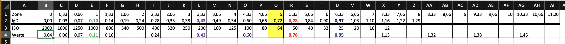

Here is one of the tests I recently did on FP4+ in XTOL 1+1, 20 °C, 10 min, inversion method (1 min constant, then 10 s at the beginning of every minute):
The first two lines show what I was expected to shoot. I then used my Nikon FM3a (which is my most precise camera and the easiest to use for this test) to shoot at the values in line 3 (line marked ISO).
Frame 4 (column E) was supposed to be Zone I with a density of 0.10 or 0.11, Frame 10 (column Q) was supposed to be Zone V with a density of 0.72 and frame 13 was supposed to be Zone VIII with an expected density of 1.29
As you can see I got density 0.11 not at frame 4 but at frame 6, so the lower two lines need to moved to the left by two steps. After that the table looks like this:
At Zone 5 (Q) you now see that we are at ISO 64. And while there is no frame shot at exactly this exposure, you can still check the other exposures and you will see: At ISO 50 density should be 0.78 and is 0.78, At ISO 25 it was expected to be 0.97 and is 0.95. So this is an almost perfect match. ISO 64 and XTOL 1+1 10:00 gets perfect results for my camera/enlarger.

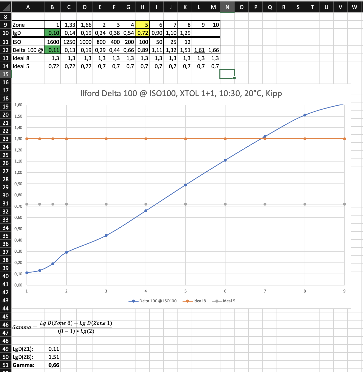

Here is the table reduced to only actual test values and the curve, for standard development the blue curve should cross thegrey line exactly at Zone V and the orange line at Zone 8. I think I hit them close enough:
Thorsten
May 20, 2015
48
Yesterday by the way I tested Delta 100 with exactly the same method, also XTOL 1+1, 10:30. Here is the result:
As you can see it is overdeveloped a bit. This is actually a perfect N+1 curve. I made another test yesterday and developed it for 9:30 instead of 10:30, but have not measured the results yet.

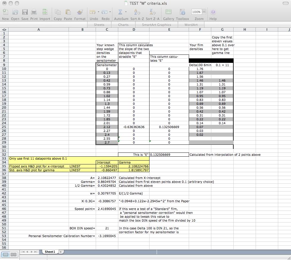

I have about 20 versions of this Excel file, but Excel does not run on my computer anymore after I was forced to "upgrade" operating systems some time ago. So this one may or may not work, I have no way of knowing:
  • W speed and ASA triangle.xls
