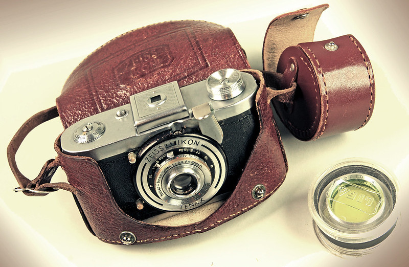

Tenax I was excellent. I played with it for several films. It was excellent even with Novar lens, but some guy from rangefinder forum said with Tessar is much better.
Here are examples & my camera picture:
