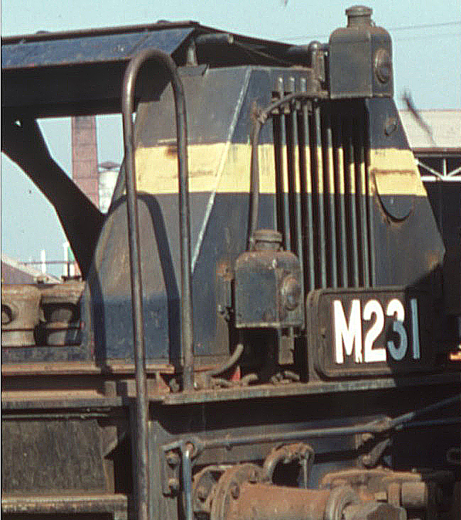

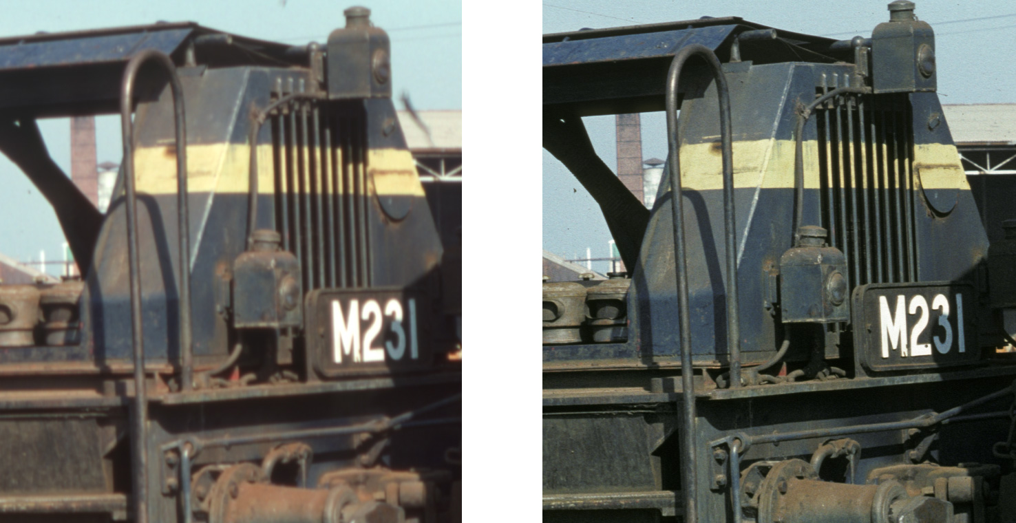

Here is a comparison I did between a Nikon Coolscan and a Epson V800 of the same slide. All settings/sizes were the same. I was not overly impressed with the Epson. Epson on the left.
Nov 15, 2004
139
8x10 Format
I agree, the Nikon scan looks significantly sharper. Hmm, maybe I'll focus on a dedicated 35mm film scanner to get started.
In my experience, its very difficult to get a usable scan from 35mm film using an Epson V series scanner. My results typically look like the example posted here. The flatter the film, the better your odds, but I have always had to apply careful sharpening to give the appearance of any real sharpness. My opinion is that the V750 I own is very poor for scanning the smaller formats.
Here's another bit of sharpening of the Epson scan. Of course, its' not the greatest but better than you did. You said the settings were the same between the two scanners. That's impossible. They're different scanners and the settings are handled differently. I do agree that flatbed scanners require a lot of sharpening and won;t equal the Nikon scanner.
markbau
Apr 16, 2009
867
Australia
Analog
Not impossible at all, same dpi/bit depth, image size/file size. Flatbeds cannot be as sharp as a scanner like a cool scan, especially when using the holders that lift the slide off the glass. Unmounted film that is pressed against the glass have a chance but mounted, no way.
Aug 29, 2017
9,262
New Jersey formerly NYC
Flatbed scanners are calibrated to focus above the glass for film scans and on the glass for reflective (photos and paper). That accounts for the film holder.
