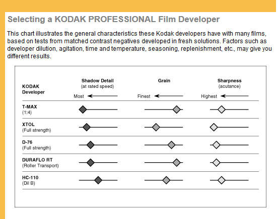

Replenished XTOL and here is why
attachment.php
