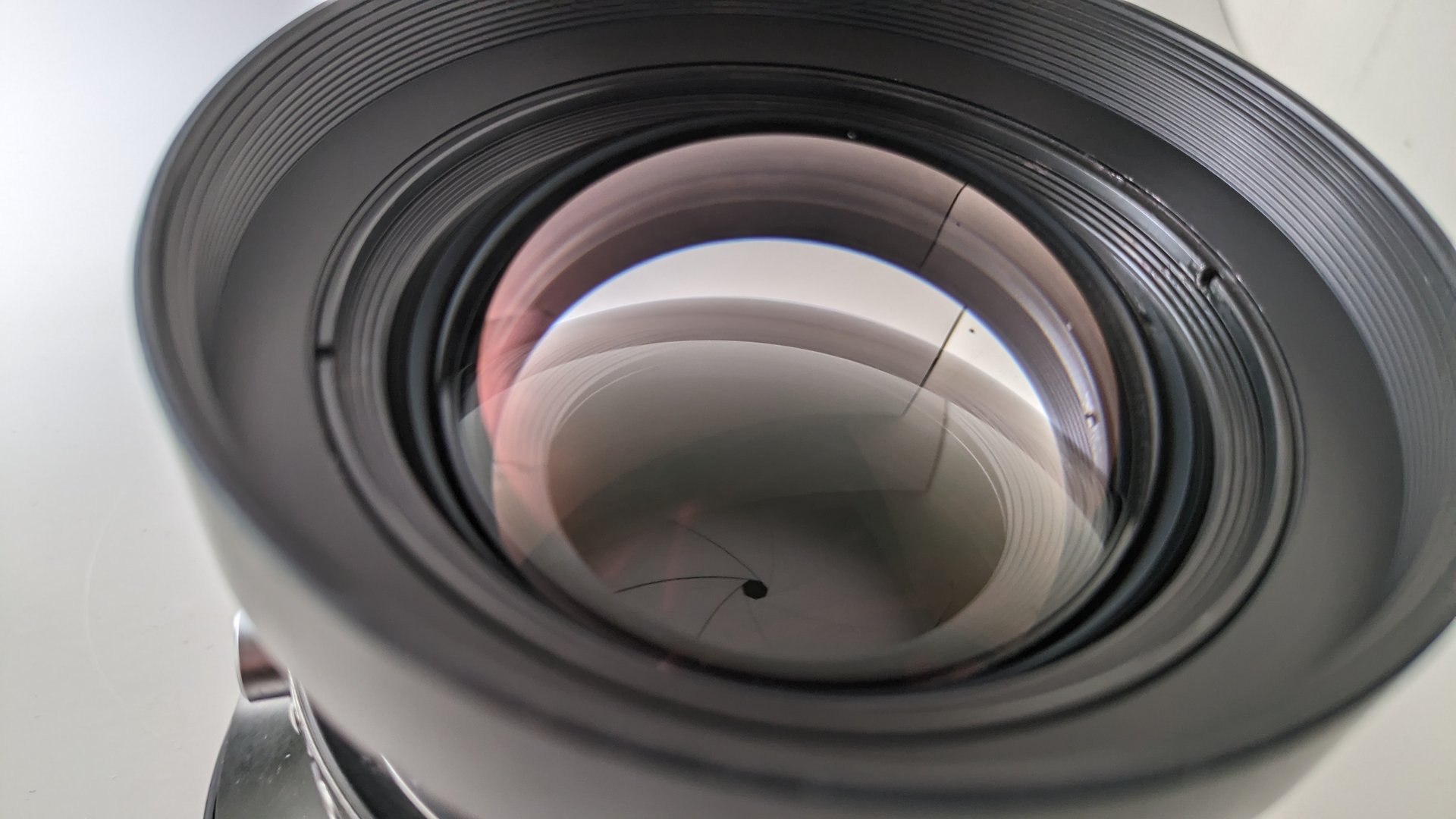

Hello everyone,
I'm looking for some information about a lens that I acquired a few months back. It was part of a collection that was given to me from a deceased relatives equipment.
The research I've done so far tells me that it is a Rodenstock 300mm Apo-sironar-W. According to the information I've gathered, it's a pretty rare and valuable lens. My knowledge about lenses and photography is limited. While I did talk a lot with my relative, I've never really done anything myself. With what I know, I'd say it's in very good condition. Everything seems to work fine, and all the mechanicals are smooth.
My questions are mainly about Value and the best way to go about selling it. If asking for a valuation isn't against the rules. I've had people tell me it's worth $500. I've also had people tell me it's worth $10,000. It seems like the people that are giving me the higher ranges, know a lot more about what the lens actually is. Many people have suggested to post about the lens here on Photrio, so here I am.
My goal is to sell the lens. I don't want to rip anyone off, myself included. With my limited knowledge about the lens, and lenses in general, I'm hoping to find a more concrete price for the lens. Finding more information from someone on how to fully inspect the lens would be great. I want to ensure I don't miss flaws or issues the lens may have.
Thank you.

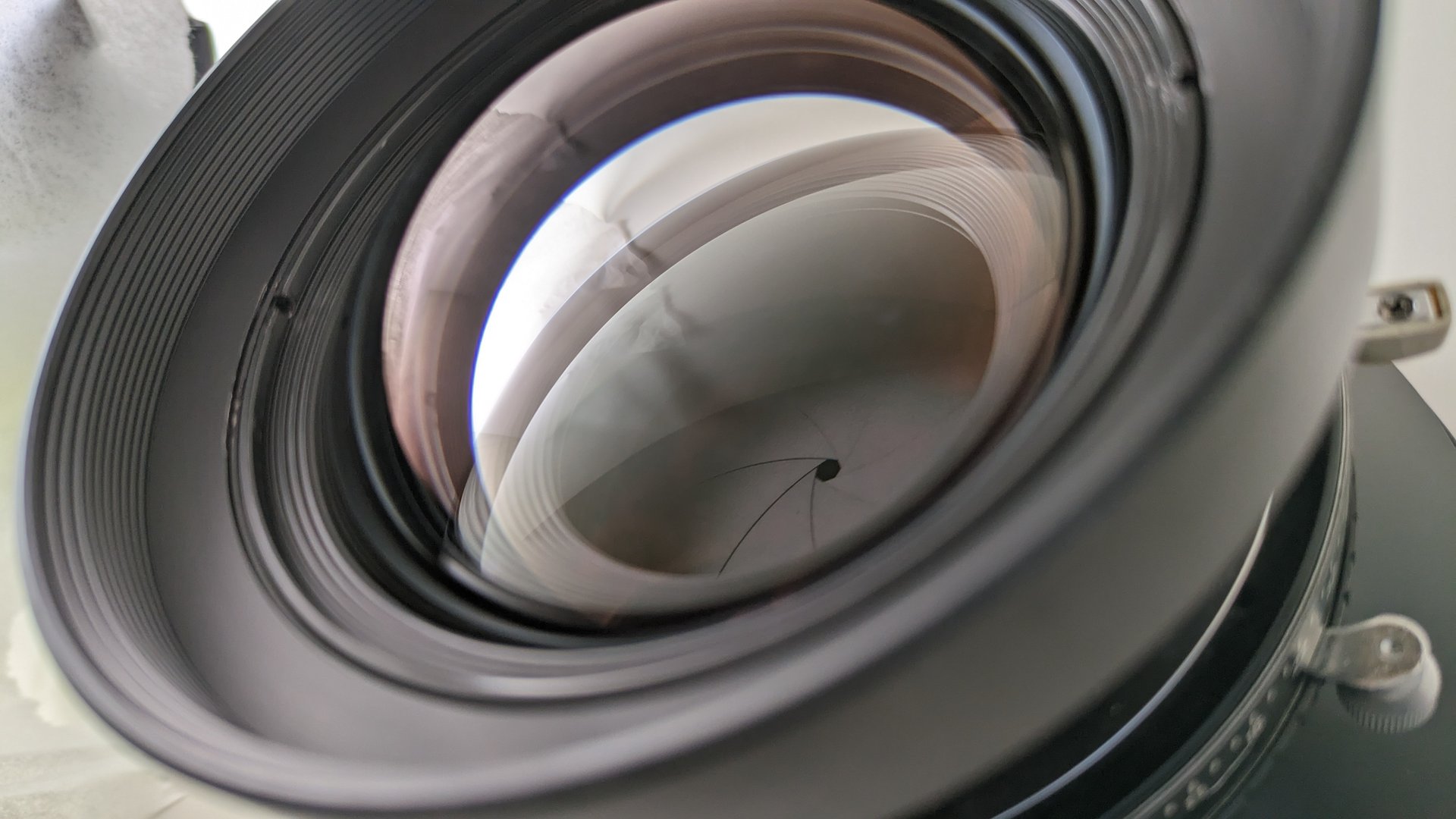

Dan Fromm
Mar 23, 2005
6,823
Hmm. Your photos show no Schneideritis but the second one shows what appears to be separation.
koraks
Nov 29, 2018
22,813
Europe
I don't see it, really. If you mean the magenta/orange shape to the left, that looks like a normal reflection on the lens coatings to me. The bubble-like shapes to the right would also be reflections of a specular light source. The glass looks really clean to me.
