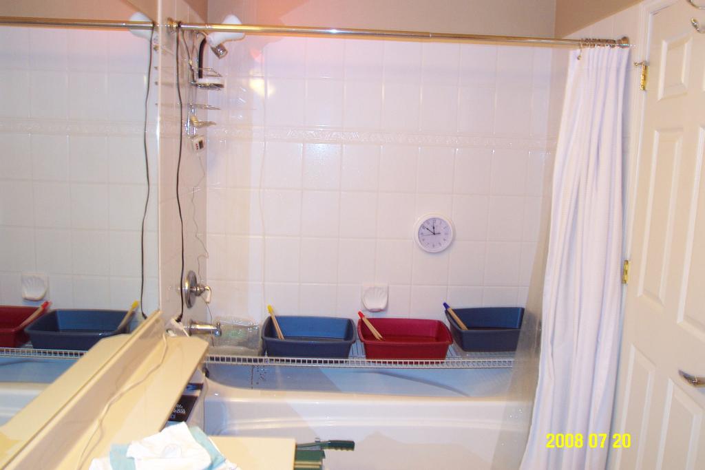

If you have access to one of the big box home improvement stores I'd suggest looking at their wired shelving for over the tub. It works better for me than plywood, and they'll cut it to size.
Here is a photo of my setup from a couple of years ago - since then I've replaced the trays with photo trays:

I agree with Matt, post your location. I live in West TN and you may be close to me. I am currently putting together a DR and when it's done will be open to those in the area that still shoot film and want to print instead of scan.
