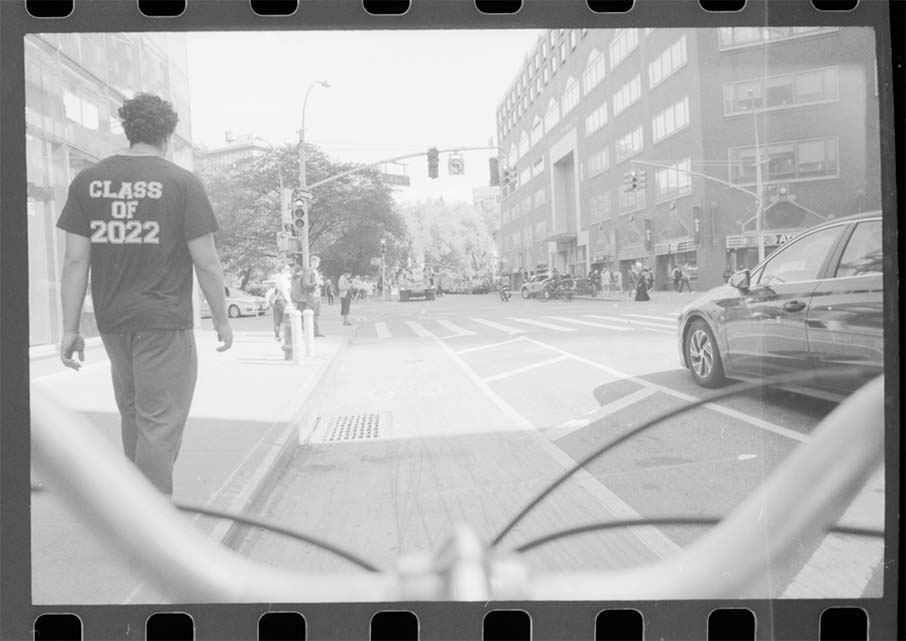

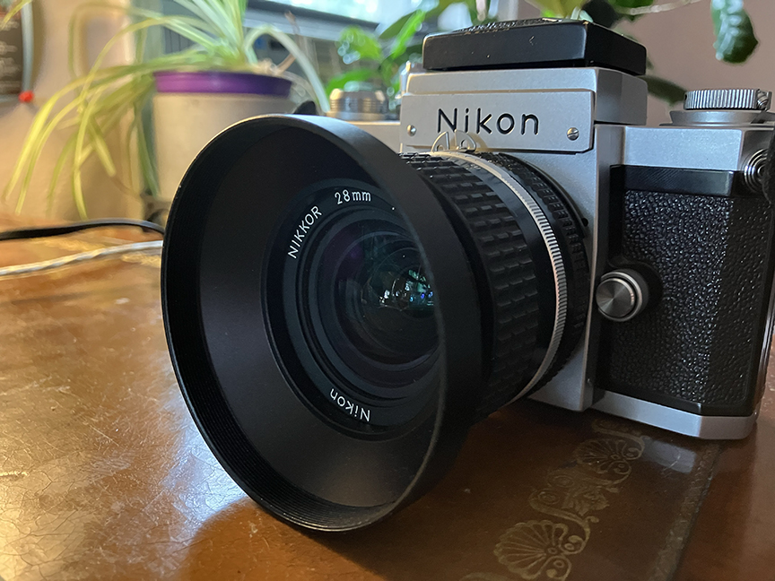

Please help me understand where this light flare is coming from? Using Nikon F1 and Nikkor 28mm lens
Camerarabbit
May 7, 2020
131
NYC
First pic is the cam I’m using

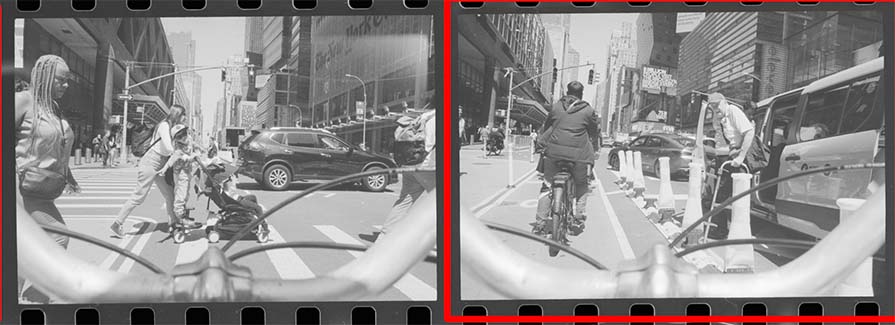

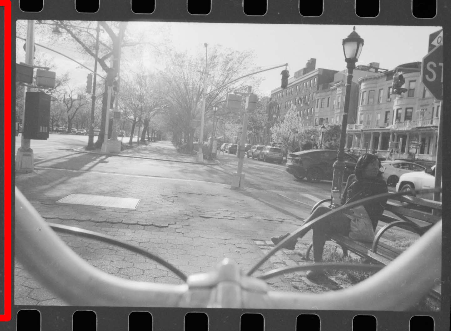

Second and third photo show the flare on the upper right-hand side of the photo - one image is a screenshot of a contact scan, you can see that the photo to the right has similar lighting conditions yet doesnt have the flare
Fourth photo is a shot that I took INTO the sun yet it doesnt exhibit this flare
I usually get this effect on 1-2 photos on a roll. In photo #2 and #3 I was backlit or the sun was coming from my right….maybe there’s a bright surface that’s creating the flare?

It's the sheet holding the negative folded over so I could fit it in the scanner

It appears to likely be caused by the back not sealing fully against the body, on the lower left side.
The back on the Nikon F does not use any foam seals, so look for any dented or damaged metal where the back and body meet together.
Awesome, thank you!
The light is not reaching the sprocket holes. Normally, when there's a leak in the back, the film gets hit when it's on the take-up spool. This doesn't look like that. It's a very rectangular outline, which makes the back a less likely source. I think it is cause by the wlf and the mirror is not completely sealing when it goes up. I'd examine that area.

I wonder if it could be from the waist level finder. Do you have a prism finder to make a comparison test?
Another thought, are there any shiny places in the mirror box?
FWIW, yes, that camera's model designation was simply "Nikon F". I don't think they realized at the time that they'd be building 2 through 6 F series cameras.
Take the camera into a dark room (unloaded of course), put the shutter on "B" and fire the camera, holding down on the shutter release or locking it ope with a cable release.
Now open your waist level viewfinder and shine a bright flashlight down into the VF from the top while looking inside the mirror box. You may have to rotate it around the top of the VF to simulate the moving sun.
You should be able to see any light leaks IF it is the VF.
