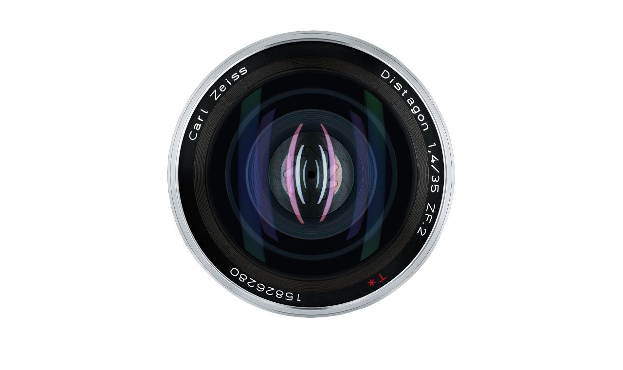

Aha I see your intention is exact on the classic Zeiss lens (I realy not noticed you mentioned "ZF")
BTW I can not remind that different letter codes well. Ok - but you ask about the dreamy softness of the Nikon AIS right ? Do you mean " deep of field sharpness " - there you can not compare with a lense F1,4 and a lens with F2.0.
But listen : The New Zeiss classic line serve F 1.4/35mm !

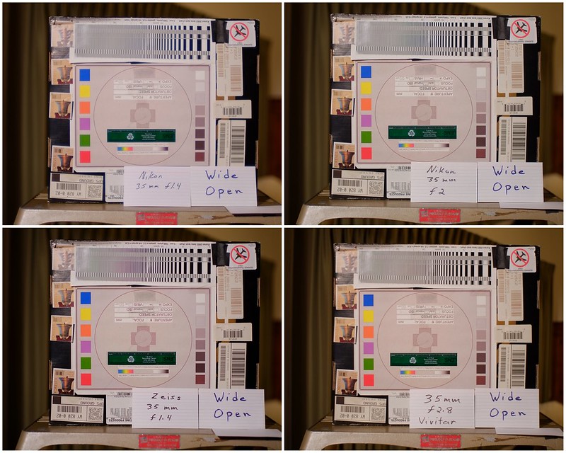

Just curious (I am considering an M42 35mm also), where does the Vivitar 35mm f/2.8 fit in?
I had been using all of them at f/8 but I needed to determine which was better at a faster aperture. Therefore, I tested all of them with a wide open aperture. Camera was tripod mounted, 2-second self-timer was used to trip shutter, light source was continuous tungsten, white balance was tungsten, and exposure was set manually.
Wide open, all images were acceptable; however, the Zeiss was the best and the Vivitar was the worst.
35mm lens test
by Narsuitus, on Flickr
