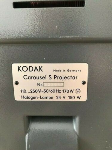

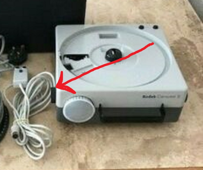

I hope this is posted in the right place.
I purchased this item on ebay (if you scroll down you can see the photos) for my dad in his 70s who has wedding pics from 1966 he wants to view.
It's a Kodak Carousel S projector.
The remote control works to change the slides, but won't focus, and there's no easy way (or obvious to us) to manually focus.
Is there a replacement remote control I should buy - if so, what type? And from where? (I'm in the UK, so any UK spots first would be great)
Is there a way to manually focus it? If so - how?
Any and all help appreciated, the ebay seller bought from someone else and has now admitted they don't actually know how the thing works - they simply copied what the original seller had published and I don't know who the original seller is.
Thanks in advance!

I had a Kodak Ektagraphic carousel projector that had a remote control. You could select specific slide plus all the other remote functions. Maybe you can find a remote that would work for your purposes under that name. Good luck.
Kino
Jan 20, 2006
7,625
Orange, Virginia
The knob on the side next to the lens is for manual focusing. If it is frozen or very hard to turn due to petrified grease, the remote will not work.
DO NOT SHOOT A BUNCH OF LUBRICANT UP INTO THE PROJECTOR!
It should be carefully disassembled and serviced if you want to use it.

I don't think you get it. If the manual focus knob on the side is frozen or very stiff, no amount of replacement remotes will solve your problem.
The focus motor is very small and weak; if you keep trying to focus it, you may burn out the motor if the lens is stuck.
This is probably not an electronics issue if the lens will not move at all, but a mechanical issue.
BTW: I think this is the manual for your projector: https://www.manualslib.com/manual/979747/Kodak-Carousel-S-Av1000.html

Hey Peter - a quick question if you had the S model - how do you manually focus it?
My dad says there are only two knobs on either side but they only adjust the feet to raise or lower it, he said there is no manual focus knob. It's driving us mad!

You both are referring to the US-made projectors. The OP though has it on the german-made range of projectors.
Looks like a manual focus knob to me; that's why I suggested what I did...
Maybe there is something on the bottom of the unit that would allow you to rack the lens in and out? But then again...

That knob, as its counterpart on the opposite side, is for adjusting the image elevation.
Manul focusing is done by twisting the lens barrel.
Remote focusing is done by the remote control (even at the plain-S model).

I found a YouTube video showing how it works:
Unfortunately, they only show remote control focusing. It appears on this video that the lens focuses by moving in and out without any rotation. Can the projector be focused by pushing and pulling on the lens?
It is a very sleek projector. I hope you can get it working.
The site linked to above by Kino does offer a downloadable manual for your projector for 4.99 euros. It may be a worthwhile purchase. It is hard to imagine a projector designed to only be focusable by remote control.

Thank you for your help!
I hadn't thought about pushing / pulling, so will ask dad to give that a try instead of rotating. I also noticed that it didn't rotate.
I think 4.99 for the manual is worth a chance! Thanks @Kino for the link to that!

In general such projectors are manually focused by means of a cage with a helicoid housing the lens. This cage then again is moved by an electric motor for remote or for automatic focusing.

I twisted the lens!
perkeleellinen
Apr 14, 2008
2,899
Warwickshire
The lens screws into the body, only a few turns. You just need to turn it back out a little to get into focus. If it needs to go the other way and it's at the end of its screw then I think you need to move the projector and screen further apart.

Yes, based on the photo of the lens shown in #17 it has threads all the way around the body so the whole lens rotates to focus. The US models have a keyed rack driven by a gear from a knob on the side (they go straight in and out).
