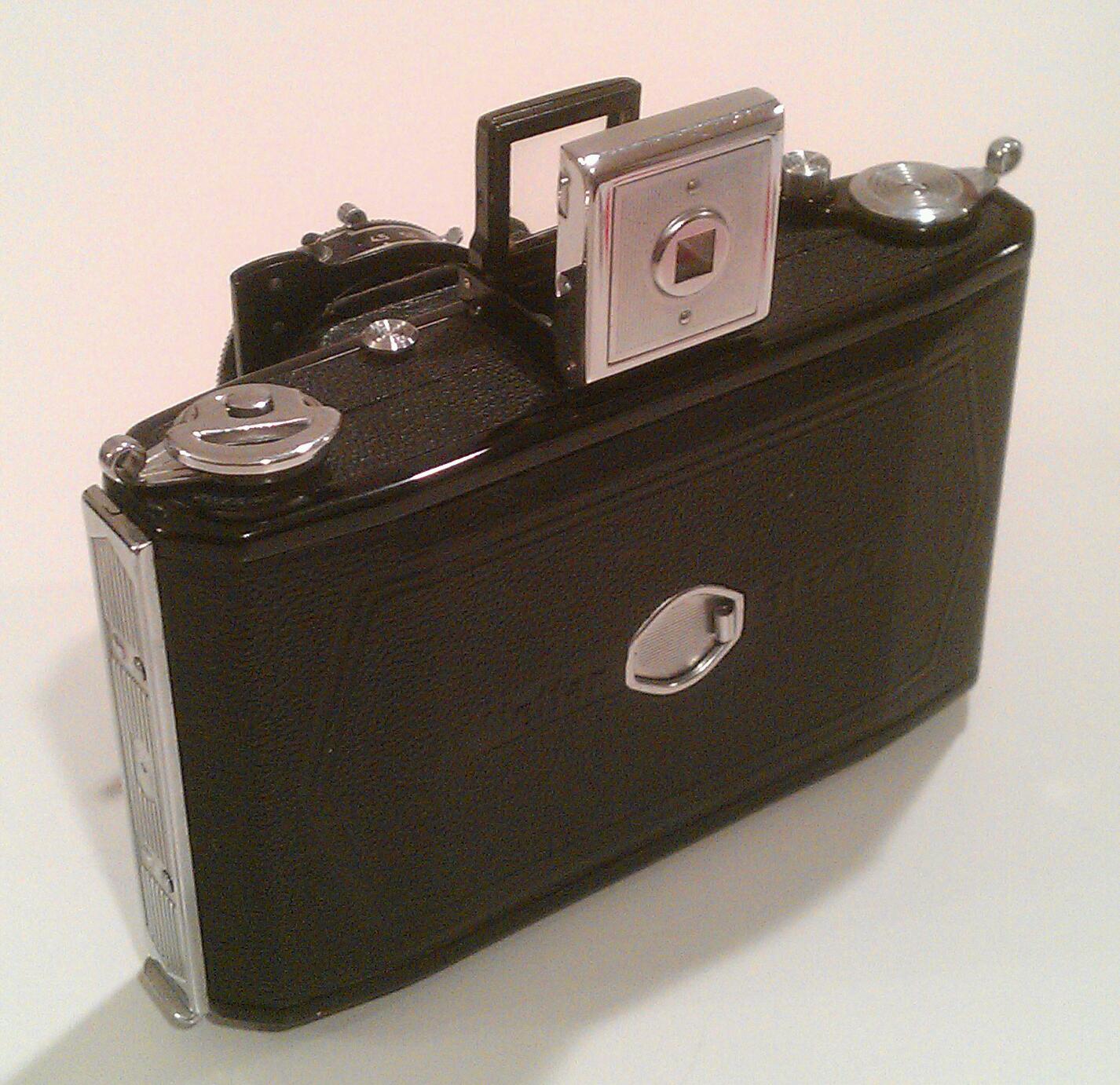

For those of you owning old folders that have frame spacing issues with modern films, I have a tip for you. For years, I have taped short pieces of old backing paper to the start of modern 120 film rolls to resolve the frame spacing issue I had with my Zeiss Super Ikonta III. It worked just fine, but was always a bit of a pain in the field.
I had read that the backing paper on Shanghai GP3 film was thicker than other films and, in fact, it presented a bit of an issue (tight winding) in my Hassey backs. So, I tried a roll (no funny tricks to prepare the film) in my Zeiss folder, and... Perfectly spaced frames!! :smile: Man, am I a happy camper about that. Give it a try in yours.

With my Perkeo II you use the red window to set the first frame. You then flip a little lever and it auto indexes from there. The sensing is a roller the film runs over on its way to the film gate so it is (or should be) independent of film spool diameter. It seems to work pretty well (and can put 13 6x6 shots on a 120 roll!) (We're talking circa 1952 "Hi Tech" here!)

I tried that with my Super Ikonta III and it didn't quite do it. The best solutions I found were 1) tape about a 3" length of old backing paper to the beginning of the roll and feed that onto the take-up spool along with the film paper, or 2) wrap a layer of masking tape around an empty spool and cut a slot for the film leader. The point in my original post is that with Shanghai GP3 film you may just be able to work normally. Of course, this doesn't help with other emulsion you may wish to use. :wink:
