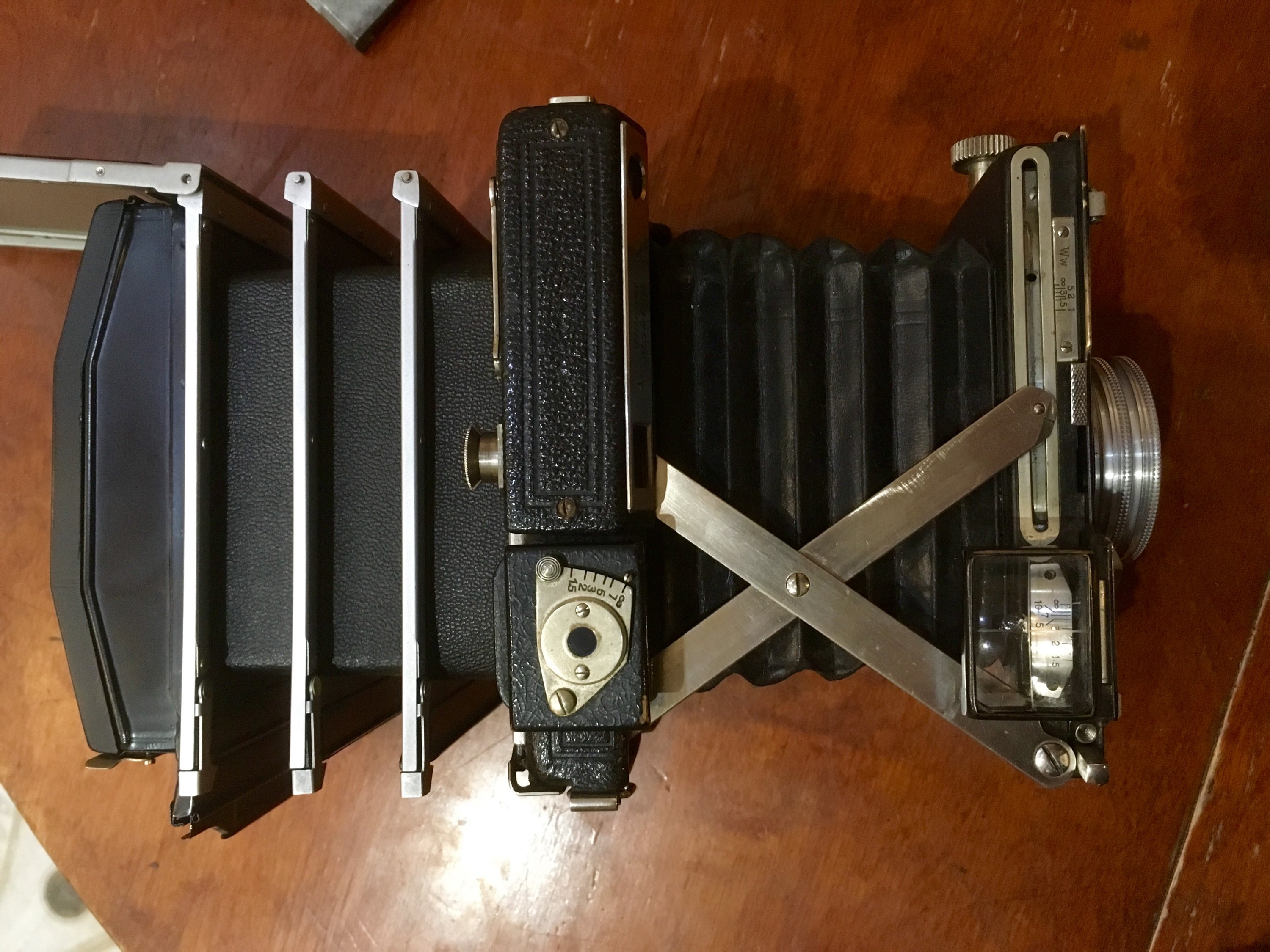

When the owner of a Medalist II with loads of accessories meet Makina II.
Three unit extensions plus groung glass with Rada 6x9 roll film holder and Series VI adapter as push-in in the front lens, I wonder how is going to be with the Telek lenses :smile:

Hi,
Did the Medalist spacers just slide right in on the Makina back? Makina holders have a "Makina Groove" down the sides. Its actually just a flat lip that sticks out a little bit, so I would not have thought that smooth flat sided Medalist holders would fit?
Robert
Alex Varas
Alex Varas
Mar 24, 2018
806
Bilbao
Well I cheated to make them fit, the Makina II has two small screws at the left part of the rails where the film holder and ground grass should go.
That's why Makina holders fit and I guess others they don't. These two screws can be taken out a bit to let the Medalist spacers to fit in completely.
The lower screw is easy to access but the upper you need to remove the rangefinder cover to access it easly.
Once you adjust the Medalist spacer then you adjust the two screws back to the new position to help the apacer to fit well.
I hope that I understood your question and it's answered, later I will try to make a photo and upload it.

Thanks, I think I understand. Those rails would then have to be adjusted back to the starting position if you later want to use Makina holders right?

Yes I think so, good for me I have only the Rada roll film holder and the Medalist extension backs.
