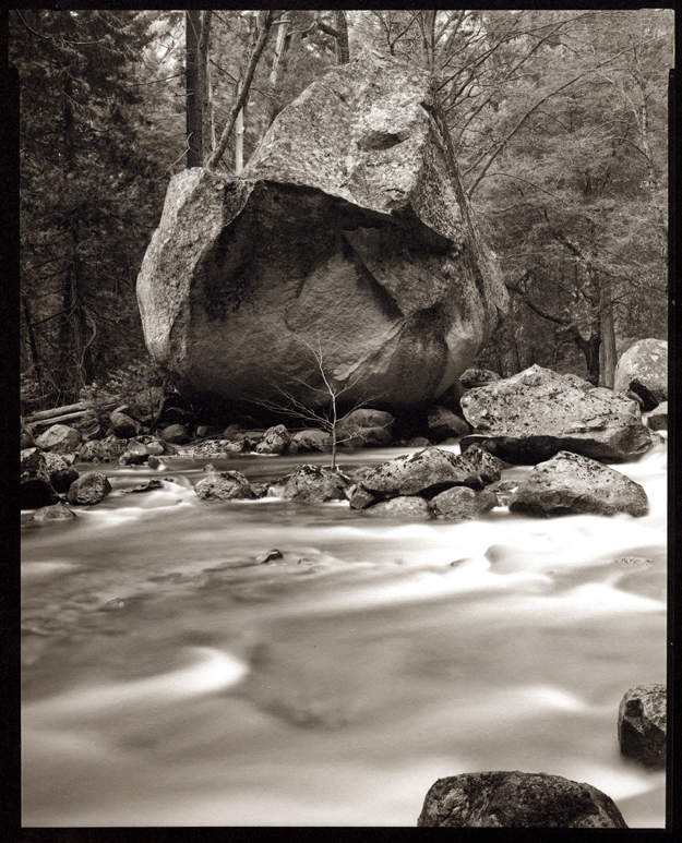

Fortunately, my humidity stays around 60% (plus or minus 10%) most of the time and I do not worry about humidity when making develop-out pt/pd prints (and printing from in-camera negatives). Example below; Yosemite Valley, 8x10, palladium to platinum ratio about 2 to 1, warm Potassium oxalate developer).
