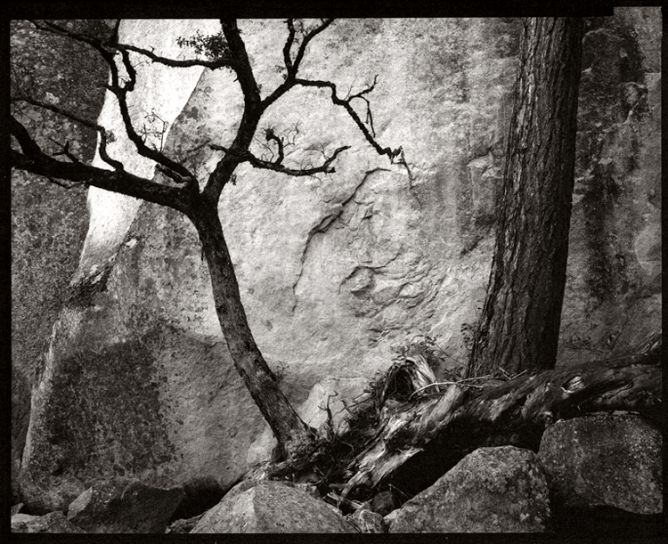

Below: 8x10 platinum/palladium print (no contrast agent used). The image looks a little more contrasty on my screen than in reality.

Never printed platinum prints before, but that's a gorgeous print Vaughn!
