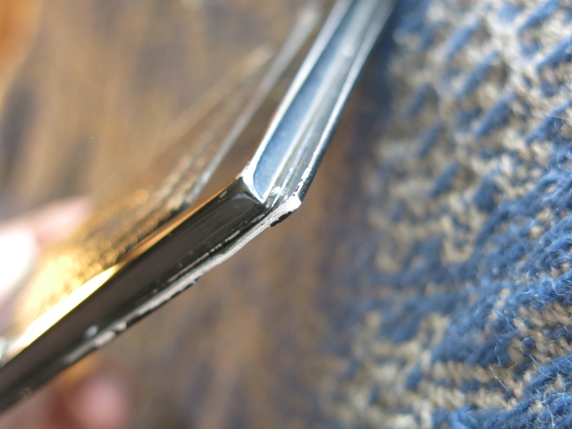

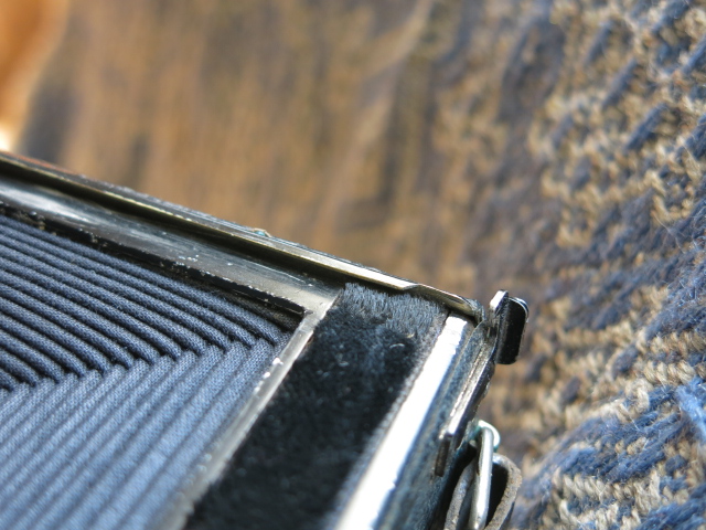

Here is the edge of the groundglass holder and the entrance of the slot:

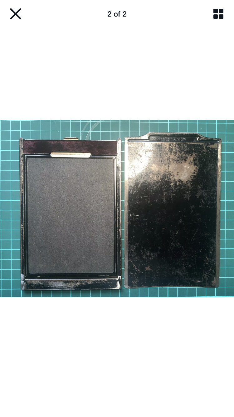

There are plenty of 9x12 plate holders on ebay. They are thin and hold one plate each, and made from steel.
When you look, make sure they are for your voigtlander (you’ll have to do some research and look carefully at pics)

Your Avus uses the single edge slide-in type. There was a page around somewhere (which I don't have bookmarked) that gave a run-down of the (roundly a dozen) different plate holder styles made during the plate camera era (roughly 1890 to 1940). If you post in the Plate Camera forum here you're likely to find someone who has the link.
The point of that being, it will tell you what other brands of plate holders will work in your Avus.

Thanks! The slot in the bottom of the focus screen holder is only 1.5mm. Maybe the original ground glass was even thinner than 1.5mm? But I think I will get 1.5mm into it.
I will send you a PM.
I took some detail pictures of the screen holder and aim to make a separate posting outside Classifieds, for general interest.

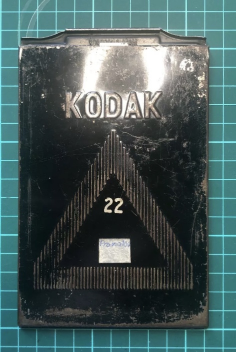

If not, I have a Voigtlander plate/film holder, 3 Kodak plate/film holders, a Voigtlander film pack back (with film still in it!), an Avus ground glass back (with broken ground glass), and an aftermarket ground glass adapter back to take standard 3x4 double-sided film holders, plus some film holders...
