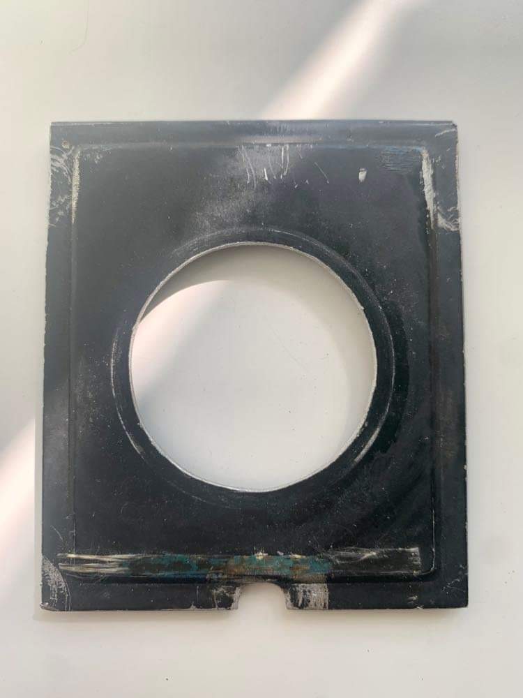

Most plate cameras has fixed lenses.
Some has bayonet for lens interchageability.
Question is - does some of them has lens boards?
I just buoght zeiss Protar VII on tiny lens board, which seem made in plate camera style.

Could you possibly post a photo of the plate?

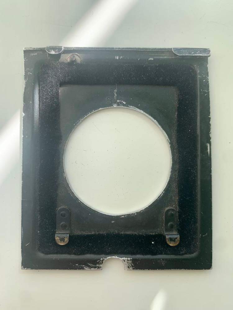

This lens panel no doubt is to an old Ernemann platecamera. As I'm not an expert in Ernemann cameras I cannot tell you precisely which one. But it's from an Ernemann.
Another old german maker of platecameras with changeable lens panels was Rietzschel in Munic (München).

Thank you very much.
With Ica on possesion I somehow overlooked Ernemann.
It seems they built 13x18 too.
FL of the attached lens was ~ 180 mm.

It's not correct to say that most plate cameras have fixed lenses. Very few had a bayonet lens inter changeability.
In this case it's a metal bodied camera most probably German and very few [re-WWII took lens boards, so it should be easy to identify.

With a focal length of 180mm and being a (convertible) Protar, the cutout would be abt. 45mm, and for a 13x18 cm camera a width of the lens panel of abt. 90 mm would seem abt right.
