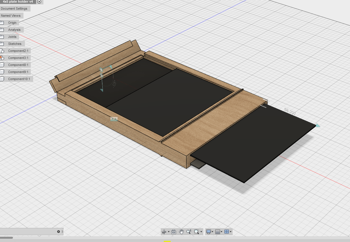

Speaking of new plate holders ..
(Still a work in progress)
