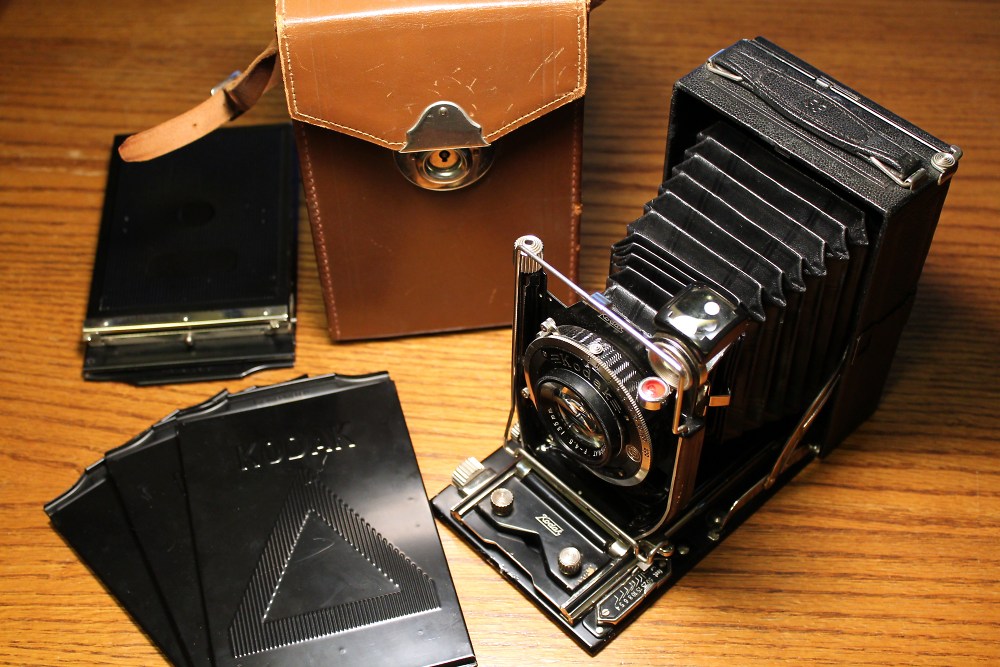

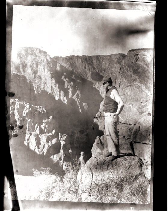

So, to make a short story long . . . I purchased a Kodak Recomar 33 outfit the other day. It came from San Antonio, TX (not NM). When it arrived I immediately noticed that the film pack holder appeared to be loaded (Plus X), and that 11 of the 12 tabs had been pulled. Tab No. 12 had not been pulled. I was really curious if the negatives were still within the holder, and even more curious if so, then could they be developed to reveal something. After opening the film pack I found the negatives were still there. I developed No. 12 to no avail. Nothing was discernible. Then I developed No. 11 . . . . Yipeee! "Houston, we have a negative". Albeit weak, there was a visible image. So, after scanning that negative, and some tweaking, we now have a positive image. I just wanted to share.
The camera was something I have desired for many years. Partly because I love using plate cameras. And partly for "nostalgia", as from the information I have garnered about this camera, they were only produced between Dec '31 and '39-'40 (Kodak AG, Stuttgart). The original booklet that came with the camera was printed 8-36 which gives a possible four-year window when the camera was probably made. Hitler was Chancellor of Germany during that time. I just find that fascinating. The serial of this camera is 962300 if anyone could pinpoint the actual date of manufacture.

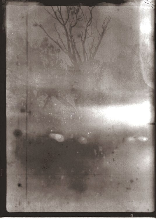

So, here are images from negatives No. 9 and No. 8. I have maintained the contrast of the images low enough to reveal as much detail as possible. These negatives are incredibly thin. I'm still somewhat surprised what detail can be extracted. Just looking at them, you'ld think there was nothing there. It takes approx. 20 minutes to develop one negative at a time, so I'm taking my time with this project. Only seven more negatives to go.
The negative we're working with here are 8.5cm x 12.5cm.

I think this is totally awesome. I love finding exposed film in an old camera then developing it to see what was there. Often I develop to nothing but once in a while something magically appears opening a window to an important moment in the past for someone...somewhere...sometime.
Your camera is gorgeous and the print of the man overlooking the valley came out surprisingly well.

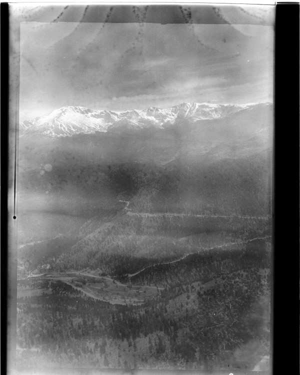

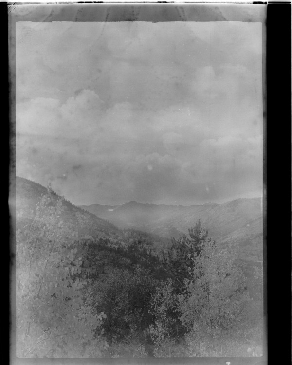

Images from Negatives No. 7 and No. 6.

I wonder where the photos were made? To my eye, it doesn't look to be Oklahoma or Texas.
DannL.
Oct 13, 2013
617
My best guess would have to be Colorado. I have been in touch with the person that sold me the camera. They said that they are in contact with the original owners. They may be able to shed some light on the question. If these exposures are from the 1950's as I surmise, this would be a good example of the longevity of the latent image.

Being able to see these images so far into the future from when they were made is astonishing. No doubt the camera and film were not stored in ideal conditions.
Image #6 should be recognizable to people familiar with that area, it is so distinctive.

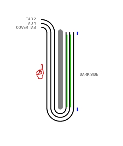

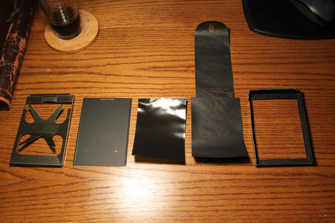

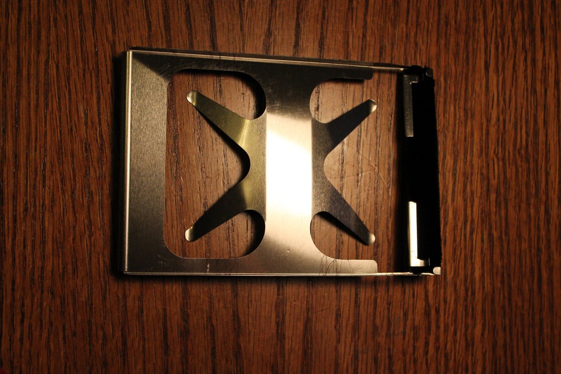

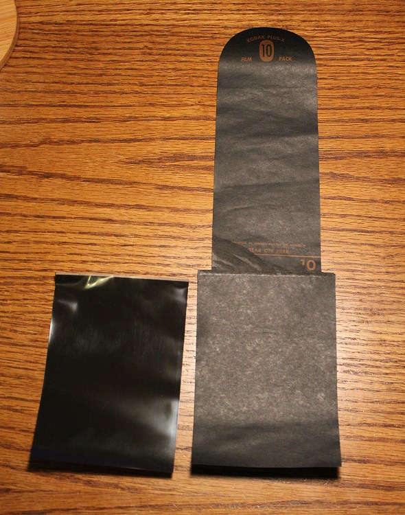

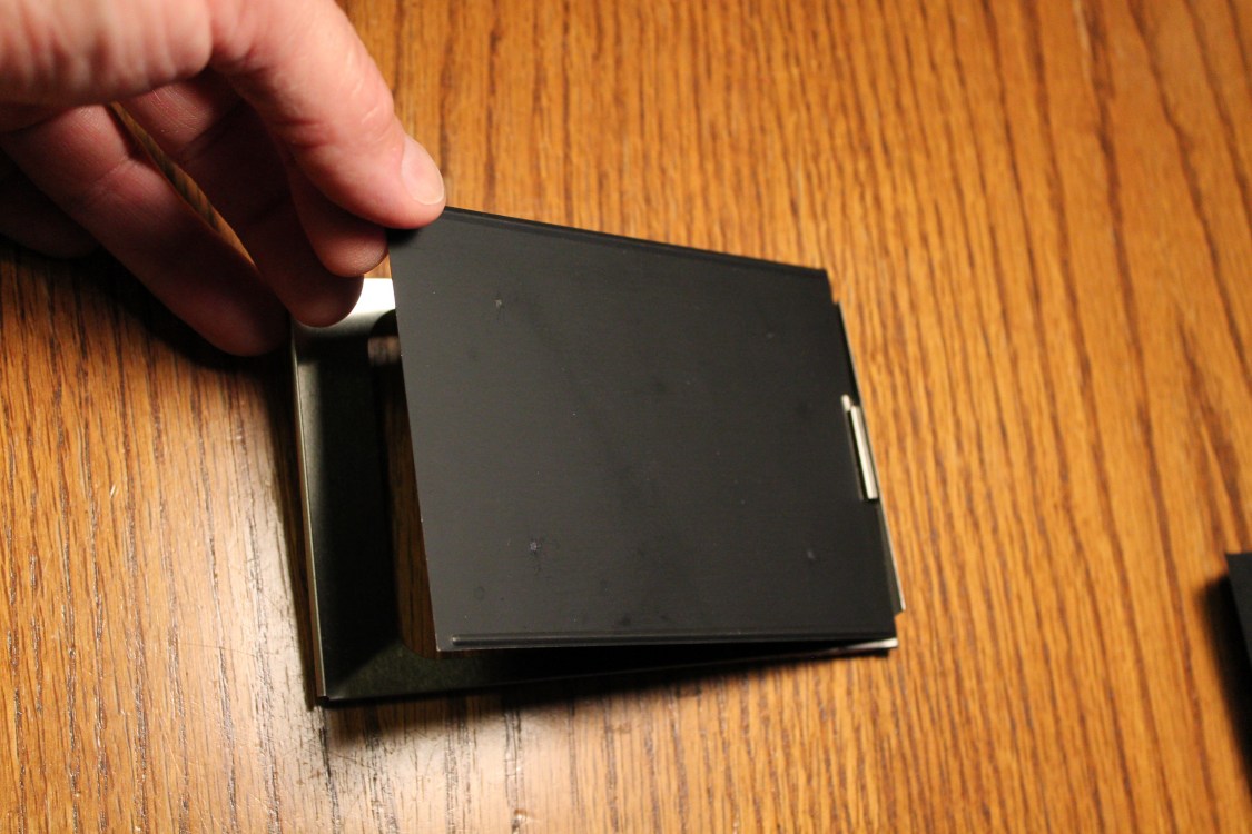

Excellent question. Here's a series of images of the parts from this film pack. It appears that the internet is void of this information for the most part.
I think my drawing probably explains it well enough. Let me know. One part that is missing is the back of the film pack box. I have included the window side of the box in the parts picture. In the drawing I only drew two tabs that have film attached (green). There are twelve tabs with film, in the pack.
The basic parts.
The Backing Plate attached to the Spring Thing.
The film as it would appear when attached to the pull tab.
A drawing of how this all works.

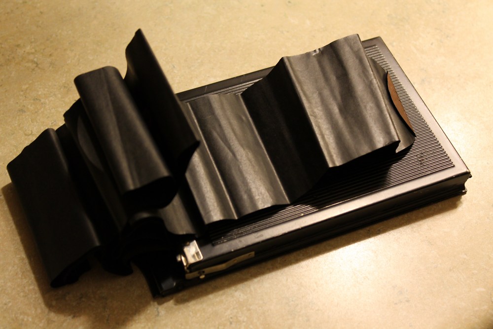

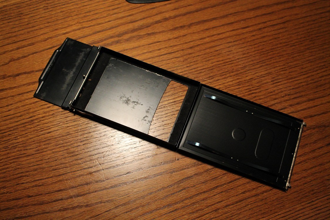

Extra images . . .
The film pack holder with dark side partially open.
The Spring Thing (front and back). Note the black light-trap felt at one end.
The film detached from the pull tab.

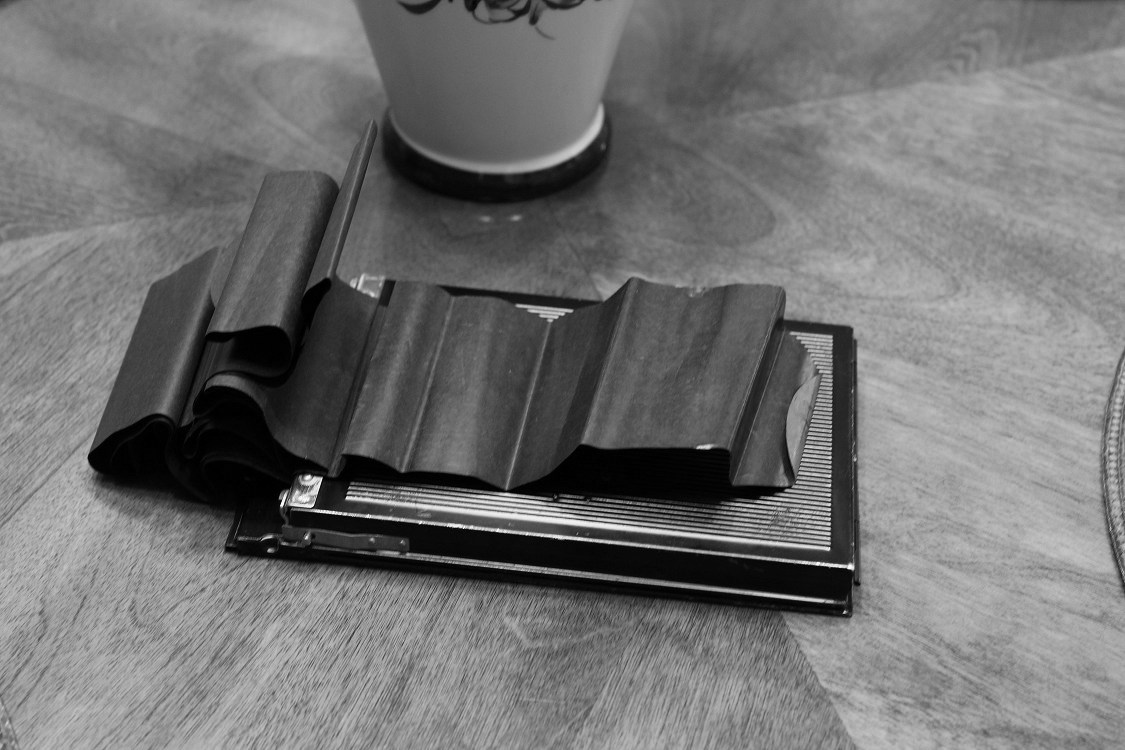

Once all the tabs have been pulled, this is what the film pack holder should look like. Of course there is the possibility that some camera operators may rip the tabs off.
