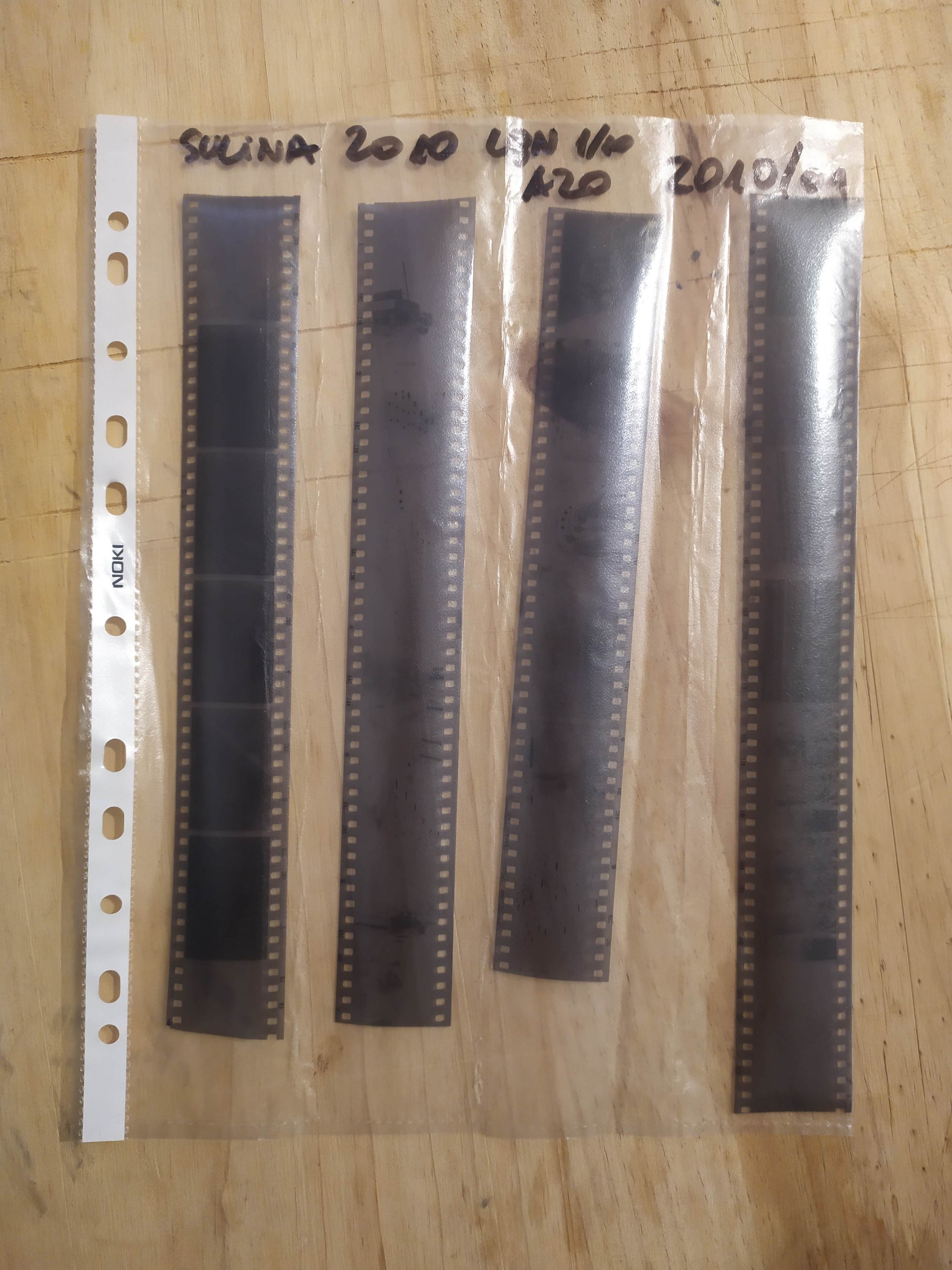

Hi everyone! For years when I was younger, I was making my own plastic negative film sheets from the tipycal A4 office plastic ones. My question is: this plastic affects the negative in time?
Thank you very much!

What are "typical" office envelopes?
There were at least PVC and PP ones. The PVC ones due to them containing pasticizer affected Xerocopies, making the text stick to the envelope.
In general envelopes containing plasticers are rejected by archivists for storing film. (However most films contain a plasticizer themselves... but this is another issue...)

Polyester, polyethylene and polypropylene are all suitable for archival storage. If your A4 sleeves are any of these, everything is fine. When I lived in Europe, one could get both polyethylene and vinyl sleeves (PVC - polyvinylchloride). The latter aren't so good for long-term storage. The ones you picture seem to be the stiffer, clearer polyethylene ones, but check the packaging. Polypropylene is alright, but can create more static.

Wow! Thank you everyone for the answers, I have been traveling since I open the threat, so many answers!
So, from what I understand most of the plastics are ok, minus pvc. I looked at the sheet doesn t say what they are made from.. I looked on internet for any info by the sheets name - "noki" - but no luck. Any ideea how to figure it out?
What s the worse can hapent to the negs? To get sticked to the sheet?

I have negs stored in Print File sleeves that are perfect 40 years on. I have negs stored in lined thin cardboard sleeves that are also fine 50 years on. You do realize that when you pass, your negatives will likely end up in the trash, eh?

Definitely NO to anything PVC, vinyl. Then the risk of even appropriate plastics ferrotyping film or getting stuck to it if smooth has been brought up; and it's a real issue. I went to textured mylar sleeves; but those do interject a bit of frostiness if you're trying to view your images on a lightbox in those sleeves. Then I switched to archival paper sleeves without plastic at all. Albums are a compromise because the covers themselves might contain bad ingredients - so one more thing to research in advance. Let's just say I've seen a lot of film ruined in albums. You also need to think about trapped humidity, perhaps the worst culprit of all. Therefore when someone states that they haven't had any trouble at all with this or that in their particular climate or storage conditions, that kind of generic advice might completely backfire under somewhat different circumstances. But I do recommend shopping for supplies at a place like Archival Methods.
