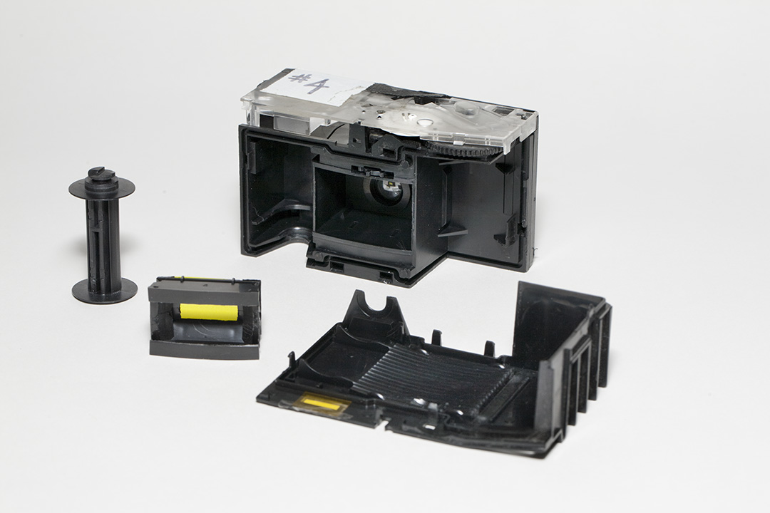

I have been shooting with a modified Kodak "Fun Saver Panoramic 35" disposable camera since 1992. I reload the camera in the darkroom or in the field with a changing tent as the 35mm film needs to be pulled from the cassette onto the take-up reel. So, when you advance the film it's being pulled back into the cassette. I shoot Kodak Tri-X film most of the time. I like how the old school grain paired with the cameras two element 25mm f=12 plastic lens looks. I have also shoot some out dated C-41 film with mixed results. Check out my website, direct link to my plastic panorama images as well as the three portfolios below this one.

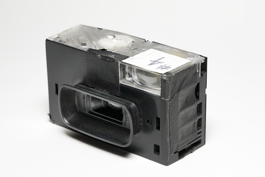

This is what it looks like after I reload it. Note the tape, this almost eliminates light leaks...

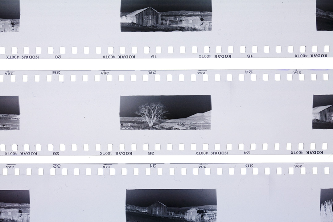

The mask in the above image was modified with a file to create an organic rebate edge. This is a page of negatives from the camera. I shoot every other image to keep the frames apart. This facilitates an easier experience with negative carriers or scan beds. I load TX-135-36 and get 15 to 18 images per roll.

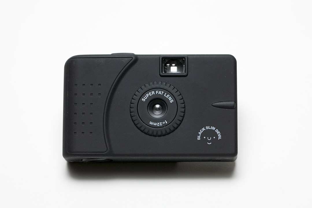

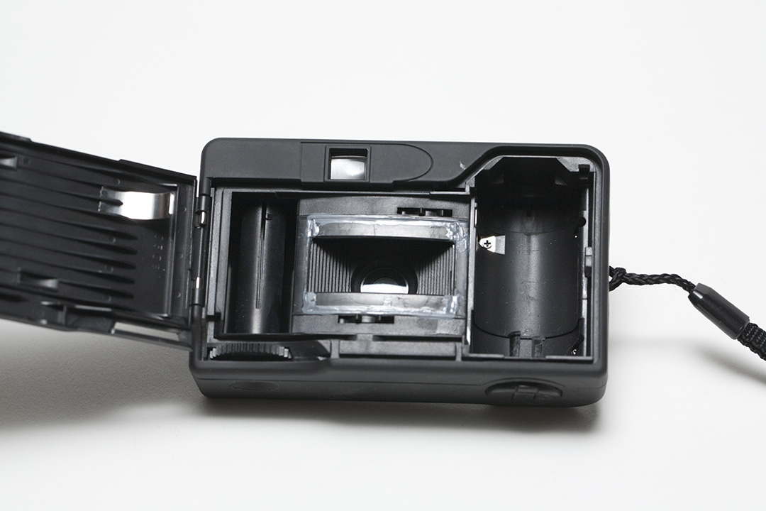

I have tried several different cameras to create the panoramic image. Most are total crap. But this camera the "Black Slim Devil", "Eximus Wide & Slim" or "Vivitar Wide & Slim" (all the same camera). It has a 22mm plastic lens of similar quality to the Kodak disposable. To make it panoramic I glued in the mask from a Kodak panoramic into the wide & slim.
