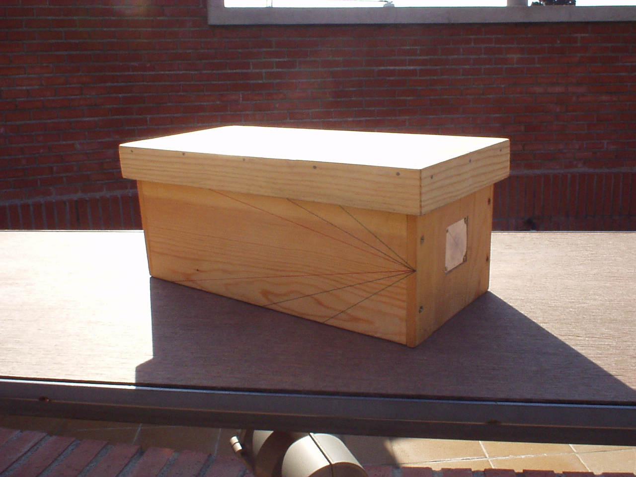

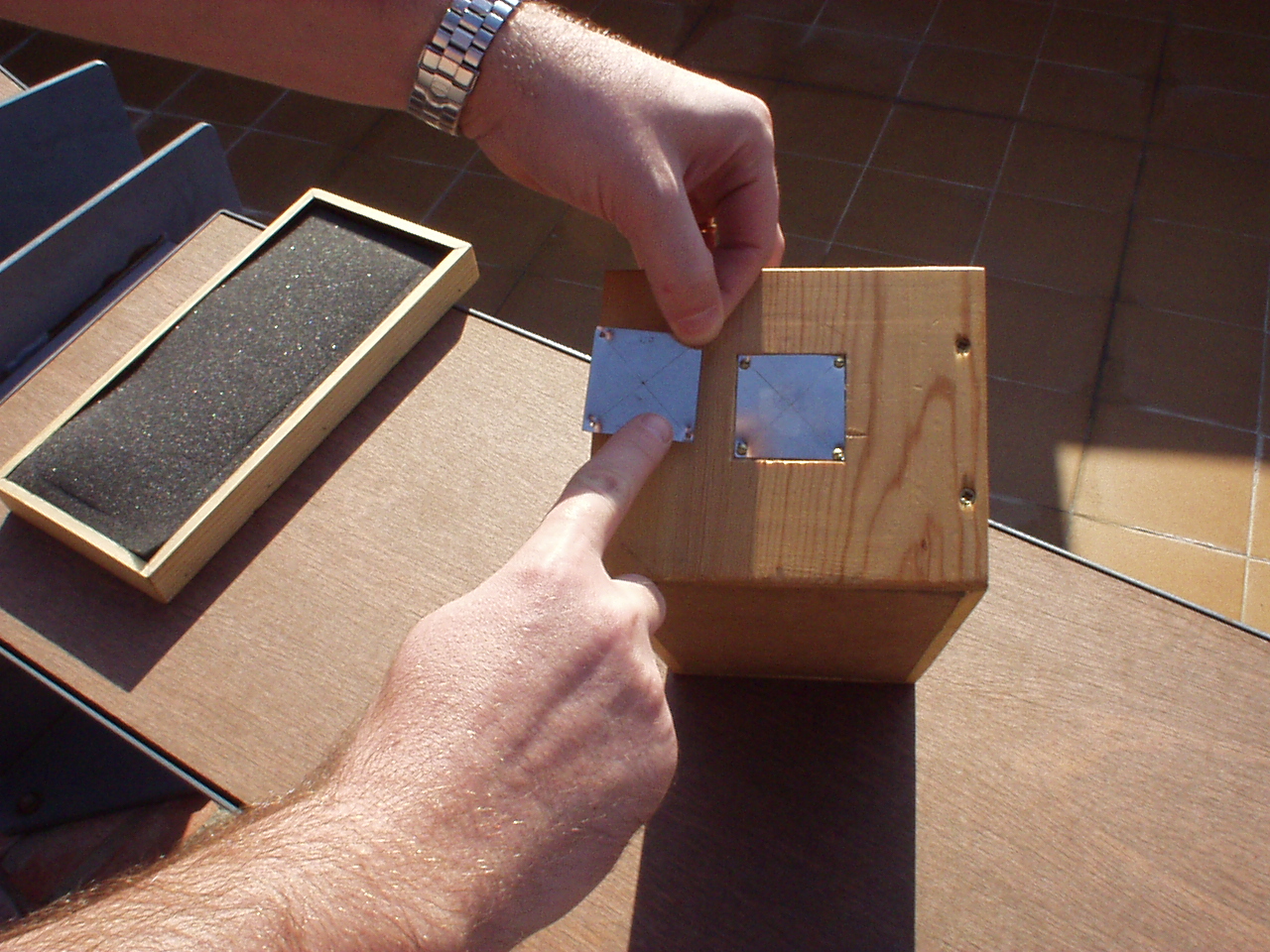

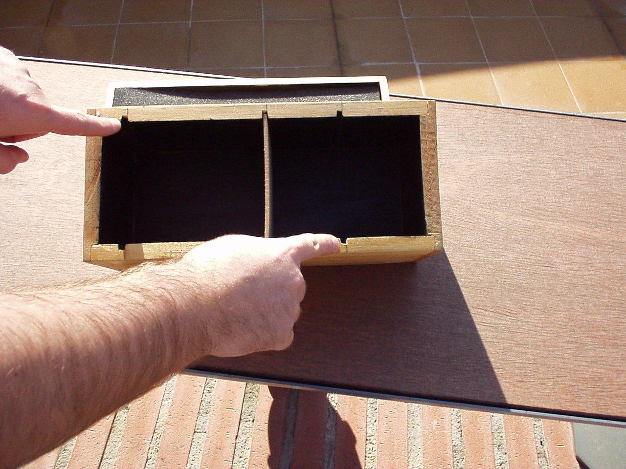

yes, I did!!! I made my own pinhole, being able to use (o the same camera) 3 diferent focal distances (wide, normal and tele) just puting the paper near the hole, in the midle or at the back. It worked very well and it was a great discovering for me.
I post some photos about it:
- General external view of the camera
- Interior (Inside) the camera. Here you can view the 3 diferent placements where you can put the paper and get a wide, normal or tele camera.
- Stenopo (the hole) that also can be changed to acomodate the diferent focal lengths if necessary.
The drwbacks (for me and my camera dessign) are:
1. Just can play one shot, then you need to go at dark to change the paper.
2. So many long times. Paper has very low sensivity (maybe 3 ASA?)
3. Too big to transport. Really, isn't so big but ... it's like a shoe box.
