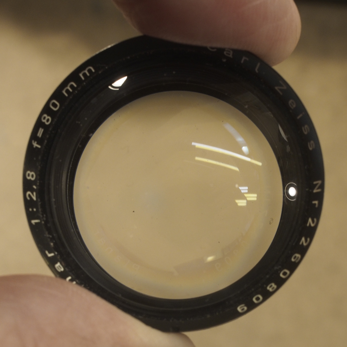

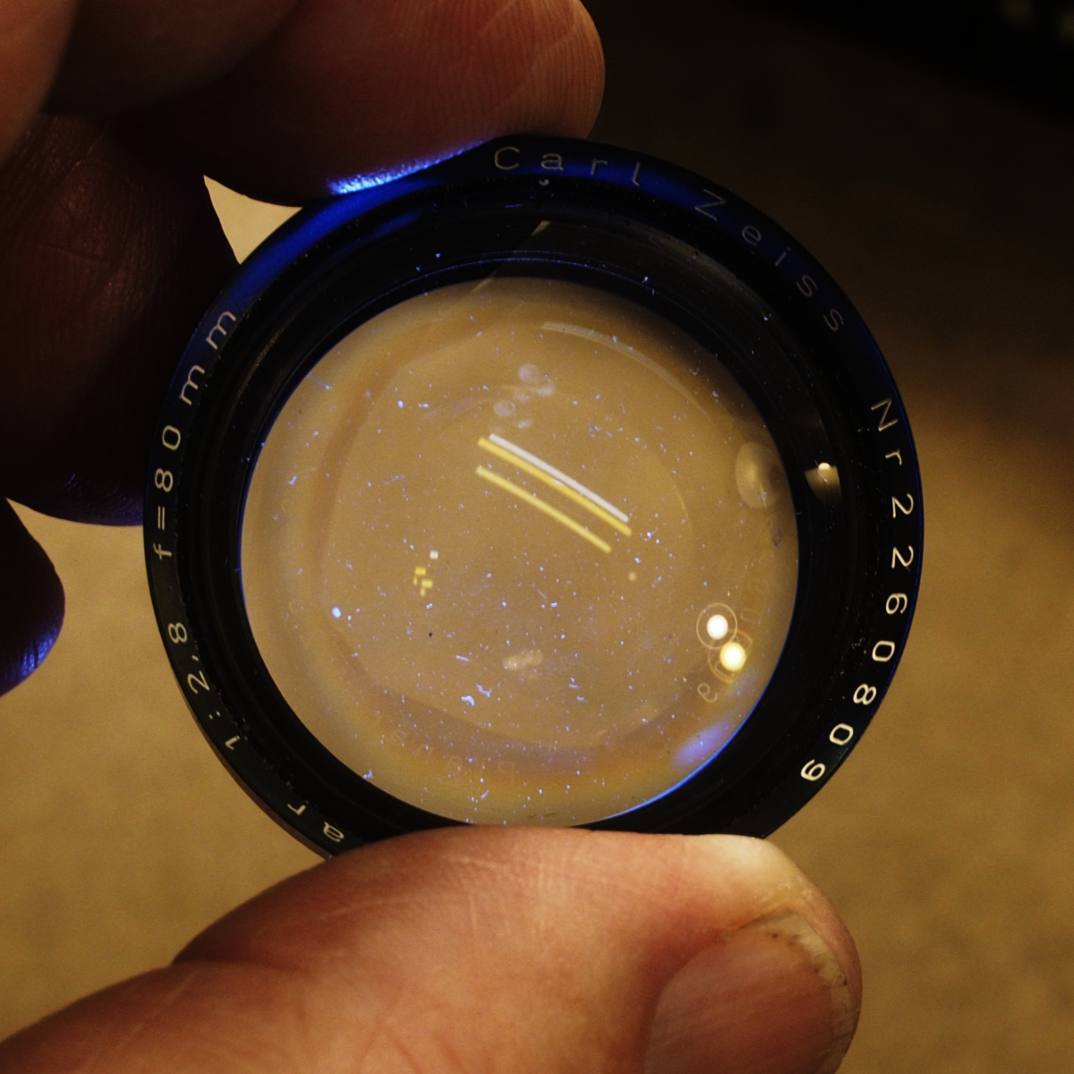

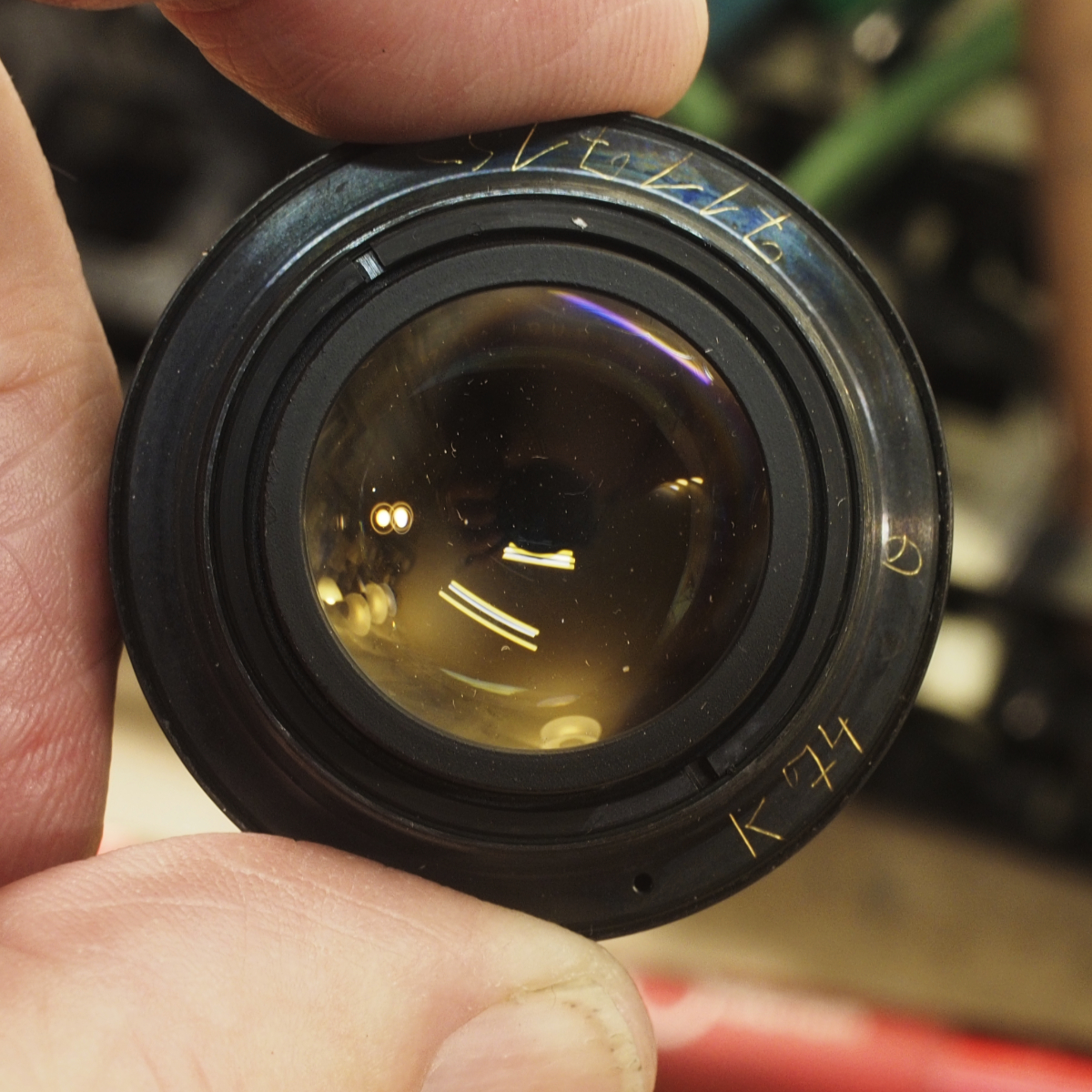

Just ran across a Rolleiflex 2.8E with the 80mm Planar. And noticed the separation. Sort of a ring of rainbow-ish effect maybe -1/3 in diameter wise? Thoughts on how this might effect images? I am planning to test soon but ...
And I really yanked the image curve around in Photoshop to make the separation stand out in the first two shots. The 'plain' shot is no processing to give an idea of its 'natural' look.

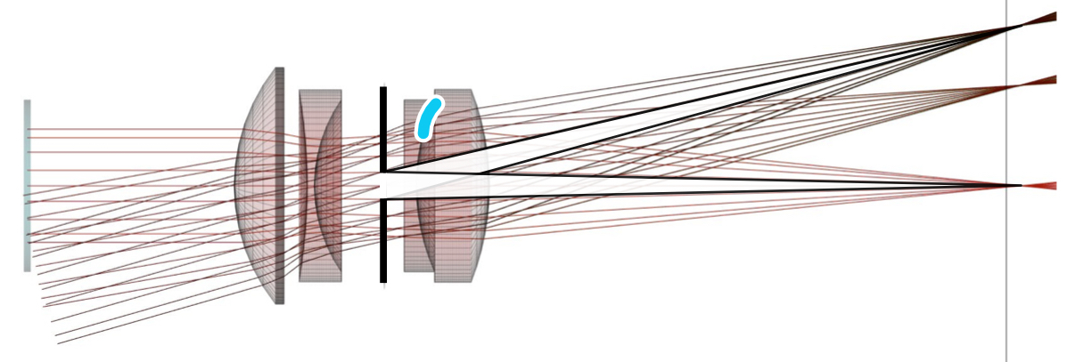

Depending on why one wants a 2.8 lens. One school of thought is that an advanced design (like Planar) provides the best possible wide-open performance. In that case the wide-open performance will be compromised by the edge separation.
The other school of thought is that for the best absolute lens performance, one would be stopping down to about f11. In that case (as demonstrated in the ray trace below) the effects of lens damage at the perimeter of the glued elements is minimized or even totally avoided.
Image below is a Tessar with its single glued pair, not Planar, but the principle is the same.

Hmm. Since the lens is pre-WWII and uncoated, parasitic light from internal reflections will probably be a larger problem.
Mark J
Mar 23, 2023
438
Denbigh, North Wales UK
It's quite localised. Is it aligned towards a corner of the frame ? ( those rays come through closer to the lens edge )
if not, you might get away with no effect. Otherwise it'll have a slight effect at the wider apertures.
OAPOli
Sep 26, 2022
684
Toronto
The rainbow pattern indicates a minute air gap in the cemented pair. E.g. tf you see purple, the gap is the size of the green wavelength (~500nm). Red and blue are reflected on the two new surfaces between the air gap (making purple) while the green reflections are removed via interference.
In general I think separation doesn't affect sharpness due to the gap being too small. But I think there will be more internal reflections leading to flare. This can be mitigated by stopping down when the separation is at the periphery.
