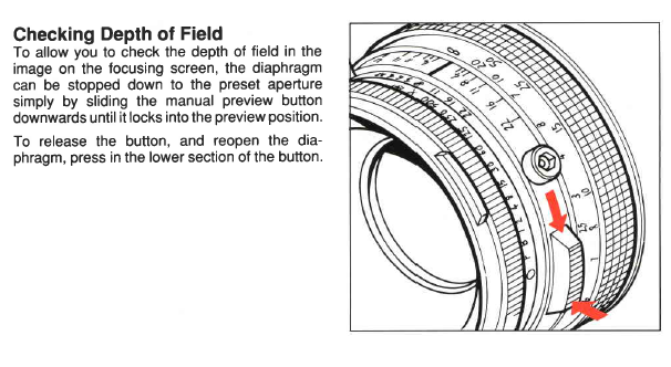

You have accidentally engaged the preview button and left it in the preview mode. That makes the lens stop down. See the attached information.

Thank you Sirius for quick response. I did not touch preview button. F-stop was set to 22 and after the MLU was pushed the leafs had closed not to f22 position but to ~F8 and than was closed to F22 only after pushing exposure button.
Your pic is about CF.
