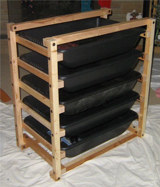

Lately I have been building some things with the 'gridbeam' system, nominal 2x2 inch stock with holes drilled through at intervals equal to 1/2 the actual material thickness (3/4" for nominal 2x2" stock). You can use metric simply by getting square stock and then spacing holes at half the stock thickness. Gridbeam 'sticks' are then connected through the holes with 'joint connector bolts', and wherever three sticks in x, y, z planes join together, the connections become self-squaring and rigid. You can also put casters in the holes, put a skin of thin ply or angled pieces to make it even more rigid, or do a lot of other tricks. The real advantage of this system is that it's like an adult Erector or Meccano set that can be easily taken apart and adjusted or rebuilt into a different configuration as your needs change.
Google 'gridbeam'. There's a book out that's pretty good for ideas.
A drill press is helpful when making the gridbeams, but a hand drill and patience will suffice. Sometimes I only drill the holes necessary for a given plan, and drill other holes at the proper spacing as needed. I'll attach a photo of some darkroom drawers I built with only the necessary holes drilled. You could do something similar and use the drawer supports as shelf supports, with the enlarger attached to an appropriate board at the top, giving you the adjustable drop table shown in some of the other plans linked to in other posts. It would also give you storage space below the enlarger.
Lee
