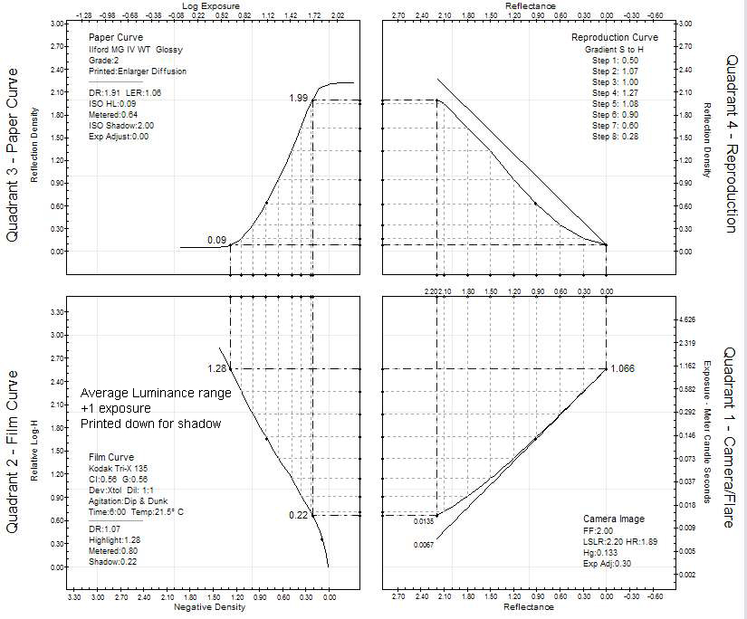

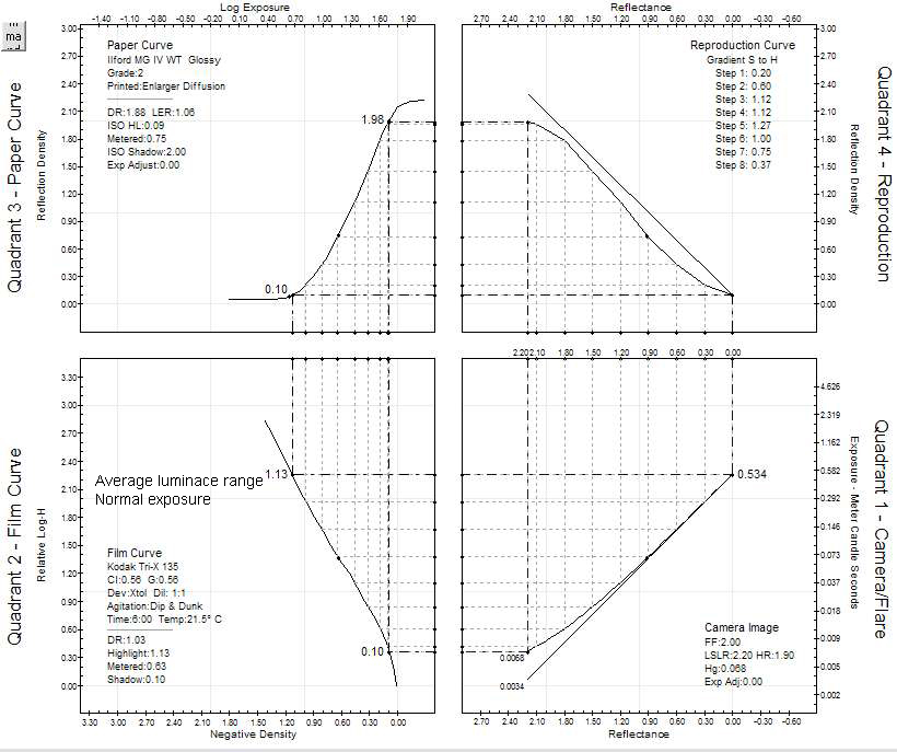

If I understand the example of the art's fair correctly, it should be more about contrast than exposure placement. The effect you describe can just as easily be accomplished by exposing well and printing down.

The windmill diagrams you provided earlier seem to bear this out too. The +1 diagram shows a more pronounced/longer curve toe in the reproduction quadrant.
