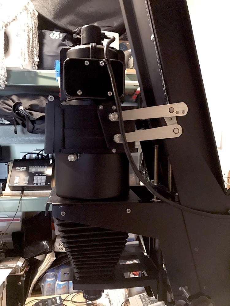

Could anyone please guide me to the place ( besides Ebay, Craigslist) or person who would have a 4.5 inch "arm" for the Omega D-5 Enlarger. This arm holds the bracket, that holds the head. I need a newish one.

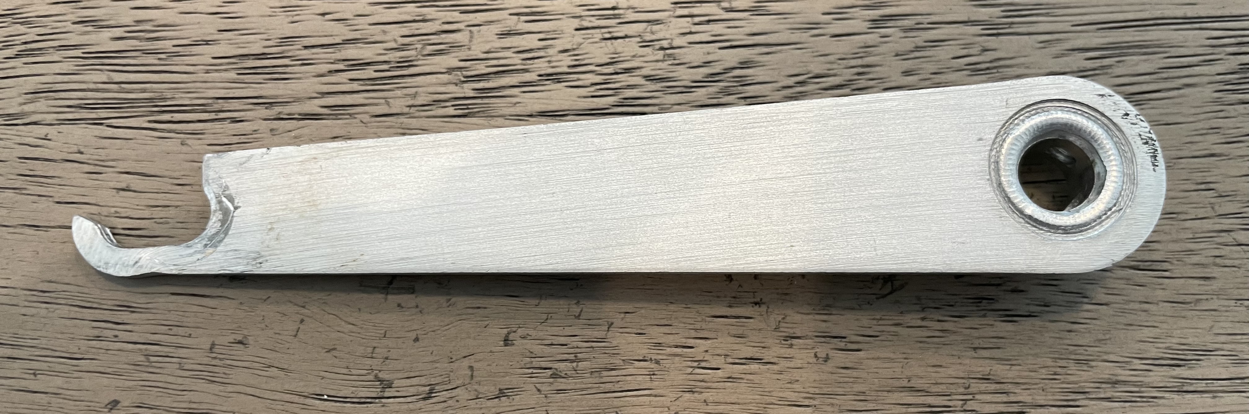

Looking at your original post with the photo of the broken part, would it be possible to weld the parts back together? I am not a metallurgist so I don't know what can be done with what I assume to be aluminum, but you might want to check in with a metal working shop (auto body shop?) and see if they can arc-weld the parts back together. I don't think the arm is part of a precision assembly so that may be OK. On the other hand, I could be totally wrong.
I just took a look at my D5 and it looks like a very simple part to make from a piece of aluminum bar like they sell at Home Depot. Just (gradually) drill a couple of holes in the ends, it wouldn't have to taper like the original, JB Weld the sleeve into one end. Might be worth a try.

right on Pieter 12, I order some flat bar stock from Mcmaster Carr, A Tap . and set screws. should be good to go very quickly. It;s not hard to do at all. I'll send pic's when im done. cheers.

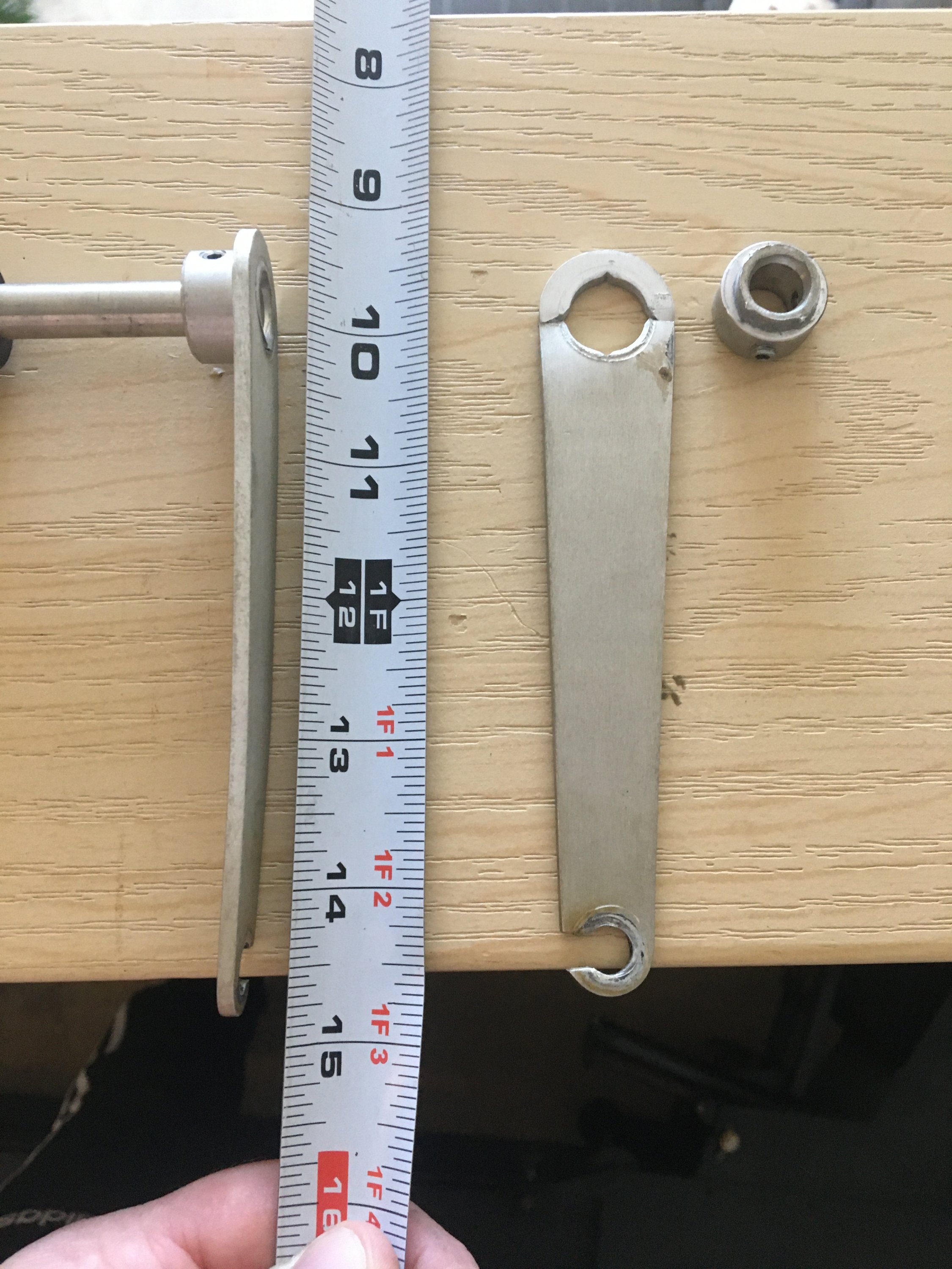

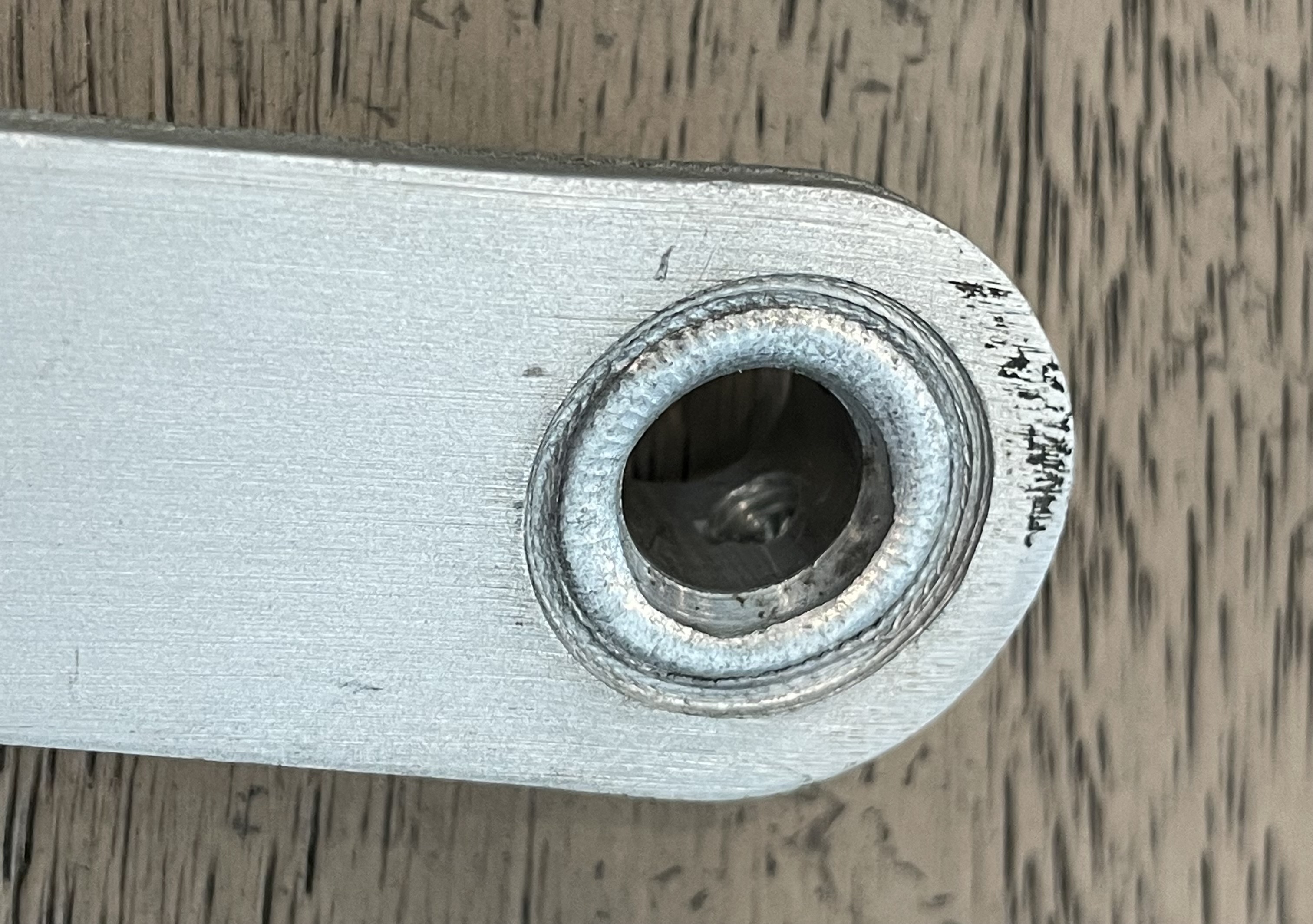

Hey Greg- I'm in a similar spot as you were last year and I think I'm going to go the way Pieter12 said with some stock aluminum to replace my arms. I've got a question if you don't mind (since you had some hands-on experience with this recently). How'd you manage to separate the flat bar from the bit with the set screws? I can tell on mine that it's two separate parts, but it looks more like it was welded than friction fit IMG-3046.jpg IMG-3045.jpg

That certainly seems to be the path I'm going to end up going down. The arm will be (should be?) easy enough to fabricate. At this point, I think the hardest part is going to be figuring out how to remove the bearing/shaft collar without damaging it, as that's not a part I can easily make, since it would require both a thread tapper and a lathe (the latter of which I don't have or have access to).
