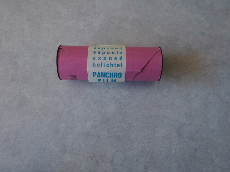

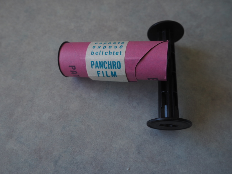

Does anyone have any experience with this (found) 620 film, and can they identify it?
Any suggestions as to developing times?

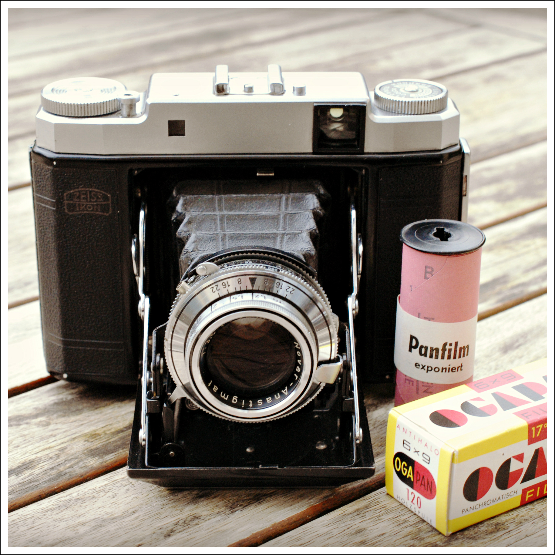

I found several rolls in my father-in-law's house - alll were exposed, some in -probably- original package. I don't process those.
Package says OGAPAN Panchromatisch / Panchromatique Antihalo 40 ASA Film - Holzspule ( = wooden spool) OGA Germany Obergassner, KG München.
Exp.date is June 1975.
AgX
Apr 5, 2007
29,973
Germany
To avoid misunderstandings:
Obergassner was no manufacturer but a retailer/wholesaler, who got manufacturers to brand their products as OGA for him. Ogapan films were back once were stated to have been made in the USA. (But other sources are possible too.)

a lot of the brands used in the 60s used Pink paper. since no brand is shown, I wonder if it is something like 3m Dynapan, (made by ferrania) Agfa also used a pink paper.

As I recall, many films used pink tails for panchromatic films and green tails for ortho films when the pan films first came out.

Any thoughts about the significance of the fact that the word "exposed" is printed in the four languages that are used?
Yes, it means the film was exposed. Sorry. It suggests to me the film was "continental" in origin rather than the USA or England, more than that? Who knows? Private label, medium speed.

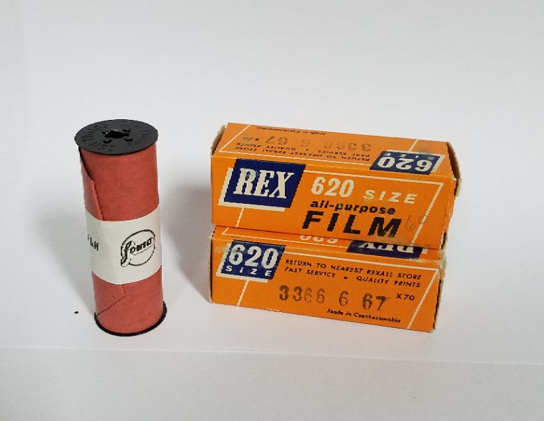

gordrob
Jan 29, 2005
1,009
Western Cana

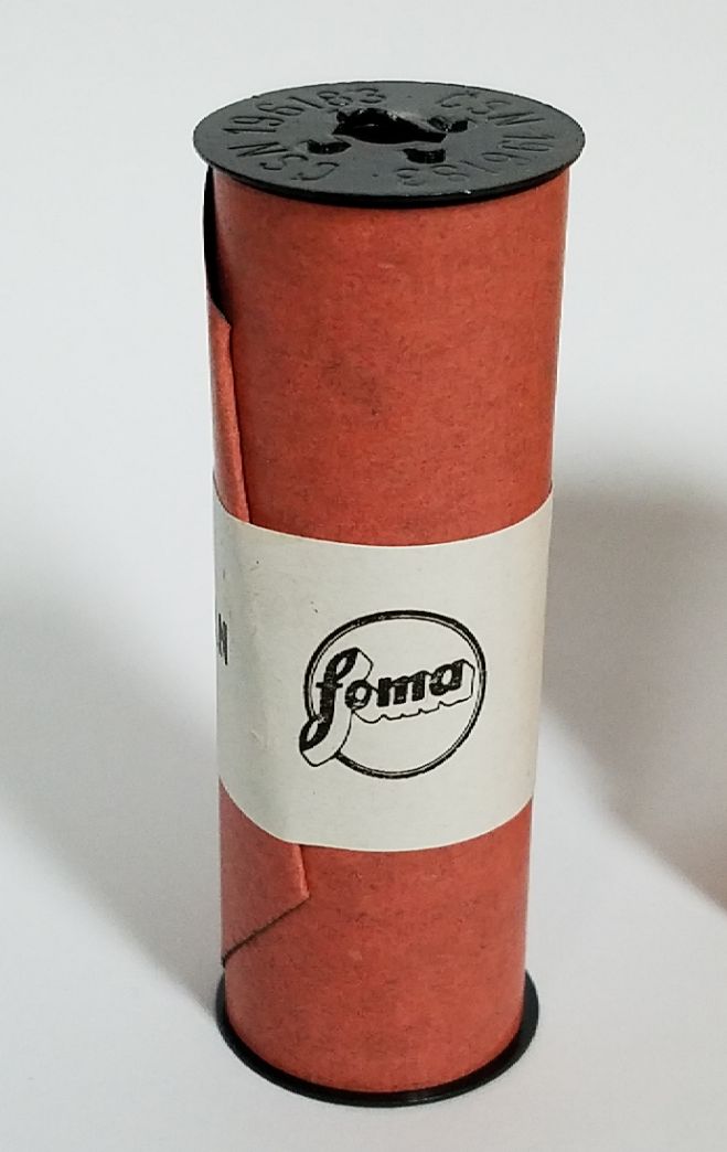

I found these two boxes of 620 film at the back of the fridge. REX for Rexall Drugs here in Canada. Made by Foma as the house brand of film for Rexall. The film came hand wrapped in tin foil.
Dated June of 1967. Instruction sheets are printed in Czechoslovakia.

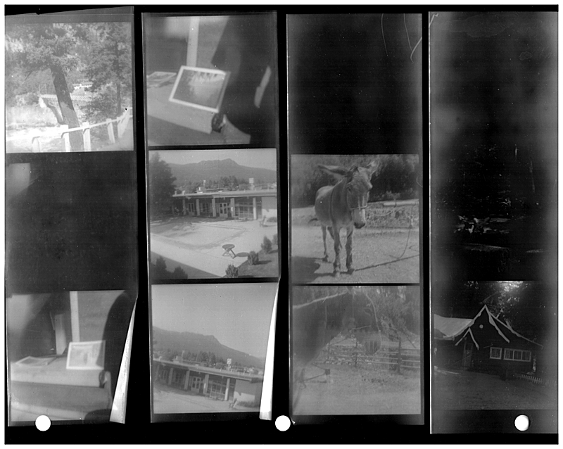

So we have a result.
I developed the film in replenished X-Tol along with my second to last 120 roll of Kodak Plus-X.
The Plus-X was exposed in flat lighting, so I bumped up my usual developing time by about 2/3 of a grade.
After loading the reel into the tank I examined the backing paper. Other than the frame numbers, the only additional information printed thereon was the words, in English, "START" and "EXPOSED".

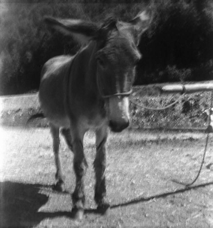

There is no edge printing or numbers on the film, there is a fair bit of fog, and there are images too!
The negatives are also extremely curled, and that really gets in the way of both making a contact proof sheet and scanning the individual negatives. In a couple of cases, the edges of the negatives will not flatten out!
Here is one negative scan, and a scan of the contact proof sheet. Both have been adjusted digitally to increase visibility:
