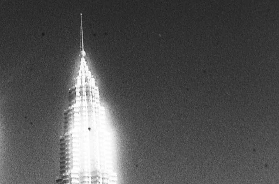

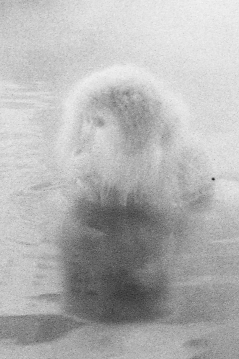

Also, one of the rolls (the one with the least amount of fogging) seems to have what I think are pinholes -- the film is clear right through each of the holes, which occur over the entire film, including the rebate. Some frames have quite a few holes, others just one or two, and some not at all. Developed in D-76, with stop and fix as usual. I've developed over 30 rolls this way and have never had a problem before, but I'm wondering what could have caused it since the other two rolls developed at the same time don't exhibit this problem. Is it age of the film (exp. 2009)? Too long to have waited to develop it? The heat of SE Asia for a couple of weeks? Too many passes in the carry-on scanners at the airport? Cosmic radiation? Bad luck?
I know it's easily fixed in photoshop, but is there any way that I might be able to print these negs traditionally to get rid of these unsightly black spots?
Snow monkey pinhole.jpg Snow monkey crop HIE-pinholes.jpg Kuala Lumpur crop

Pinholes were a common problem with HIE. I had it on one occasion. It's been so long since I've processed any that I don't remember offhand what the problem/solution might be, but I seem to remember that tight temperature controls and a more dilute stop bath or water stop bath might help.
Peter Gomena
Infrared film is very fog-prone, that's just part of life. That's why they recommend always keeping it at cool temperature.
For the pin holes, I had that problem occasionally with various films, and I tracked it down to the fixer going bad. I would mix 2L of working strength fixer and use that over several months. Apparently it's not a good idea. By switching to fresh mixing of the fixer I eliminated most of the pin holes.
However, in your case I think the problem is just weak old emulsion on the HIE film. I would switch to a very weak acid or preferably water stop bath and an alkaline or near neutral fixer like TF4 or TF5.

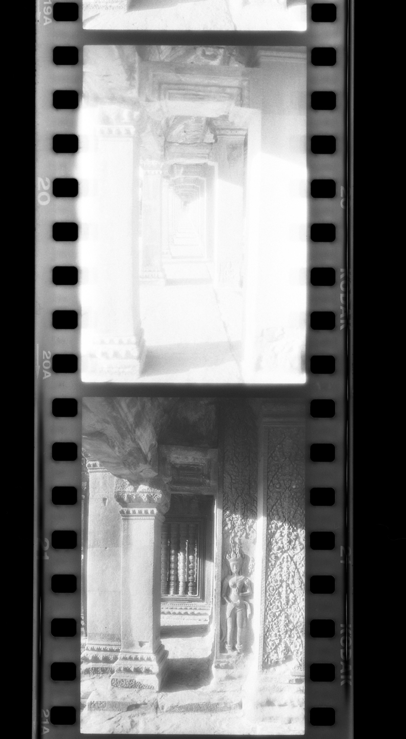

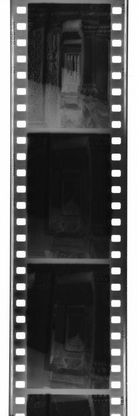

Alright, just to clarify (and for posterity's sake, in case others have a similar issue), here are a couple of scans of the fogging that I've experienced with HIE. This roll (taken at Angkor Wat in Cambodia) was the worst of the three, but I do have others from other trips in the last two years that look similar.
HIE fogging_negative.jpg the negative strip HIE-fogging_positive.jpg the positive strip
No pinholes here but definite fogging. But still printable I think.
EDIT: looking at the close-up of the positive it makes me think that the excessive light light in on the neg has affected everything around it. With few exceptions I always use a red 25 filter (and I definitely did in this example), but obviously bracketed because I wasn't sure of the light (it wasn't as bright as it appears in the negs!). Could it be a camera issue?
Rachelle, looking at your negative strip I can see that the fogging has extended right out to the edges of the film. As a user of HIE I have encountered fogging from time to time but not to this extent. Two possibilities occur to me 1. You could be right about it been a camera issue or 2. If your exposure was a long one, the light may have spread throughout the portion of film being exposed. If you have any shots taken out in the open you could compare them.
As regards the pinholes I think that this can occur in HIE, I know that it has happened to me from time to time. But I have never seen it to the extent that it has occurred on your second negative.
Since my film is way past its 'use by date' I nowadays shoot in hope that everything will be okay. But I can understand your frustration to have travelled so far and come back with a ruined film.
