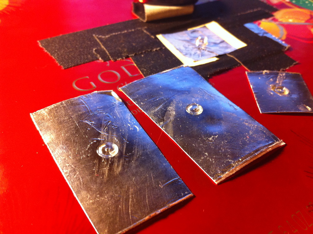

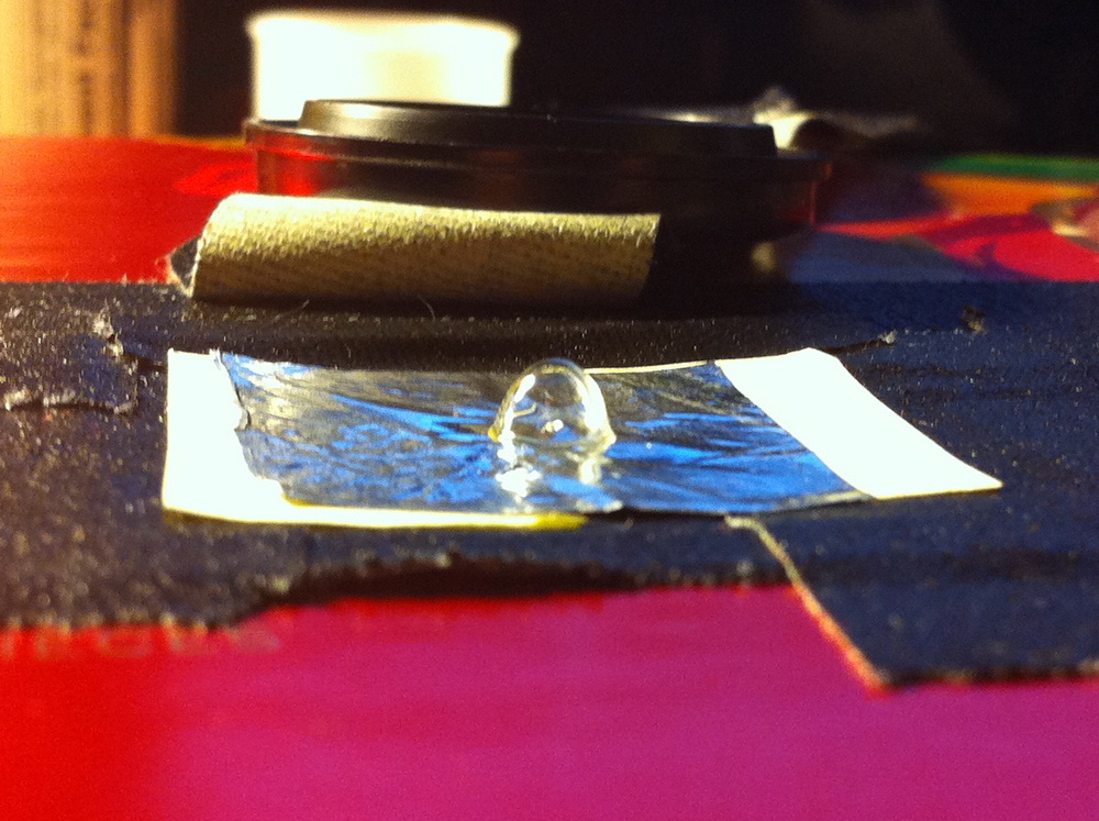

This has been a bit tricky, well I tried super glue, but it was way too runny, the liquidity of it caused it to not form a high meniscus. The epoxy I am using is branded Duco Cement and it dries very clear.
The problem is that when the droplets are drying they collapse and shrink down. I have had the most success with forming a bubble within the epoxy which acts as a support for the material to dry on and take shape. Also suspending it upside down helped it dry into a better shape as well.
I have been trying to get some exposures indoors, and flashing a test subject with a strobe, and leaving it sitting on a chair for awhile but I am not getting anything close to usable. I think the focus is off. They are 5mm wide, and 2-2.5mm high, I think the correct terminology is plano convex for the lens shape. The box back/paper/film surface is 4cm away from pinhole.
Sorry for the images I didnt want to setup the macro lens and tube for these 2 shots. I'll have to try in daylight tomorrow if I have time.

I will have to check for different brands of superglue next time I'm in the store. I did get to play around with the camera and lenses today at around the same time and lighting conditions.
The lenses that dried to the bubble shape did work. I had to go back with a needle and pierce the hole again as a tiny film of glue covered it. So I had to be careful to not pierce the lens when doing it.
The results? Well not amazing lol. I have used the same size pinhole for all of them, using the same needle. The standard pinhole image fills a 5x7 image area almost fully. The one with my bubble epoxy lens, makes an image circle a little smaller than half that size. All are kinda fuzzy, I think thats more me than the hole, or lens, as the box is a cardboard chocolate box, with a film canister cap for a lens.

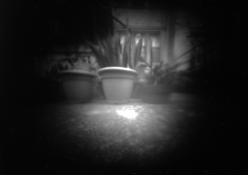

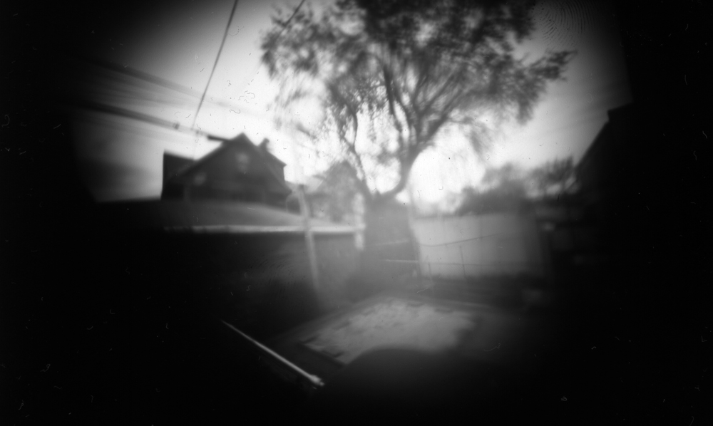

Here are the results:
1st Standard Pinhole for baseline.
2nd Close up Performance with Epoxy Lens
3rd Subject at Infinity with Epoxy Lens
As you can see there is a fair amount of softness. There are probably a bit to many variables to really say whats causing it, the stability of the box, the edges of the pinhole, the size and curvature of the epoxy bubble, the light transmission properties of the epoxy, and user induced movement when opening can closing the lens cover. All I can say for sure is that the epoxy lens makes a smaller image circle within a similarly sized box than a standard pinhole.
I think it was a interesting experiment, and future experimentation should be looked at though different materials such a other brands of clear epoxy or superglue.
