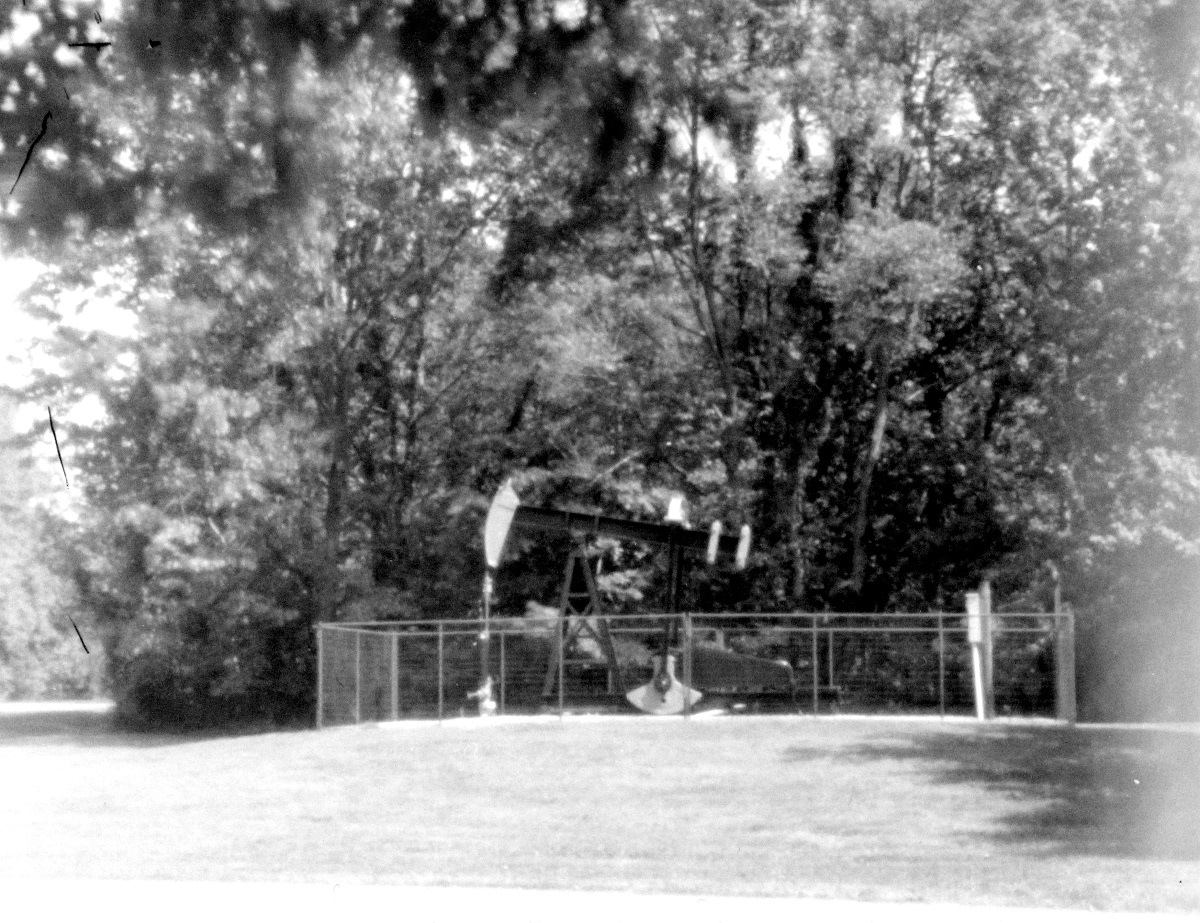

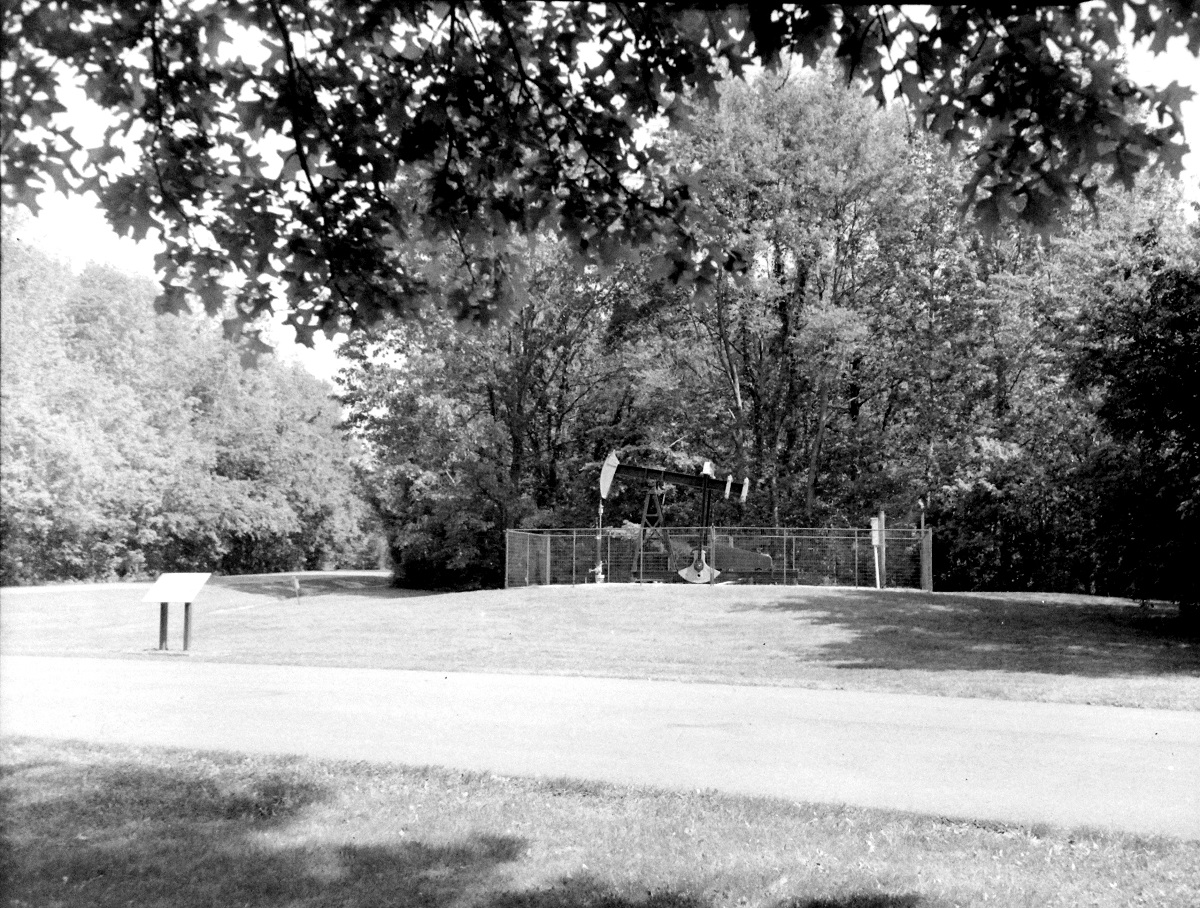

When taking a pinhole picture I have always wondered how much of the scene am I capturing? So, while setting up some experiments with my pinhole and view camera I noted the following results for an f 256 and f 500 pinhole setup.
The subject was an old oil well pump exhibit at the State Park on a sunny day with light winds. My reference photo was taken with a tripod mounted 4"x 5" cut film view camera, using a 127 mm lens. The distance to the pump was approximately 100 ft (30 meters). All these photos are uncropped, full frame 4x5.
Reference photo....... 127 mm lens at 30 meters.
Next, the lens was replaced with a .46 mm (.018") pinhole and the bellows extended to 117 mm (4.6") giving me a f 256 aperture. The image projected by the pinhole onto the 4x5 film has about the same field of view as the 127 mm lens. There does seem to be some vignetting of the leaves directly above the camera.
f 256 Aperture at 7 sec. with 200 ISO film.
Next the bellows were extended to 228 mm (9.0") with the same pinhole making an f 500 aperture. As you can see, with the pinhole projection being spread out over a larger circle, the 4x5 film captures far less of the total image. This gives a mock-telephoto image. Also, the smaller aperture does improve the sharpness. However the vignetting also appears to increase.
f 500 Aperture at 30 sec. with 200 ISO film.

The focal length of the pinhole is simply the distance to the film; it is a zoom not a telephoto.

That being said, thanks for the illustrations of field of view. That field of view is, of course, entirely determined by the size of the film (or sensor) and the physical distance between the pinhole and the film (aka the focal length). The size of the pinhole doesn't affect the field of view.

Your summery is spot on "That field of view is, of course, entirely determined by the size of the film (or sensor) and the physical distance between the pinhole and the film (aka the focal length). The size of the pinhole doesn't affect the field of view."
If I recall properly, I calculated a 2 f stop focal length change based on my .018" pinhole. I wanted to see the difference in sharpness of the photo. Since the projection is independent of pinhole size, I am curious how much larger the projected image would be at the longer focal length?
As large as your film.
If you had 8x10 film the same distance from the pinhole, the image would have filled that as well. The size of any element in the scene will be the same on either film - its just that the 8x10 film will have a lot more of the scene outside of the edges of what shows on the 4x5 film - you would see more of the park than what you see on the 4x5.
All subject of course to the limitations of any physical vignetting, as well as cosign falloff of light intensity.
The "magnification" - the ratio between the size of the subject and the size of the image on the film - is purely a function of the focal length.
