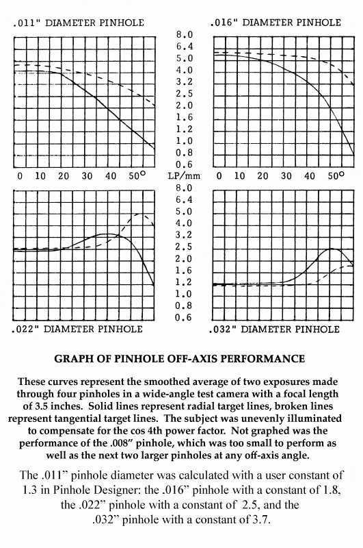

I sometimes use Pinhole Designer (a free download) with a user constant of 1.5 for determining pinhole diameter for maximum on-axis resolution. My tests confirm that there is a rather sharp increase in resolution at the point where the diffraction and geometric resolution curves intersect. A slightly larger pinhole improves off-axis resolution with a loss of on-axis resolution. This may be desirable in some pinhole photography. The below charts graphically show the effect of increasing pinhole diameter. I donated the improvised camera to Eric Renner at Pinhole Resource many years ago, and don't intend to refine the off-axis test. It would be much easier to refine the on-axis tests with today's digital cameras. Maybe someday . . .

Jim thanks, so it looks like the best one could get res. wise was about 5.5+ lp/mm correct? Which is about as close to what I observed, wonder if it can get much better as some users on this site and others show images that look as if they achieve higher resolution in their work.

The highest resolution in my example above was indeed about 5.5 lp/mm on-axis with the 3.5 inch focal length. Changing the focal length changes the optimum pinhole diameter and thus changes the resolution. A contact print from a short focal length pinhole camera can appear quite sharp at normal viewing distances, but we tend to look at such small images at a closer distance. An image from a long focal length pinhole can look quite sharp if viewed from the distance which provides correct perspective. One way to predict this is to look at the actual backlit pinhole at a distance equal to the image viewing distance. If the pinhole appears to be a disk, the image probably won't appear to be sharp. The longest pinhole focal length I've used was about 24 feet for a solar eclipse. The negatives were dismally unsharp at arm's length, but sharp enough at a viewing distance of many feet.
Sharpness can be clinically measured with resolution charts, but other subject matter imposes other standards of sharpness. A subject that is more shape and shadow than detail may not require nearly the resolution that a subject with much fine detail does. Image size and personal preferences are even more important in determining the required sharpness.

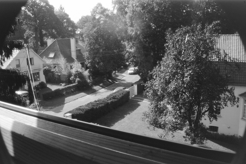

Agfa Clack with f245 0.37mm
Thanks Jim. Here is a sample of a Pinhole image I find on the neg needs higher resolution but after putting it through digital mechanics the details are not bad but the grain gets amplified too.
As in the true tradition of experimental photography an image of our street from the attic.

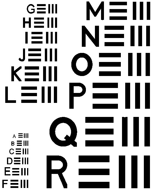

I googled for a quality download of the USAF 1951 reslution test chart, but only found small or jpg files. This gif chart, small enough to post here, can be replicated to assemble a large chart for comparative testing of pinhole images. Print it without resizing to prevent introducing artifacts. The finest bars will not print perfectly due to dot spread. Actual line pairs per mm can be calculated. This was not included, as it would restrict the versatility of the chart. Feel free to post or publish it elsewhere. This is the information age, and knowledge should be as free as practical.
