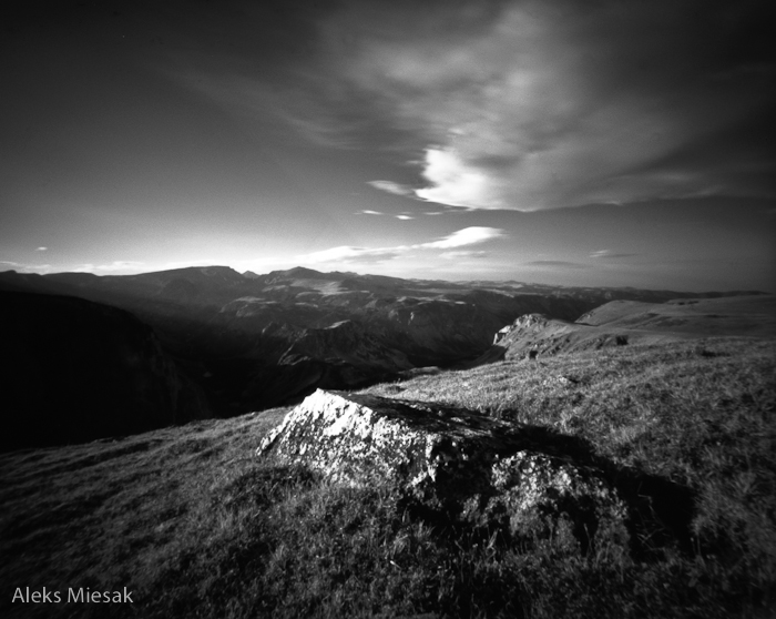

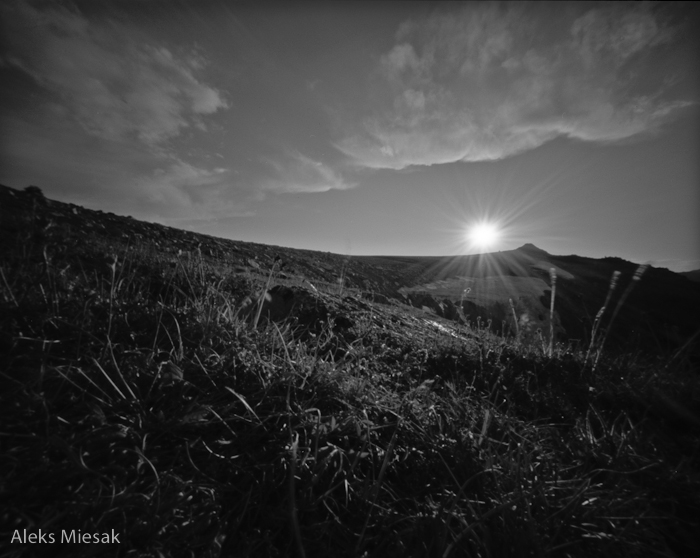

Thanks for the feedback everyone. I did use some Ilford positive paper when I first got my pinhole but had some difficult time with the learning curve and the sensitivity of the paper. I have found actual negative film to be a little easier to control with some pleasing results.
Here are two of my negs from that weekend of backpacking. I have a few more sheets to process but wanted to share these as they came out a little better then I expected. These are scans that have been processed a bit in LightRoom to get close to what I would like them to look like when I get a chance to print them.

Those two images are ust as I would expect from a Zero Image pinhole camera — primal beauty with a nod to the photographer's perceptual and visual arrangement. Neato! :smile:

Alex, they both came out well. They look great. Did you do filtering, and if so, what was it?
I know the sun star shot was shot without any filters. I am not sure about the other one. I should have kept better notes but it was a little tough with this backpacking thing. I think once I have a chance to process the other sheets I might have something to compare the images with and would be able to figure out which ones were shot with filters (I hope...).
Thank you all for the kind words! :smile:
