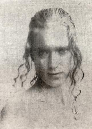

I have already done some tests with a higher ratio of paint vs gum/bichromate or painting several layers before exposing only once. That helps increasing the maximum density of the print, but I run into other problems. It gets difficult to clear all residue paint from the highlights and with each layer of paint, it gets more difficult to dry the paper completely flat. The issues I have with paper warp is perhaps more related to my improvised and mediocre printing frame, but I tend to experience blurry areas in the image, where I probably have air gaps between the paper and the negative. Depending on the motive, both slightly 'fogged' highlights and slightly blurred areas is not necessarily a problem, but it is of course difficult to get consistent prints and I currently have the impression, that it is just luck if I happen to get an acceptable print.
Here is one of the better prints I have managed to make (single layer, Windsor & Newton lamp black):

From your sample I see what I expect with single coat, I have heard lamp black is difficult but I get results.
