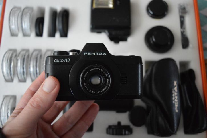

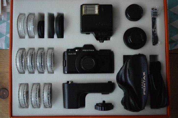

I'm going to pick up a Pentax Auto 110 set tomorrow. It looks like a small but fine camera and I never used one before.
Any tips on what to check to see if it's working?
For instance: will the shutter work without a film inside the camera? I know some cameras won't fire without film.
And I haven't got the time to get me a 110 film upfront.
BTW: I'll bring new batteries for the camera and the motorwind.

Those cameras are a LOT of fun, and take great pictures. I really like the lomography B&W Orca film.
I seem to recall that both the motor winder and the flash had problematic connections to the body, so make sure you try both. That said, I almost never used the motor base or the flash.
I don't remember if the camera needs film in it to release the shutter.

With fresh batteries you should see the meter LED in the viewfinder when you press the shutter button halfway. It will fire without a cartridge - two strokes of the advance lever should cock the shutter but one more will uncock it. You should feel the movement when it becomes cocked. I use mine with 16mm film rerolled into used cartridges. You get fewer frames and bigger gaps but it works OK.

I picked it up and the set is as new! I loaded the batteries and the camera works. Also the flash and the motorwind. It's a complete set in the original box. And what a neat camera it is - and tiny. The view finder is perfect for focussing.
I even got a free film with it so I'll be having fun this weekend. :smile:
