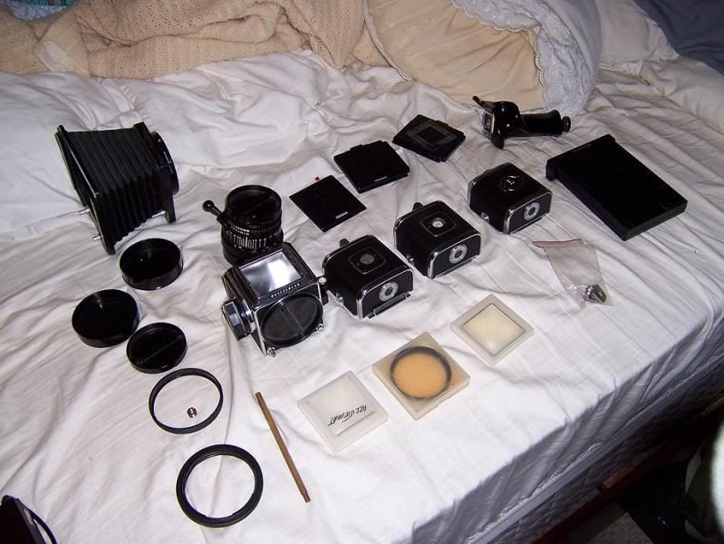

Here is the whole lot i picked up today,traded my olympus ep2 kit for it and i think i got an excellent deal.
500c/m,80mm lens,2 a12 backs,1 a24 back,a polaroid back,huge shade/belows,a close up hasselblad lens,an accumatte screen and 2 prism screens,both are split prisms but at different angles, a grip and some clips for a shoulder strap plus a few other caps.

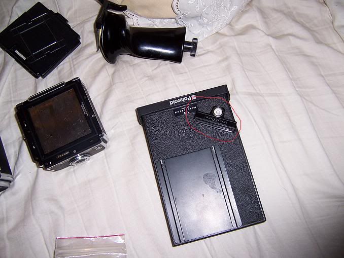

Nice little bubble level.

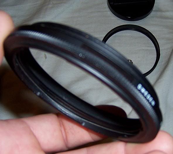

What is the contraption in the last pick,it mounts on the outer bayonet and seems threaded on the inside,maybe for screw in filters.Has a 60 with a circle and line through the circle on it and is made by hasselblad.
And last question is did i get a good trade,i think so even if priced at keh bargain i think the value is more than my ep2 which will depreciate rapidly and i did not like due to it's digital nature.
I do like this as it is so much lighter than my rz67 kit and i think i will keep the kit like this and not add other lenses to keep the weight down.Except maybe a 50mm as i want a 65mm for my rz but i feel the 50 on the hassie will serve me better than the 65 on the rz.Thanks.

the ring is an adapter as you suspected, Bay 60 to ? thread. Likely to be 58 or 62mm

A bit hard to tell on the last pic, but looks to be an adaptor for threaded filters. Probably for the series 63 filters used by the 50 and 60mm lenses.

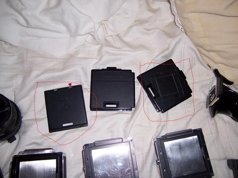

The circled rectangular items are covers for the rear of the body when no magazine is attached.
Useful if you have more bodies than backs, otherwise not so much.
I don't know what the value is of your Olympus kit, the Hasselblad kit is worth 550 USD +/- in cash, though the lack of a finder is a big minus.
Looks like a nice kit, hope you have fun with it.

Well i wanted 800 trade value so maybe i lost a little,I figured the kit to be worth at least 1000,oh well i am still happy with it.Yeah i hope he finds the finder.

I don't think you lost at all. That kit is worth a lot more than $550, according to KEH prices, especially with all the backs and accessories which can really add up quickly. The backs themselves run $100 - $150 each at KEH. You did well - have fun!

Anyone would have a hard time finding this outfit as shown for $550. olwick already gave a ballpark price for backs alone. Body (without seeing it closely) at least $400, probably more. 80mm, again without hand-holding it and knowing if it is a C or CF (quick focusing handle would say C), at least the same as the body. If the accute-matte screen is a D (two small D shaped notches in the surrounding frame) and in good shape, you could sell that alone for around $200-250. You got a good deal!
A waist level finder won't set you back much. If you prefer a prism on a budget, consider even a Kiev with built-in TTL meter (personally I find it becomes too heavy/bulky). You already got a pointer to the manuals. Read them closely. Be prepared for a few c*ck-ups. Always make sure camera is wound-up as ready for shooting before attepmpting to detach/attach lens or backs. If inadvertently or by operator error it does jam, don't force anything! Leave it and look for answers or service. What else?
Lenses...get used to the 80mm which is often overlooked as it was a "standard" kit lens but which is in fact an outstanding performer. And the camera and rest of equipment and its handling first. Especially framing and focusing, which takes some getting used to. OK, so what should be the next lens to get? It depends on your style of shooting, goes without saying almost, but here again, the 50mm is a great choice. Then there is the 150mm, or the 180, which are simply legendary as short tele's (portraits as well as other uses). Maybe an extension tube for close-ups to use with the 80mm already...for some serious fun. Oh, and I would get somekind of flash compatible with the kit. Indispensable for close-ups and fill-in work.

the ring is not an adapter
it is an attachment ring for the front bellows shade---it fits on the font of the lens and you attach the bellows with screws in the slot---you'll see---for the "proshade"--that's what you call the bellows thing
